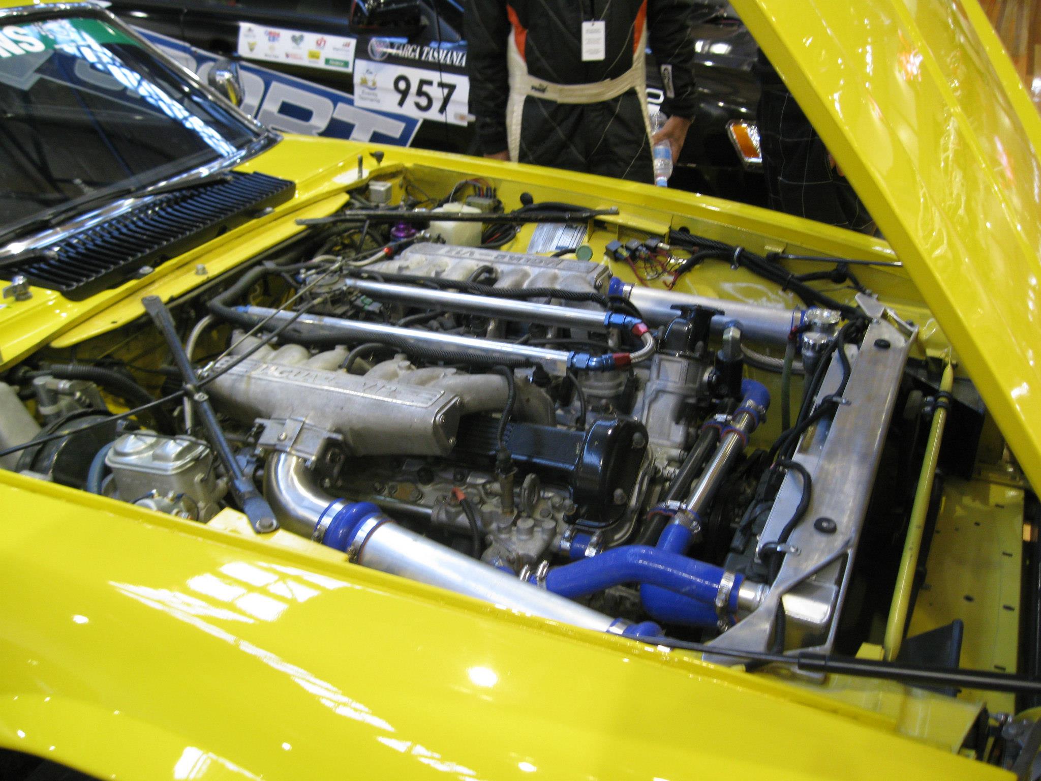

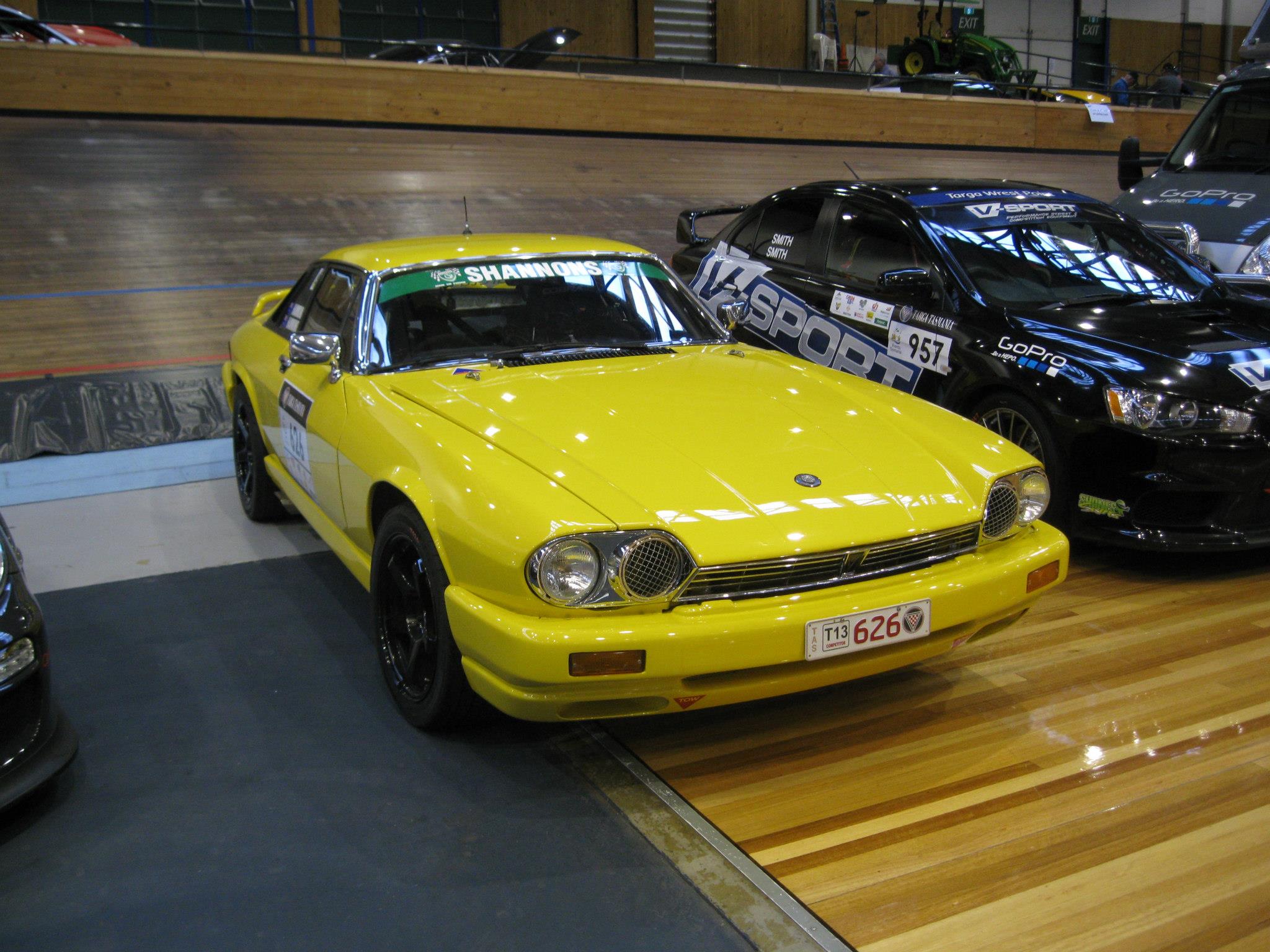

I'm trying to find out more about the car. I know that the driver/nav team is Mark Hammond, and, Gordon Lennox, both from New South Wales. The guy who posted the video, told me that they have $150,000 in the car.
It looks like all 12 cylinders exit just in front of the right rear tire (excellent location for those of you with RHD cars).
Here are some photos of the car:
2012 & 2013
Tuning XJS Exhaust Sound-913939_320694404724871_1814067429_o.jpgTuning XJS Exhaust Sound-457391_179966698797643_1962290014_o.jpg
Pay close attention to those intakes. They are specially cast Group A intakes, and the inside of the runners is HUGE. They flow 35.7% more CFM than stock
Tuning XJS Exhaust Sound-902019_320694564724855_1942275466_o.jpgTuning XJS Exhaust Sound-904861_320694494724862_1262644948_o.jpgTuning XJS Exhaust Sound-920134_320694558058189_371823246_o.jpg
2014
I guess 35.7% over stock wasn't good enough, because look at the setup they ran this year. This is where a lot of that great V12 sound in the video is coming from
Tuning XJS Exhaust Sound-980049_503071526487157_5383620906447358399_o.jpgTuning XJS Exhaust Sound-10255185_503071546487155_2180900445839594225_o.jpg

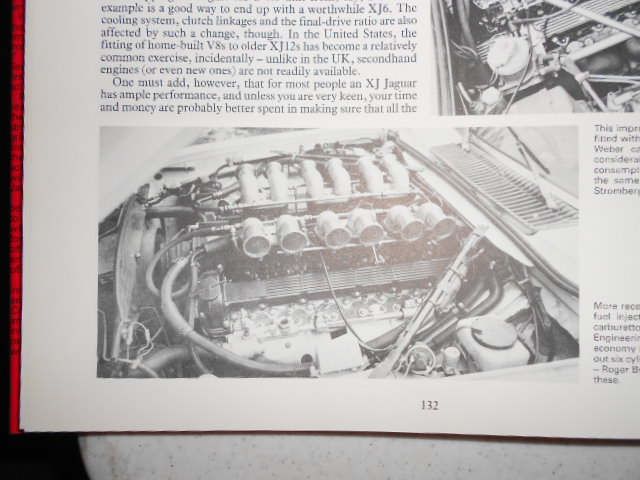

about the custom fabbed plenum, when in doubt about plenum sizes,(many formulas are available) it should be at least the equal internal volume as the engine bank displacement.
so for one bank Jag V12 5.3 volume should be 2.7 internal(6.0L 3L) on each bank.
being larger doesnt seem to any problem,except room to put it, internal trumpets good for N/A engines , tests say not so important for turbo-supercharged engines.
also most good plenums seem to be tapered toward the far end(some unusual science there)from the air inlet. he also went to 12 ITBs. lotsa money there,for the complete system!
and JagZ 1st pix must be AJ6 engineering stuff, couple more of close to same.
and a pic from Forward engineering inlet system. Roger Bywater.
Attached Thumbnails Tuning XJS Exhaust Sound-jag-intakes-assorted-005.jpg   Tuning XJS Exhaust Sound-jag-intakes-assorted-008.jpg   Tuning XJS Exhaust Sound-jag-intakes-assorted-001.jpg

Any imput on what he did to that motor other thwn the intake and I'm assuming a set of headers
Old Aug 9, 2014 | 04:27 PM
  #59
JagZilla's Avatar
Posts: 835
Likes: 298
From: Mississippi
Not sure what he has for mufflers, if any. However, most of what makes it sound so good is the crisp throttle response coupled with the resonance generated by those huge intakes and the 12-into-1 exhaust.
Part of the crisp throttle response partly comes from the individual throttle bodies, but, my guess is he's also spent a lot of money on making the rotating mass lighter, both inside the motor, and with things like an aluminum flywheel, and aluminum drive shaft.
