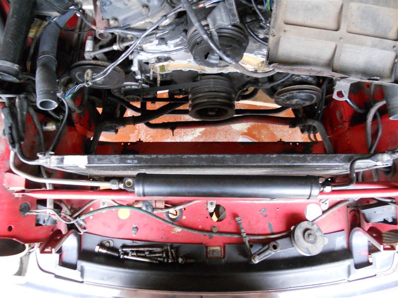

Originally Posted by M90power
the engine designation in my pontiac is L67. if youve got the same engine as me, then that should be the designation, provided its FWD. if its RWD, then the designation will be different. also the flywheel will be different.
Yes it is the L67 RWD here is pic off ebay. The engine mounts are different as well
VT VU VX WH L67 V6 SUPERCHARGED ECOTEC ENGINE COMPLETE | eBay
Here is a pic of the front of my engine during a radiator upgrade. This is something else you will need to do to ensure the V12 does not overheat due to age of Radiator.
The V12 is bulletproof but will drop valve seats if overheated too ofter or too much
