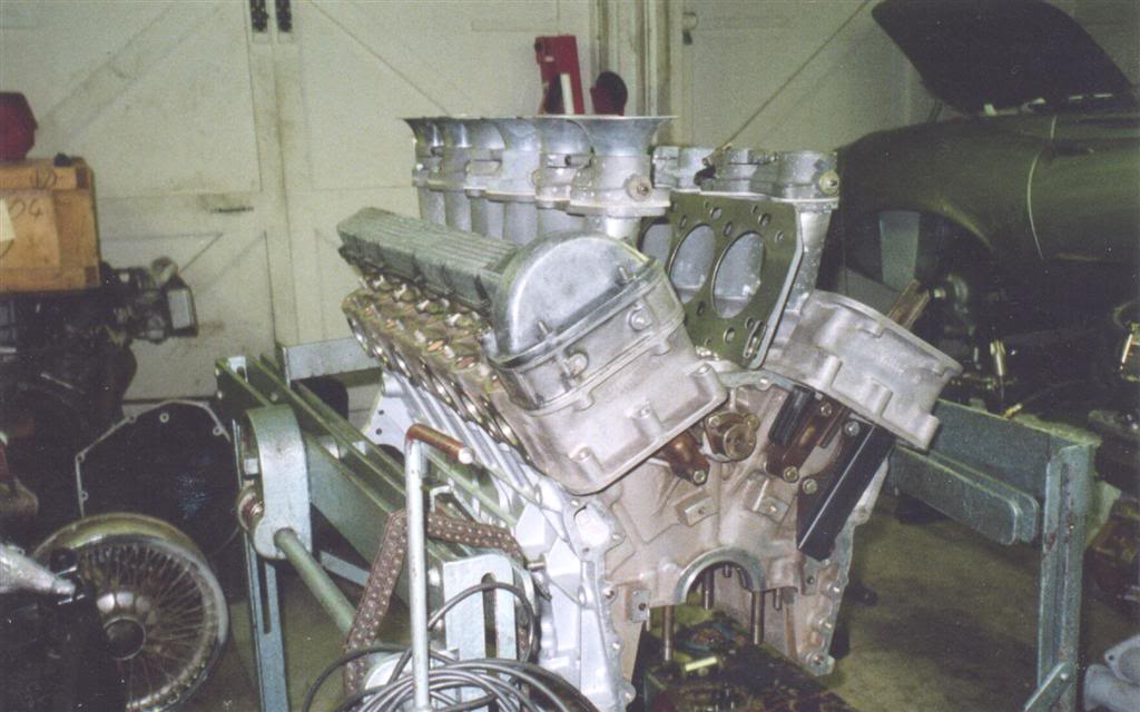

Here's a shot of the 6.1 lay-up, pre build. Nice thing about this is the modem telemetry - I can alter the mapping on track. Again installed in an E Type. 550bhp standard, 650bhp without issue.

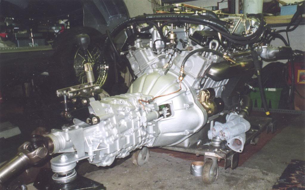

Final shot is of another V12 5.7 with custom installed deep case 5 speed, with an aluminium flywheel. Harvey Bailey torsion bars, Koni adjustable dampers, AP racing brakes, with custom Dayton SS wheels. Nothing really standard about what we did to these cars, including leather hood tonneu's, the list goes on, retro-development, in a little workshop somewhere....
