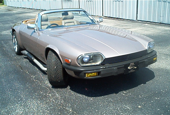

Default pic of my side exhaust V12
pix of car and the engine that makes all the sound ,all twelve cylinders exits out the drivers side, 5" outlet, just so i can here all 12, absolutly awesome,
at 7000RPM.
how do i attach a soundclip,and what recording device would i use??
im from 2-3 generations back compared to you guys!
Ron

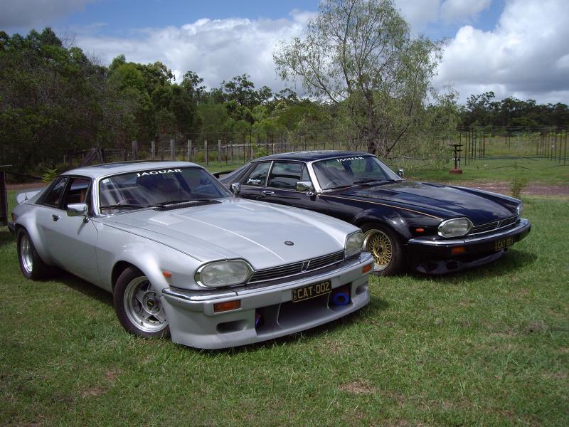

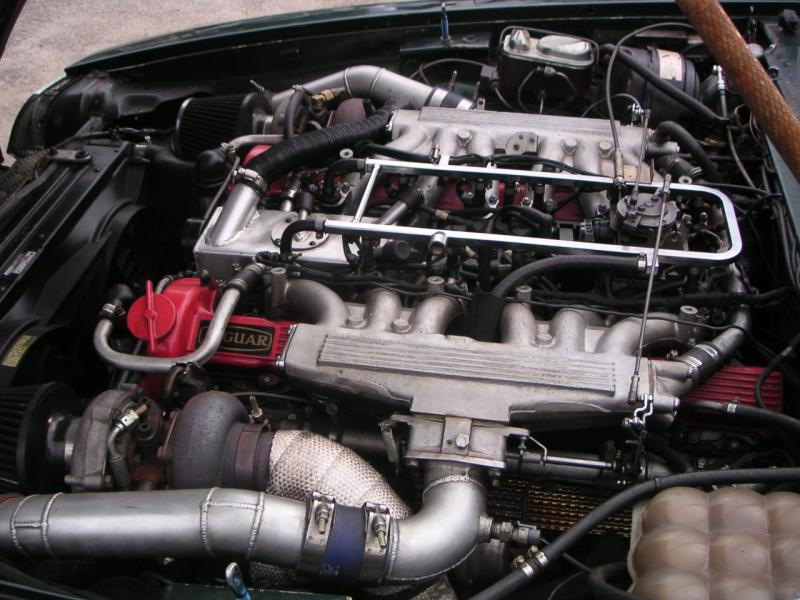

I had a request for some more pics of the TT XJS. I had a massive PC meltdown so I'll post what I have left. I did have some of the underneath - there were some good ideas on strengthening the LCA's but these are gone.
The black car was built by Gary Walker from a burnt out wreck and reported has +700hp I am not sure about the silver one although I do know it is TT as well.
That 609hp was with 300mm slicks wheels spinning on the dyno, this thing has unbelievable torque, and sounds awesome at full tilt.

Yeah I thought about it as I am going down the SC route - BUT the issues are:
3 different ignition systems
HE has too high compression so heads have to come off
ECU upgrades how to do this without going aftermarket

Disclaimer: I am not a mechanic by any stretch of the imagination, just a dude who likes to go fast. Could these issues be overcome at reasonable cost by:
1. part of the kit includes a universal ignition system upgrade (factory ignitions have well-known weaknesses), or upgrade your own ignition separately
2. does some type of 'plate' exist that sits between the decks and the cylinder heads that would reduce the compression ratio? Could one be manufactured?
3. wouldn't this type of work necessitate a full custom tune in any case?
Forgive me if these are basic questions, I genuinely do not know and am seeking enlightenment.

youd need a tune, a decompression plate or low comp pistons. something a little less drastic than flathead pistons for moderate power out of the boost, im assuming since the blocks are almost the same, that the ignition system could be universally upgraded, and then youd need an ECU tuned for the proper fuel files.

There are 3 different ignition systems on the XJS to deal with. The system could be upgraded to distributorless. Issues a) would require owner with ability to instal and tune or would need to be professionally installed -cost; b) No knock sensor in the V12 so tuning would need to be done on a dyno.
Yes a decompression plate can be used but the heads have to come off. The green TT I posted used this approach.
Yes - how do I tune the ECU?? and 2 different types
This could all be done using aftermarket ECU but this would add significantly to the cost. ECU alone $1k plus tuning.
