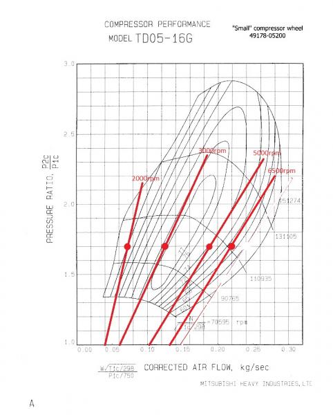

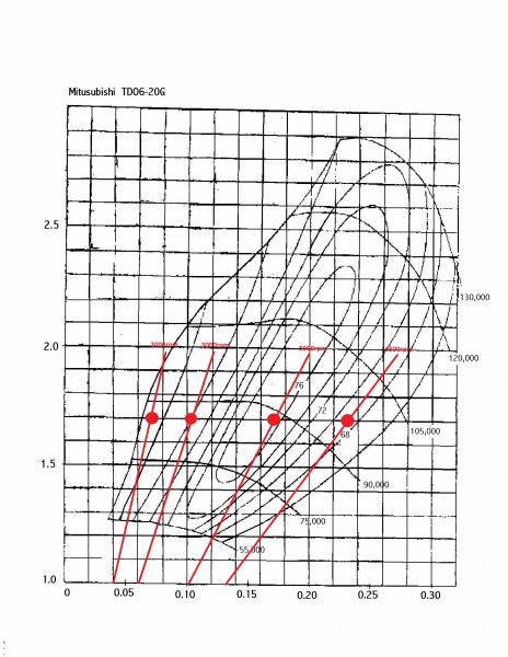

Ok to get this back on topic - I have calculated turbo maps for 2 Mitsubishi turbos both TD05's a 16G and 20G compressors.
Both would be a good match for the V12 in a twin setup, I don't know about the USA but these are readily available in Aus. They are a popular cheaper upgrade for the Subaru guys

Attached Thumbnails Twin Turbo V12 project.-16g-v12-mapped.jpg   Twin Turbo V12 project.-20g-v12.jpg

i'm not saying i know much about turbo systems, but i been doing turbo buildups, since 1983!
and i can just look at a turbo,holding it in my hands, and know how it will perform, on a particular engine, for a 4cyl, to a 12cyl.etc.
most guys go to big on sizing,thats fine if you are going ***** out racing, and lag/ spool is not a problem like leaving a stop light at 5000rpm, and not crusing around on a saturday , drive in.
in other words, are you building a race car,or a smooth street car.
OK that said ,my opinion, Mitsu. TD05/16G, two of them is to big, good maxed out 750hp, and two 20Gs its possible to make 1000hp,(course the engine aint gonna like that diet).
these heavy tanks(XJS) just wont accelerate fast enough to boost where its useable, like when you pull away or start to pass, not enough pressure, the other guy who is already making boost and torque is gone, finally your big *** puffer is coming on// tadah, you run out of road/or traffic is stacking up. been there done that.
but ONE 16G or a 20G, could be made to perform.
back a few yrs, it was very expensive to rebuild a Mitsu turbo, in comparison to a Garrett turbo!
plus mounting Garrett has far more options, many configurations, cheaper, and we are into modern ball bearing turbos, if you are to go for the project, might as well buy the best!
just my opinion, and how much money you spend!
ONE 16G? On a 5+ liter V12? 16G's are for 2.0 liter fourbangers.
