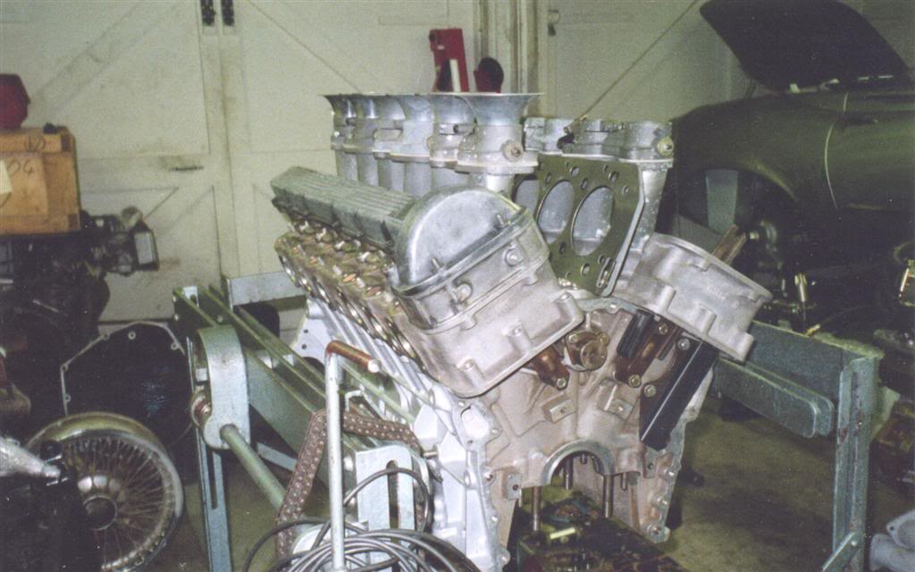

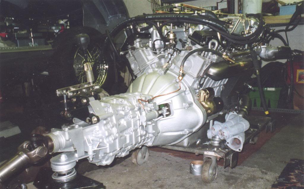

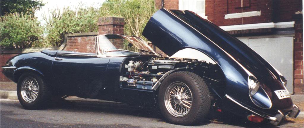

Originally Posted by Sean B
Sure Chris,
From memory it used flat heads, pre HE, with bigger valves.
Bigger displacement liners with Ford Transit van pistons to get us to 5.7lt
The throttle bodies machined out, with new spindles/butterflies.
The 16CU ECU went to AJ6 Engineering to cure a delay in throttle pedal response.
We also used 6.0lt injectors from a JaguarSport unit. Although another trick is to use two sets of AJ6 injectors.
A free flow s.s.exhaust, I think 2.5" straight through.
Maybe not a fair fight, but a friend showed up with a brand new XKR Silverstone, the only UK supplied car in Black, and it ate it for lunch, I'll always remember the supercharger whine fade into the background. A lighter car in the E Type, it walked away.
Here's a shot of the 6.1 lay-up, pre build. Nice thing about this is the modem telemetry - I can alter the mapping on track. Again installed in an E Type. 550bhp standard, 650bhp without issue.
Final shot is of another V12 5.7 with custom installed deep case 5 speed, with an aluminium flywheel. Harvey Bailey torsion bars, Koni adjustable dampers, AP racing brakes, with custom Dayton SS wheels. Nothing really standard about what we did to these cars, including leather hood tonneu's, the list goes on, retro-development, in a little workshop somewhere....
what bigger valves and seats did you use? im building a pre he motor myself with an 84 or 88mm crank. looking for about 450+ power to start
Attached Thumbnails Twin Turbo V12 project.-crop0041large.jpg   Twin Turbo V12 project.-crop0040large.jpg   Twin Turbo V12 project.-crop0042large.jpg
