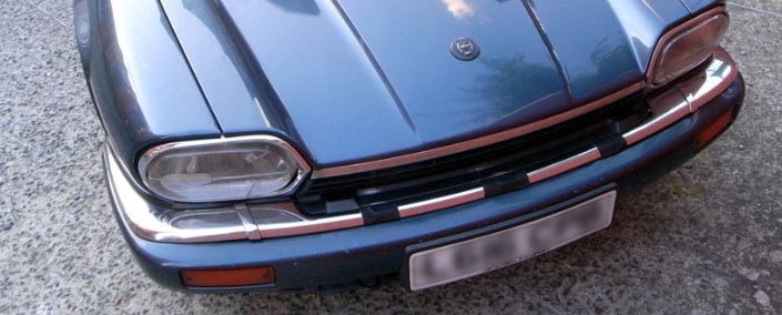

Hey Warren,
I will do that! I think it must look good, a bit like the facelift bumpers!
That is what I mean in the picture:
Old Jan 29, 2013 | 04:01 AM
warrjon's Avatar
Posts: 4,638
Likes: 2,583
From: Vic Australia
The chrome trim on the facelife is exactly that a trim, the chrome on the pre-facelift is not a trim but quite structural and bolts to skirt around the front of the car.
I have both my old bumper and the new TWR if you need pics.
The top of the chrome bumpers and the TWR bumpers are on the same level so you can not put the chrome on the top of the TWR bumper it will not fit under the lights and the bonnet would not open.
You could replace the bumpers with facelift, this will work.
