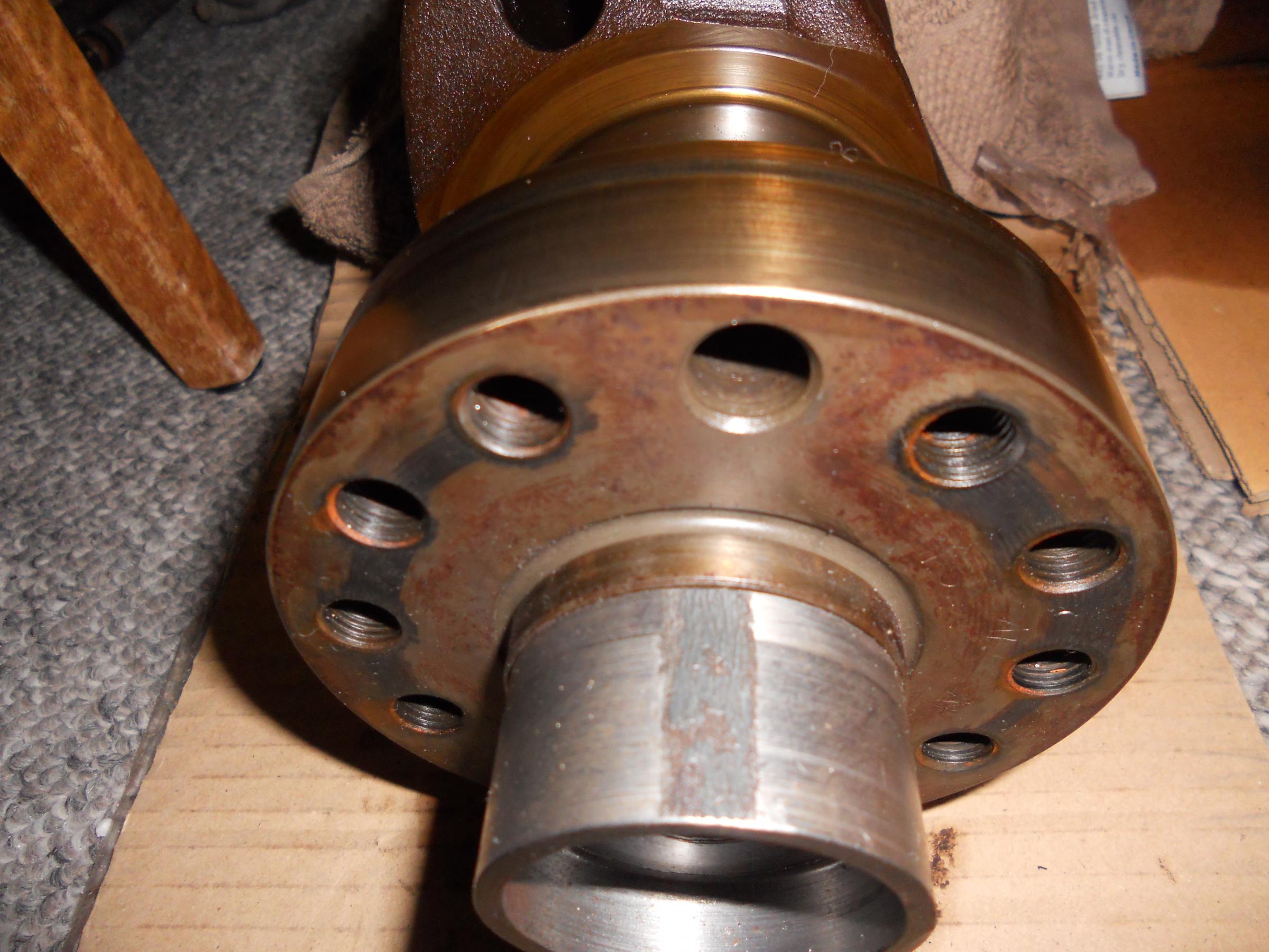

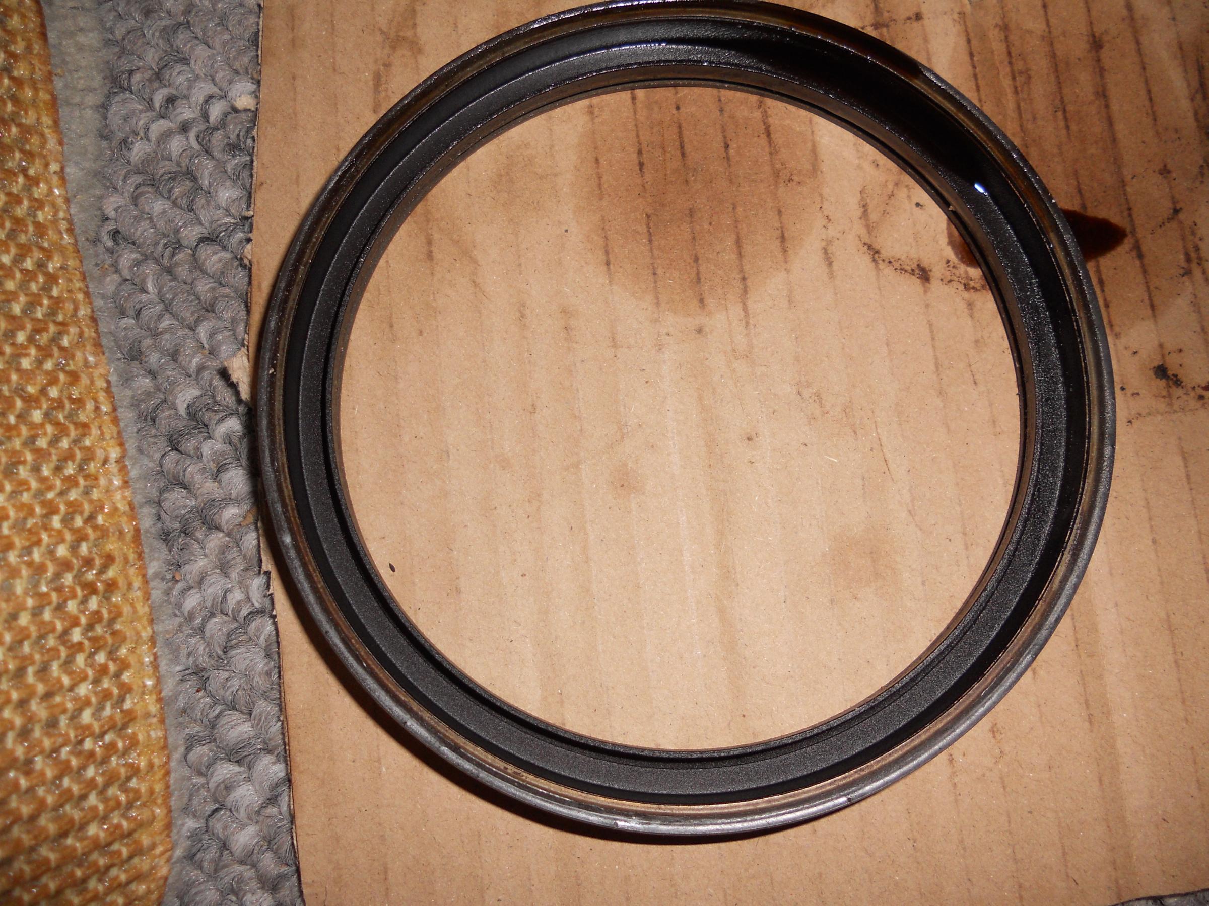

Old Mar 1, 2014 | 06:47 PM
warrjon's Avatar
Posts: 4,638
Likes: 2,583
From: Vic Australia
Hi Ron
Here are some pics of my 6.0L rear seal, crank etc. I have not seen in the flesh a rope seal only in pictures. My understanding is the block is the same only the crank seal journal is different (small in diameter for 1 piece seal).
Attached Thumbnails V12 Engine block identification-dscn0901.jpg   V12 Engine block identification-dscn0907.jpg   V12 Engine block identification-dscn0908.jpg
Warrjon
Do you know what has to be done to convert rope seal 5.3 crank and block to take a modern one piece seal, please?
Greg
Old Mar 3, 2014 | 03:23 AM
warrjon's Avatar
Posts: 4,638
Likes: 2,583
From: Vic Australia
I do not have a rope seal block to verify the block is the same. It looks like it from pics
i have seen. If you want to a conversion I would suggest buying a 1 piece seal and fit it to the block.
The flywheel flange on the crank will need to be ground down to fit inside the new seal.
