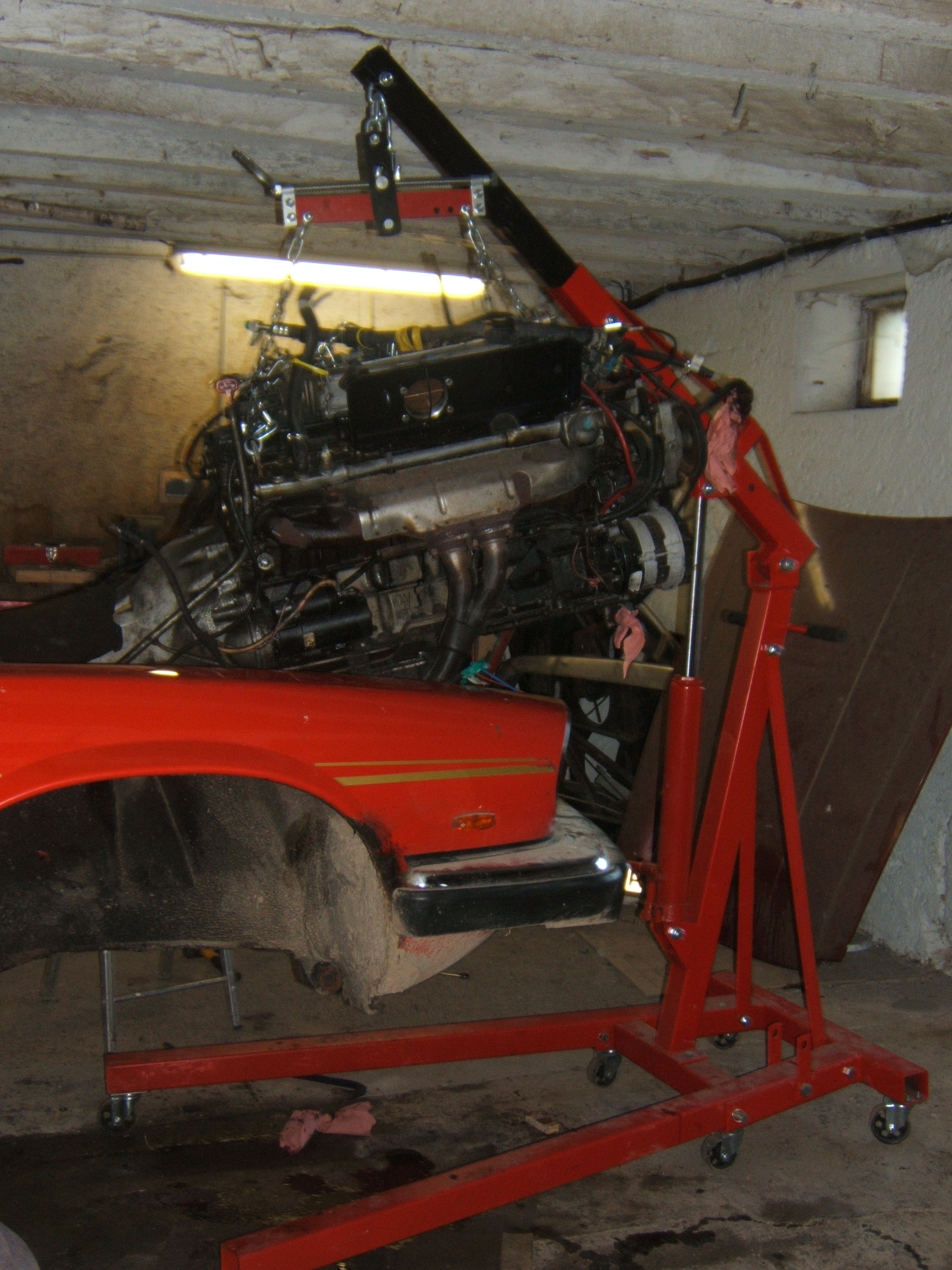

It is also vital to have a tilting deice on the crane, so the engine can be pulled out. Also all the rads etc etc need to come out.

Mr assumption again, must learn better, hahaha.
Clearly the rads, etc out of teh way, front bumoer off also gives that ectra 4" sometimes needed when refitting theng.
I take the air cleaner covers off, and thats about it, it comes out easy.
If you have Cats in the downpipes, remove those downpipes if possible. We dont have those Cats, and the downpipes stay put when I drag that thing out.
Gregs mention of an angler, is good, although I have never used one, just position the chains to give the angle I want from the get go, and get into it.
