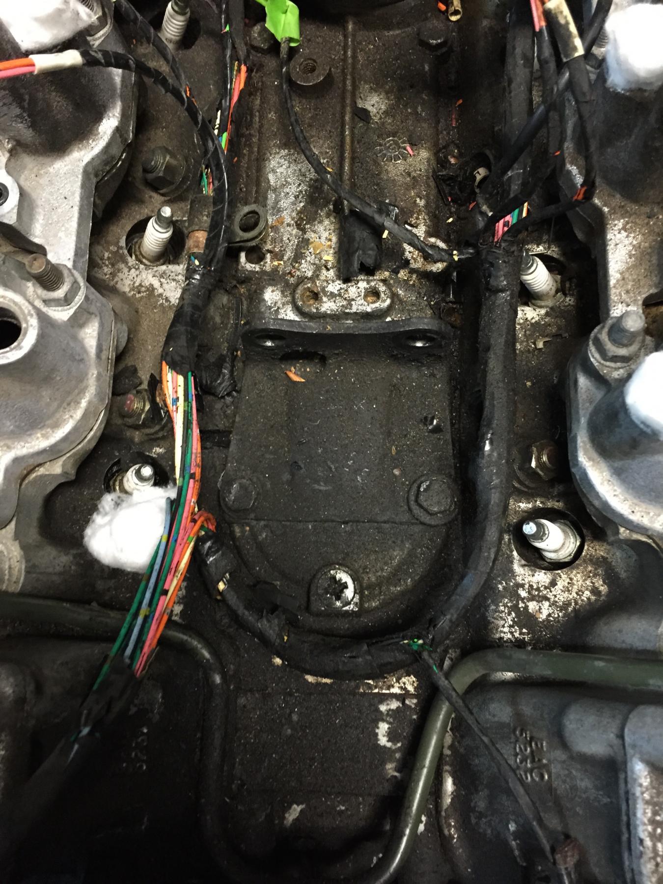

Well, I've emptied the V. What a mess! I've found several spare parts and an acorn
will post pictures of everything but here's the V. I highly recommend removing everything in your line of sight if you do this project since it's too emotionally challenging otherwise. The question to the group is... do you want to see my drawings of the wiring or do you want to wait for my dad to do the AutoCAD drawing?
As with all small jobs this one's become rather big! I knew it would but hoped not this big

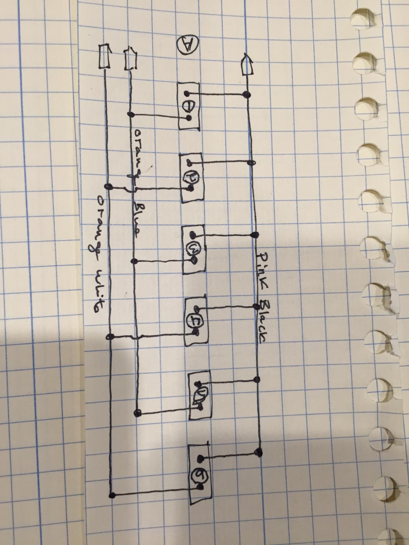

Thanks for posting this sidescrollin. I will have to study it more but I can tell you that the car isn't wired this way. Here is my ameture drawing of what's actually there on A bank (B is exactly the same with different colors) and you can see the difference.
Good luck with your project. On my 78 I also found all the wiring in the V to be nasty. I fabricated a new injector harness, reconditioned the distributor. The rest of the wiring in the car seems to be generally OK.
if you look at the injector bank ( top 6 lets say ) the wire on the right goes to all six ( as per your drawing,
the two wires on the left go to two banks of three injectors, ( again, as per your drawing )
the Jaguar drawing shows connection points as well ( black termination points ) as well as plug connectors
wire for wire, the two drawings are the same

Okay, here's where my novice comes in so please be patient with me.
The Jaguar drawing shows the injectors and wire colors grouping like this on A:
Orange & Blue- 1,2,3
Orange & White- 4,5,6
Pink & Black- 1,2,3,4,5,6
My Car is like this on A:
Orange & Blue- 1,3,5
Orange & White- 2,4,6
Essentially my care is like yours except that mine is 6 pins and yours is 8. I'm not an expert at reading wiring diagrams but I'm having a hard time trusting that this Jaguar drawing is the same as my car? What am I missing? I'm not sure but believe that if I wired my injectors like the Jaguar drawing my car wouldn't run.

the thing to take hold of is that all 12 injectors have a common feed as they are all always live
( so thats two wires that can be made to one ? ) with the ignition on.
then there are four switching circuits to ground through the power resistor and then ECU
2 for the A bank ( odd number injectors and even numbers ) ,
2 for the B bank ( odd number injectors and even numbers )
after that you can mess around with how the physical wires are routed and grouped
if you look carefully at my main loom plug ( i know its different to yours ) you will see all the pink wires joined together on the ' live ' side of the plug, then have separate feeds out to each bank ,
If you follow the two KB wires back to the main FI relay they got to the same pin, so they are the same.....
so in theory , you can get away with a 5 pin plug as a minimum for the 12 injectors..
