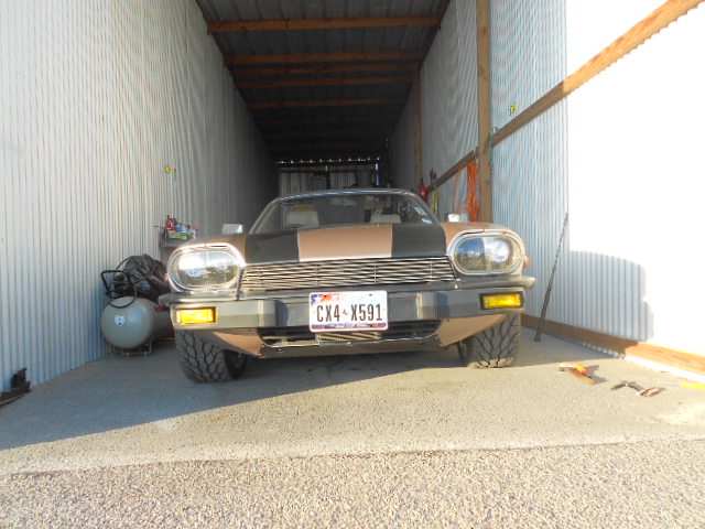

darn Jag wont hook the tires, must be the automatic trans faulty.

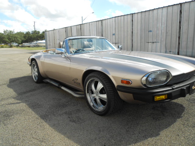

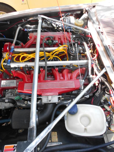

it would be nice to my automatic trans.XJS V12 up against one of your manual XJS V12 s.
i tried to give it an agressive stance, for looks etc. i think it worked out OK!
calibrated weight 3365lbs,, dynod 355hp at the wheels, simple and effective.
