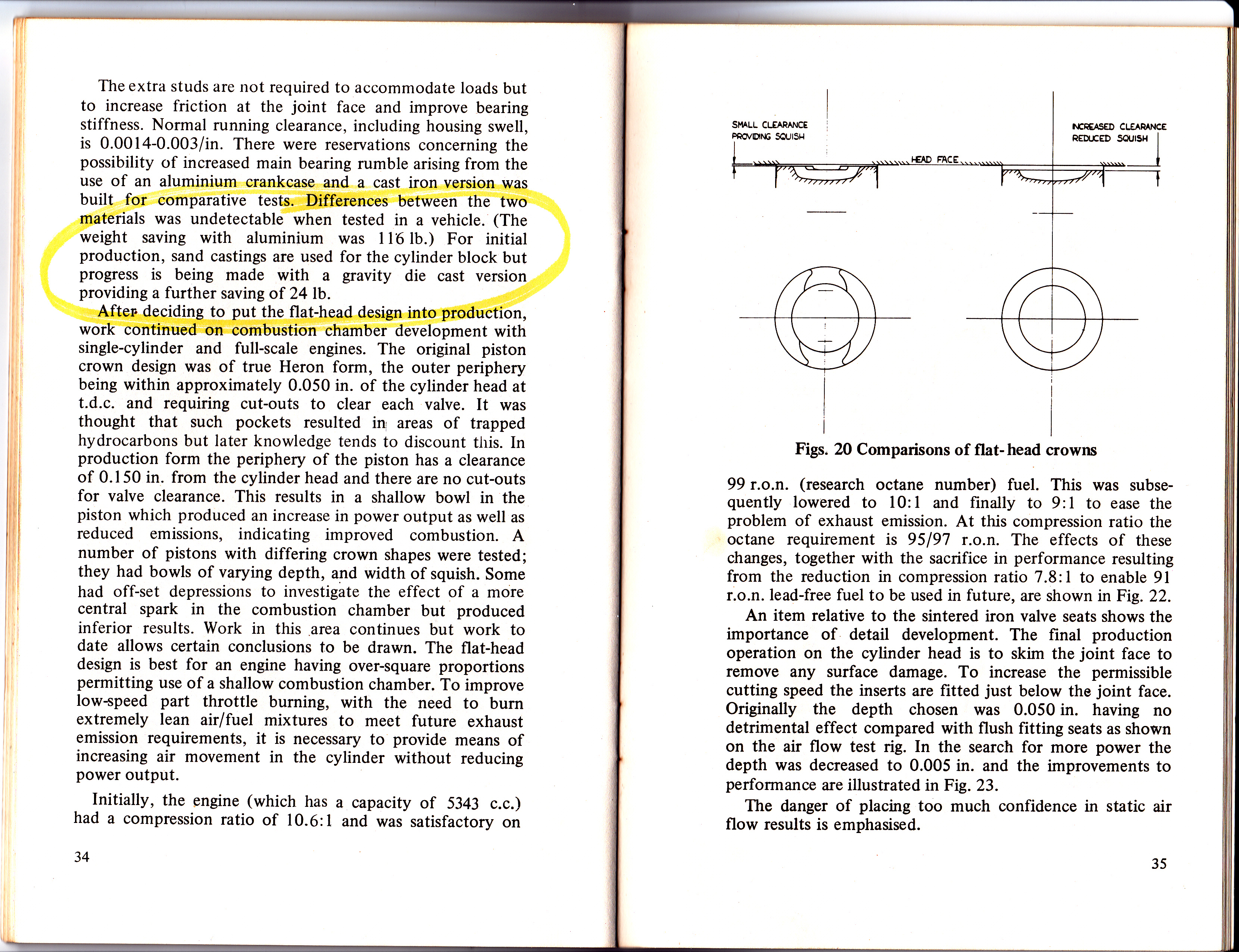

question; what was the comp, ratio of the early V12 around 1970/1971, in E type cars?
Old Dec 18, 2017 | 07:09 PM
In Europe, 9:1, in North America 7.8:1.

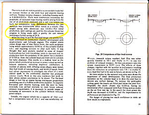

jagboi; that is not completely true, there were some engines (probably UK only), that had over 10-1 comp. ratios, !
pic drawing from Jaguar of some info about pistons, .
notice piston with tight piston to head and large valve reliefs.
little known fact , is for the Pre-HE head , resurfacing deck face .050 thou. brings the effective ratio up about 2/3 tenths higher, best i can figure is my engine with 9-1 Euro pistons is around 9.2-1 now!
Attached Thumbnails V12: From U.S. to European Compression Rate?-img_0001.jpg
.jagboi; that is not completely true, there were some engines (probably UK only), that had over 10-1 comp. ratios, !
Not in the E Type Ron, as far as I know. There were a very few late XJS pre HEs that had a 10:I CR engine and a different, but not HE injection, called the P Digital. These made more torque and more power than the normal pre HEs and were sold in 1980 before the HE was launched. I have a feeling that page you uploaded is from Walter Hassan's most interesting booklet describing the V12 design and development process that led to the finalised production engine as first used in the E type and the XJ Saloons. For anyone's info, the Hassan booklet turns up on ebay regularly and is well worth buying.

Didn't the first year V12 E-types have high compression for all markets?
Just wondering.

If you look at the second page of Ron's photo of the Hassan book, he actually says the engine was developed on 10.6:1 CR and then subsequently the CR was reduced to 10:1 which was fine on 99 octane RON; then it was reduced further to accommodate much lower octane fuel, presumably for the USA market, as 99 was available everywhere at that time in the UK and Europe. It is not clear from his text whether these changes were made during development or after the engine was in a production car. So I googled the question and found Roger Bywater definitively saying the E type V12 was launched at a CR of 9:1 in 1971, with a lower CR for US and Canada.

it is quite possible that some early proto types may have had the experimental hi pistons.
UK only. if only i could find a good set of the pistons with the valve cutouts??
Nahh, may as well have custom pistons made , forged aluminum lighter weight, comp. ratio of my choice,, better ring selection(reduced frictional drag), thermal coating on crown , low drag skirt coating.
coatings to keep combustion temps, away from the cooling jackets, i dont want to end up with a small steam boiler!!
