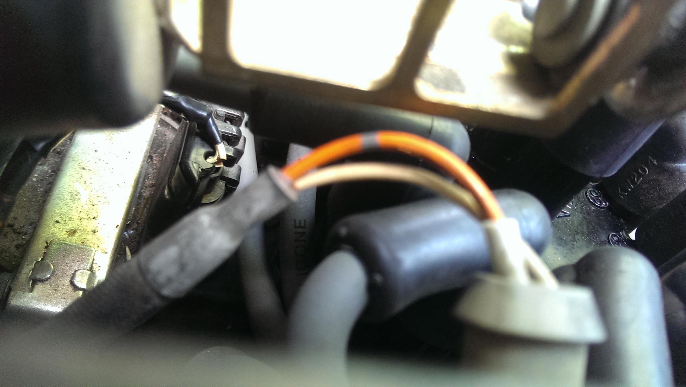

This forum is sooo helpful. I retraced my steps and indeed it appears that I damaged the wires leading into the B bank ignition coil. I have so far been unable to find a source for a replacement boot with pigtails. I will likely try to splice it today.
Is there anything special I need to consider when splicing a wire that will get HOT?
Anyone know where I can source a new boot with pigtails? One of the cracks in the wiring is very close to the boot.

Bummer, I started to splice the wires coming from the B ignition coil only to find that the wire is crumbling all the way into the B bank ignition loom. I think I will need to remove the protective covering before I find a solid wire from which to splice. I was planning on building a complete new loom for both banks this winter. Anyone know where I can find a good schematic for this project? All the ones I see are for earlier v12s and do not include wiring to the A + B ignition coils.

I'm sure one of the guys can get you a schematic. I will tell you that I rebuilt/built a new ignition harness for my 89 V12 car, and even though it took some time, it wasn't that bad. Looks like I need to build a new FI harness now too. My car had been at the hands of some notorious parts changers. Had new harness built, then cut on them trying to get the car running. It was a real mess. It really isn't that bad. Feel free to contact me for some moral support. I had two or three guys give me advice via cell phone, and it turned out great.
