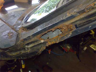

the facelift with the bonded screen has a major problem beneath the a post trim, by the time it is found its usually end of the line as the electrics get wet
and cause expensive damage, good luck
