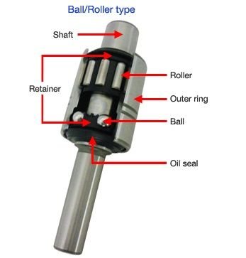

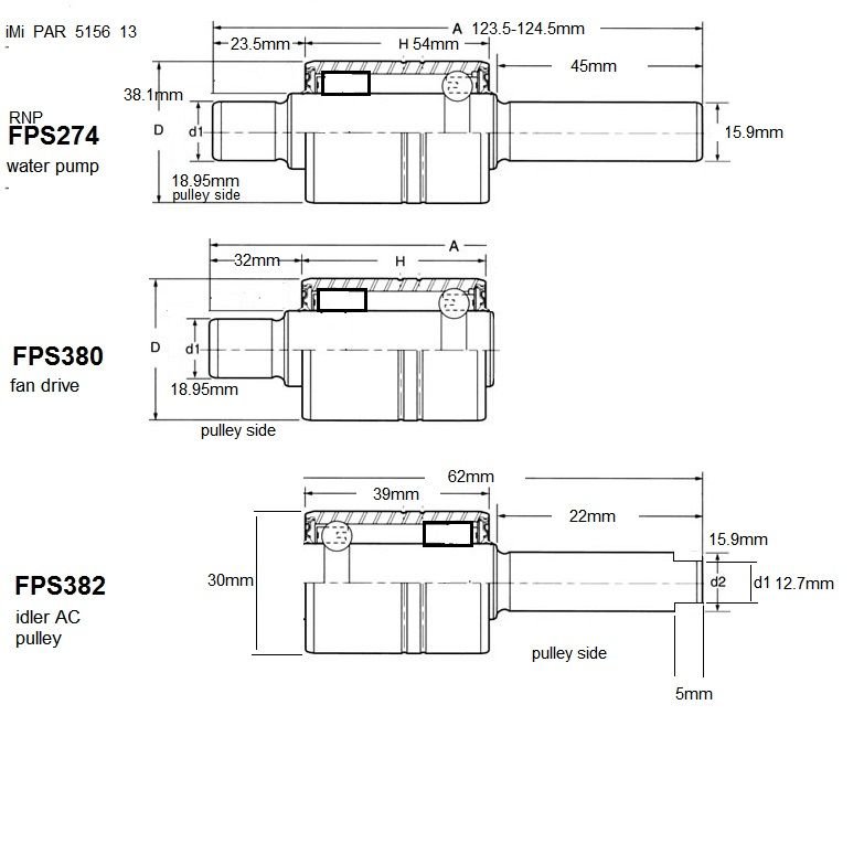

My research
This should be a roller ball
Measurements
Different manufacturers

So, my search has come to an end. Thanks again towards Grant, aka the wizard of OZ, for his efforts and help.
My luck: my cousin managed to find a bearing in Britain - maybe the last one? Anyhow, my search has ended
