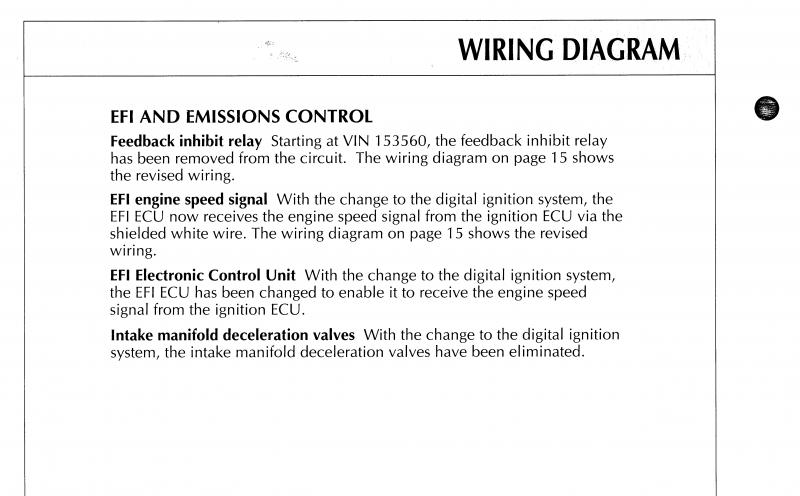

BTW the 16CU ECU you have is this from a Lucas car or a Marelli car? because a Marelli 16CU does not work properly in a Lucas car..... So I have been told. Because the Marelli and the Lucas 16CU units communicate with each other to adjust fuel and ignition.
