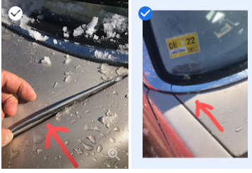

Thanks in advance - 96 xjs.... not sure what to call these when I search ...best place to buy? First pic...fender bead? fender moulding? 2nd pic...no idea what thats called
or where to buy...USA - Thanks all

First pic ... Filler strip. I replaced these with black Automotive Silicone Sealants.

They are available from Welsh’s or somebody like that at extortionate prices. The replacements are a rip off. I too did what the other poster suggests and use black silicon/ polyurethane. Just as good and looks right as well.

Chinese industrial supplier market places have spools of this cheap.
Its just a rubber cord of XX milimeter diameter try Alibaba ?

It’s called fender welting. Google that and you’ll find a ton of options
