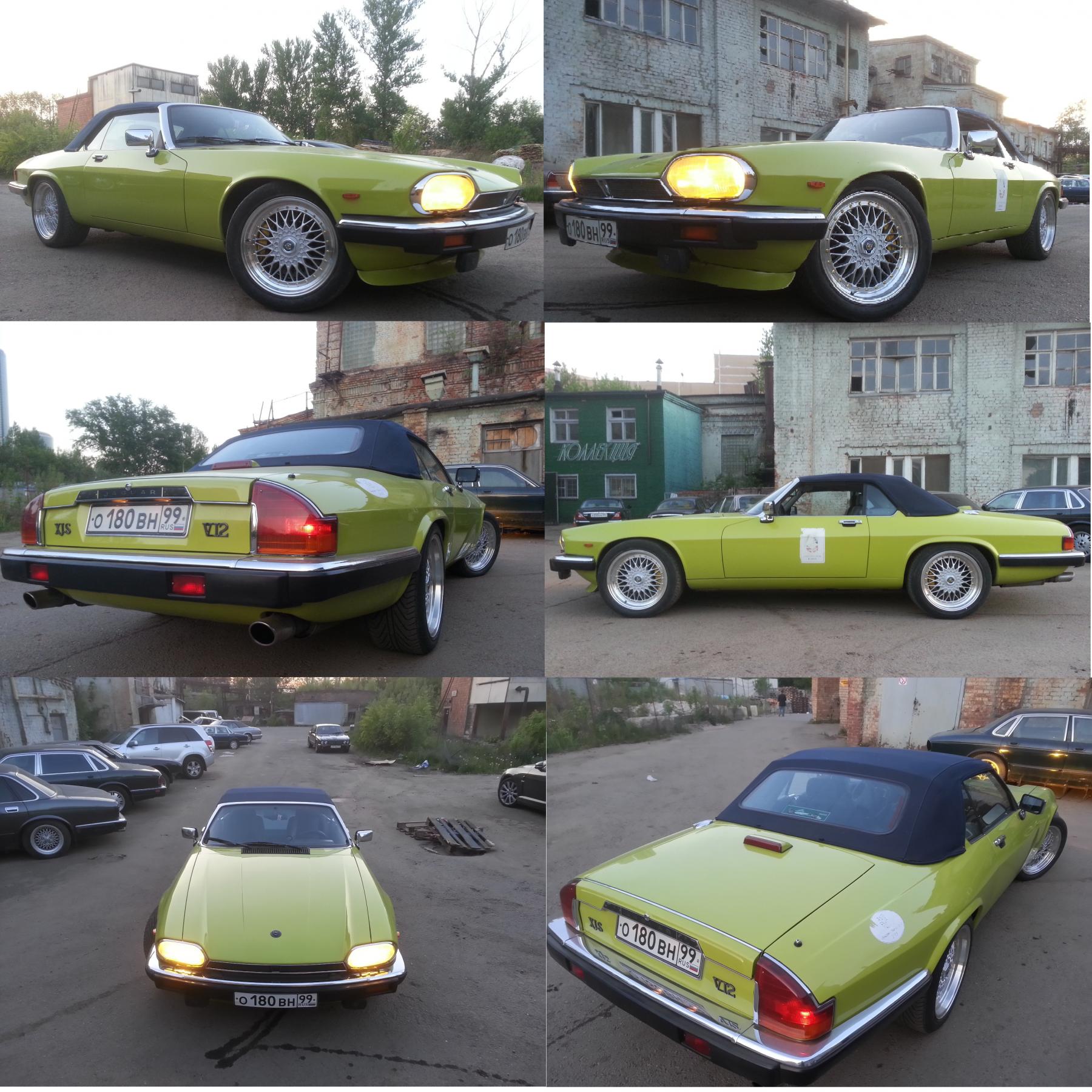

I followed the path of reasonable sufficiency

This is my answer JagZilla. It is Jagor Lemon.
That's a good looking car, xjsv12.

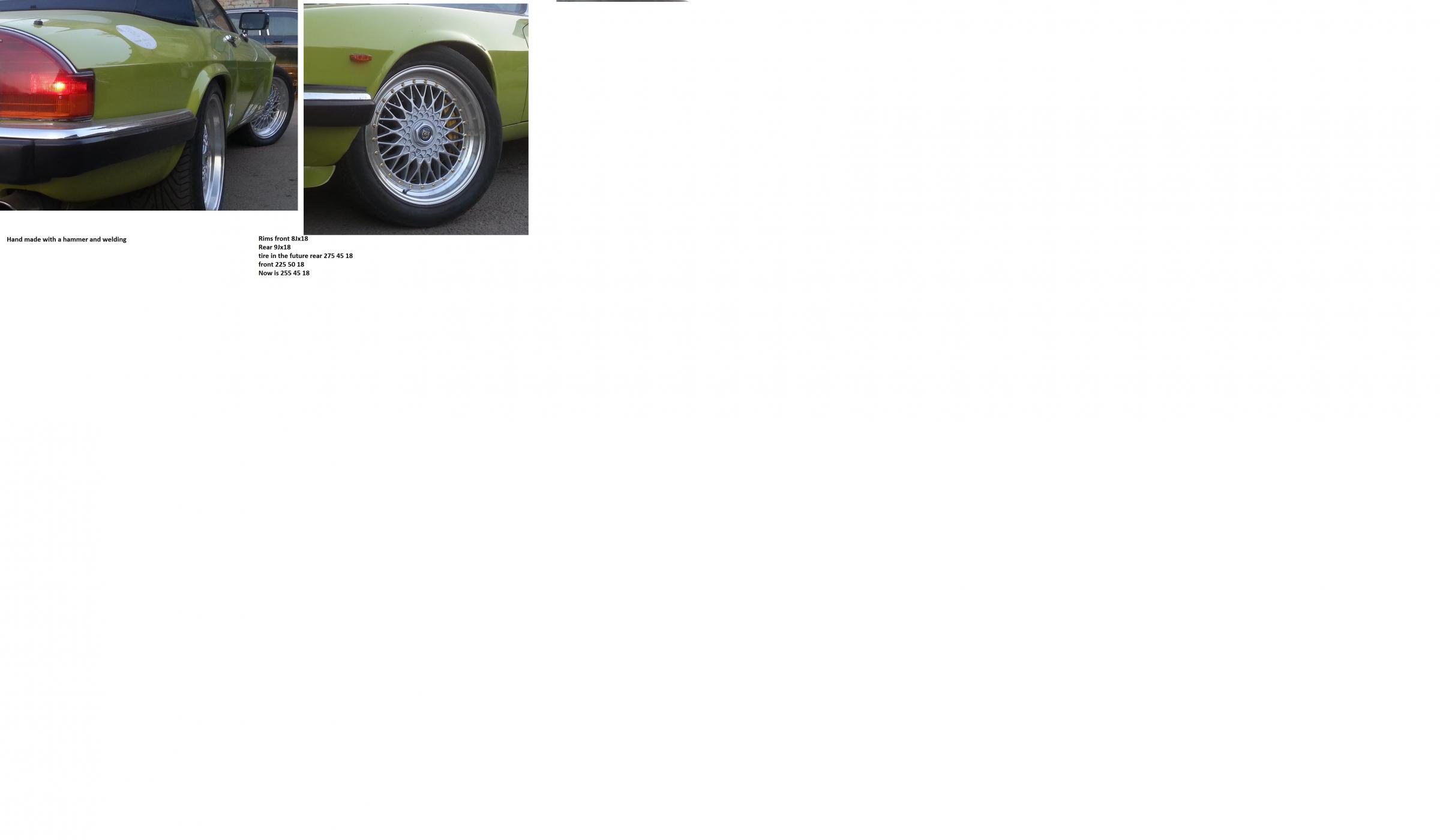

My wide body steel fenders is only 1 inch. Big wheels for XKR brembo brakes. There is more modified front suspension. Aston Martin parts installed.
Sorry for my English.
Your English is fine
The fenders are done really well, and they create a subtle difference between your car and a stock XJS. Thank you for sharing those photos. I'd love to see more photos, and read more details about all your modifications.
Did you stretch and expand the original fenders, or did you make those new fenders from scratch?
What size are your tires and wheels?

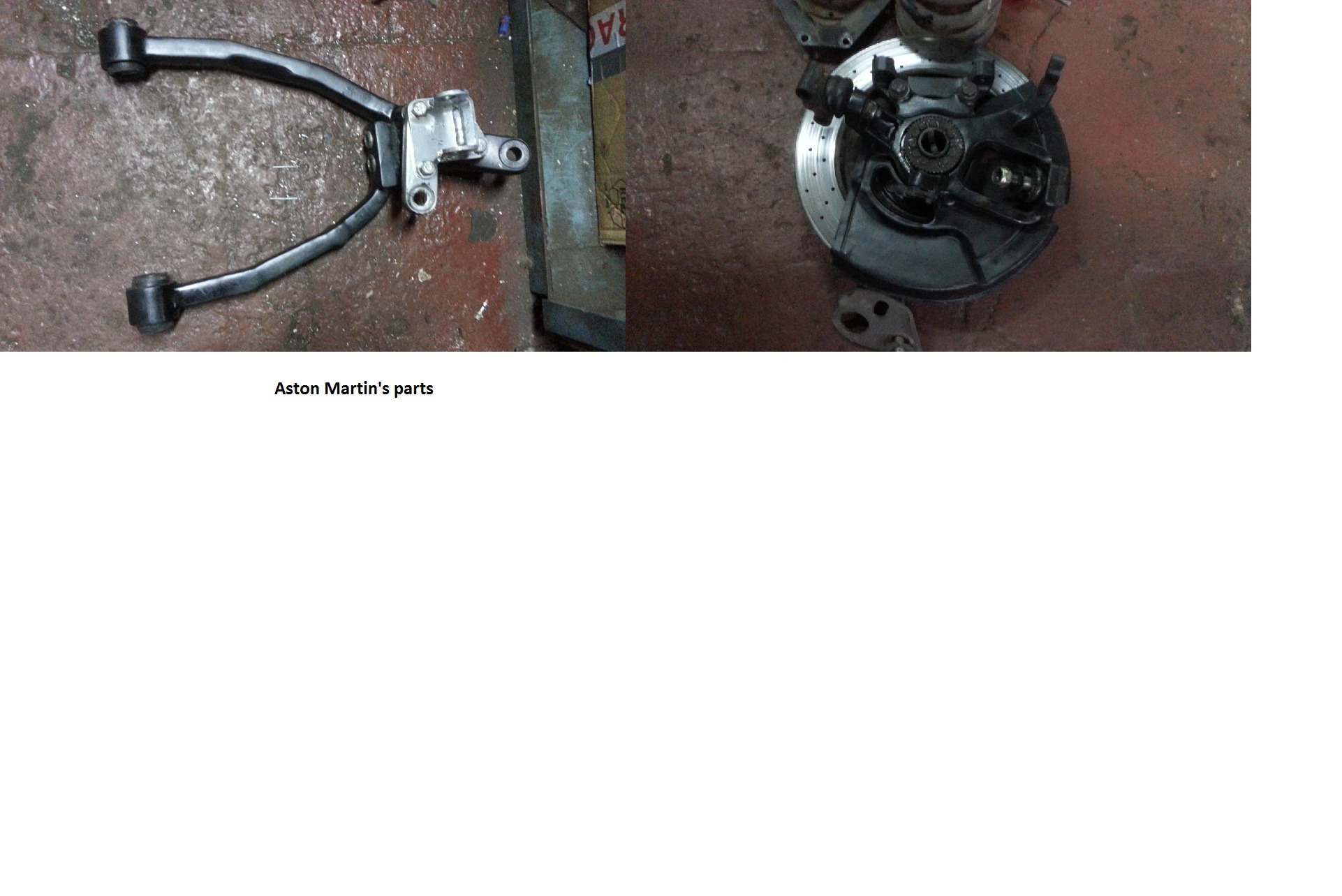

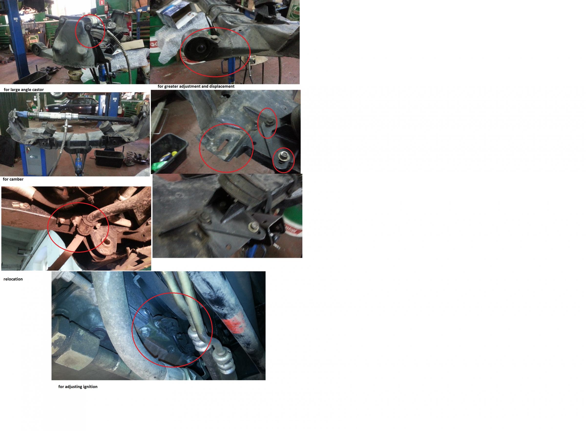

Front suspension

For better brakes

Warning! DB7's suspension is wider more 1inch
Very difficult to find wheels

How much different is the db7 suspension than the xjs suspension?

From: Moscow Russia
body
