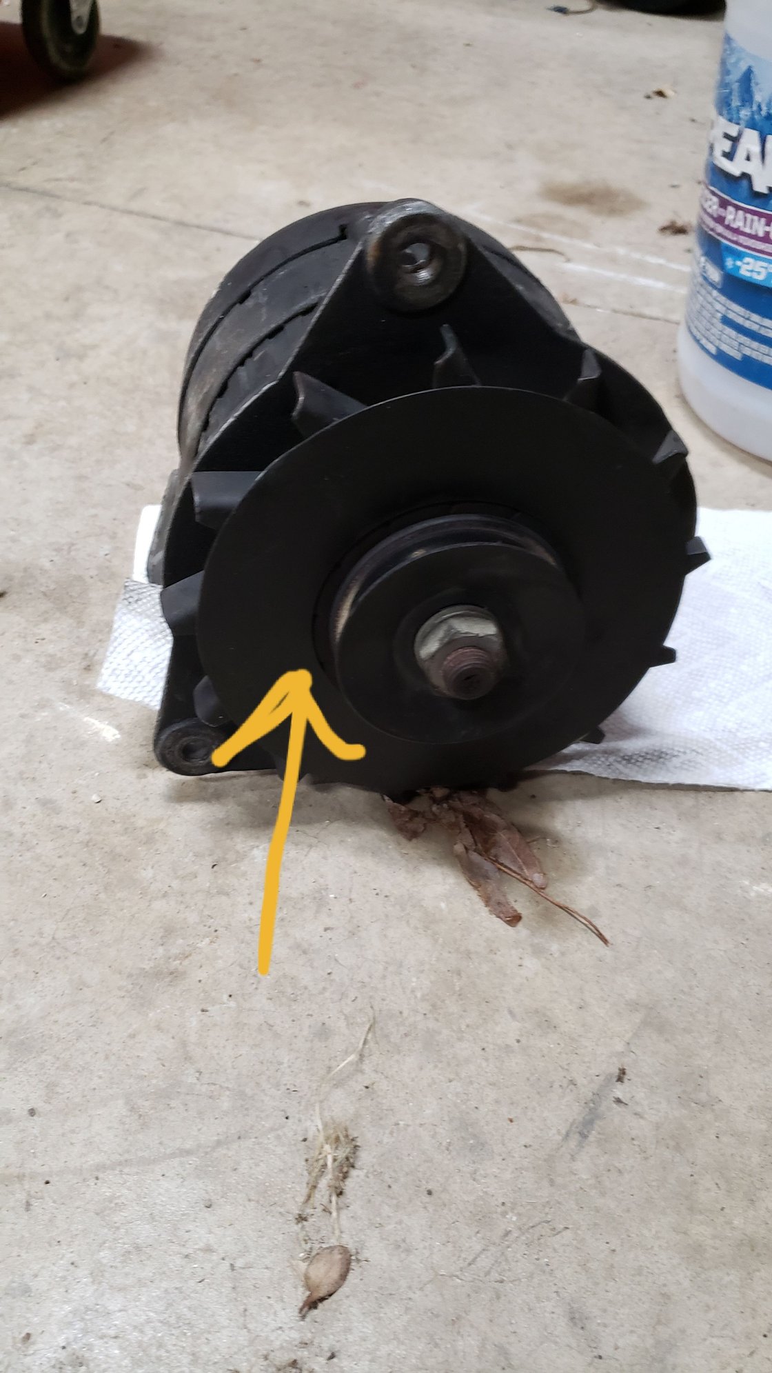

I just changed my Alternator on my v12 and the fan on it was making a noise like what is in your video. It was loose and spinning freely if the pulley.

i replaced my crappy Jag alternator with Japanese replacement , charges better no noises!
