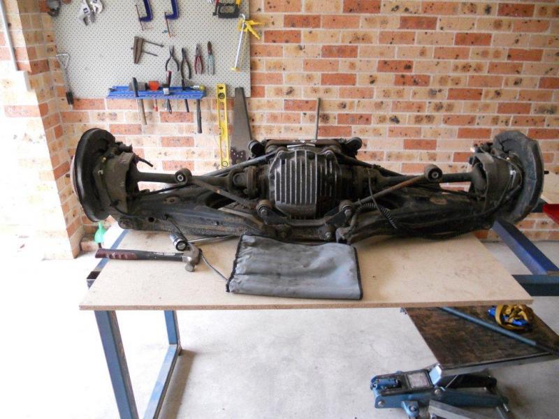

Yeah that was my concern as well, I think the 4.09 would be ok with a mild V12 say upto 450hp but as I am planning 500+ I think smoke would be prominent so I bought this for $40.00 yes 40 bucks, an XJ40 rear end you say -WHY- it has a 3.58 LSD center and I feel an outboard disk conversion coming on

Mine will be mild, I'm planning on keeping A/C, power steering etc, so there's little room for power adders.

You would be surprised what you can get in the bay with some careful planning. Lister added 2 centrifugal superchargers with all conveniences kept. Besides a NA V12 can make 400hp from 6.0L.
