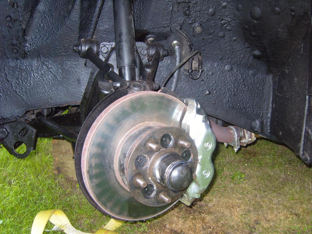

But the Test Drive on the other hand was not incident free! So I am going to need your Expert Advice!
I really don't know where to Start with this, so I better kick off with the Incident of the 'Trevis Fountain' under the bonnet!
Not knowing how the brakes would perform or not as the case may be, I decided to start the Test Drive by staying close to home, so in the event anything went wrong, I wouldn't have far to get back.
So after driving round the block half a dozen times, I stopped to check the wheels were not getting hot, as after almost setting fire to the car the last time out, when the Caliper seized.
I'm understandably paranoid and live in fear that it might just happen again! and in a way you could say that it almost did!
As I got one hell of a shock, when I lifted the bonnet to check on the brake fluid in the reservoir!

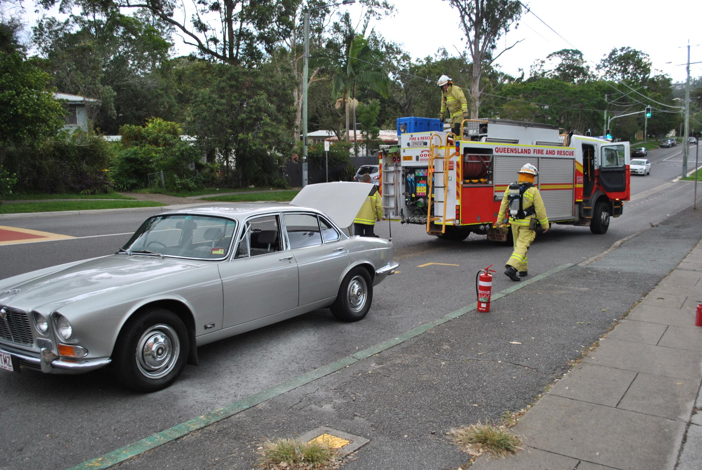

As a Fountain of Brake Fluid was jetting out of the breather hole in the Cap of the reservoir just like the 'Manneken Pis!' to the height of about 9ins! and then dripping down onto the hot Exhaust!
There was Brake Fluid everywhere as well as White Smoke pouring out of every orifice, having been there before I tried to keep cool and not panic but I cannot tell a lie, I was 'Bricking it!'

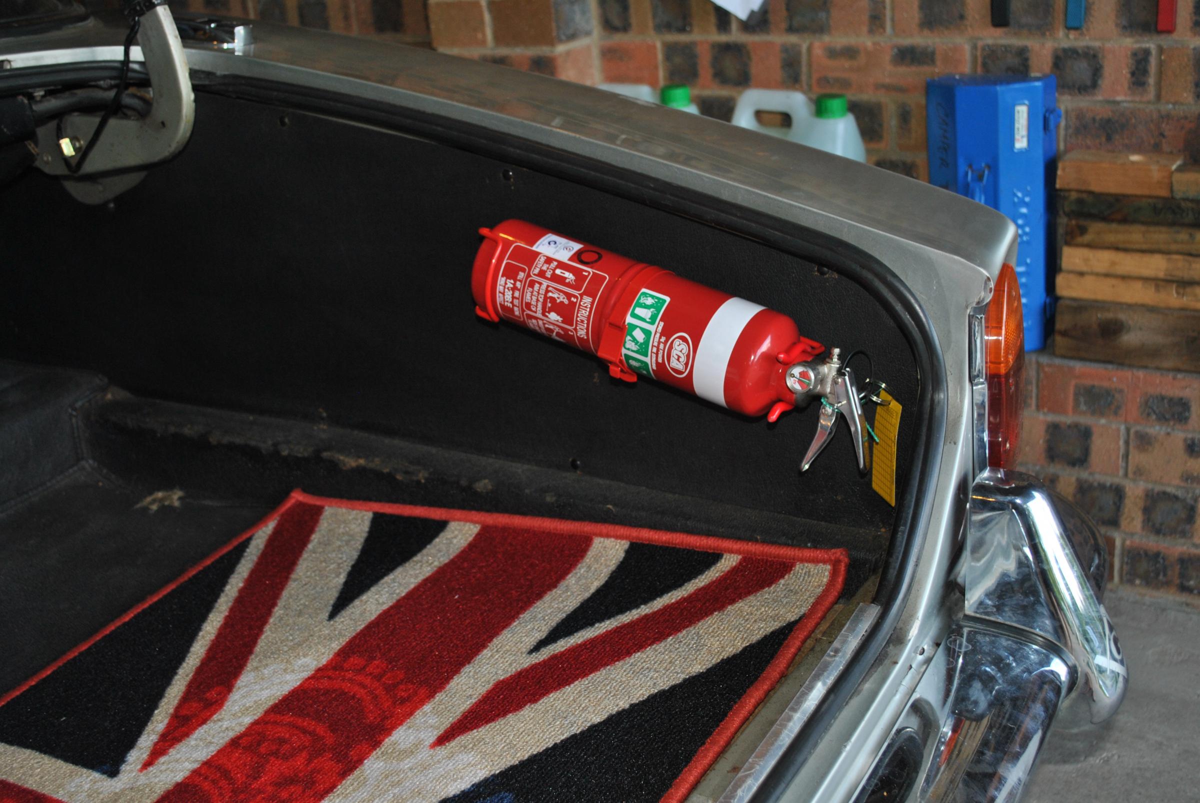

I was expecting a Fireball but this time I was ready, with some fire extinguishers that I had taken out of the boot but decided it would be a mistake to get too 'Trigger Happy' at this stage in the game.
As it might have done a bit more harm than good! so while waiting for the Explosion, I managed to Salvage a 'Mars Bar' together with my mobile phone and ipod.
As far as miracles are concerned, this was up there with the best of them, as none of the fluid went over the paint and the XJS didn't explode!, so I just let her cool right down, then carefully drove home.
Back at base I hosed down the engine compartment and having done a post mortem, saw what I had done wrong! which had been to fill the reservoir right up to the top, as I had done when I was bleeding the brakes.
So having siphoned off an excess of 350ml of Brake Fluid, using the Icing gadget which the GF uses to ice her cup cakes.
I then got myself psyched up for Test Drive number 2, as even after all of that the Brakes were working well, with only just a hint of sponginess!
So I increased the distance to about a mile from home, with a bit more speed and heavy braking, to try and bed in the new Calipers and Brake Pads.
Everything was looking good until I took a Corner! where there was a screaming sound from the passenger side, which was not the GF as I had left her at home, with instructions to come and rescue me in her MX5.
I wasn't going all that fast and so although it freaked me out, I am thinking it was the Wheel bearing, in the passenger wheel where it got red hot the last time but don't know for sure.
My mistake again! as I had forgotten to repack the hub with high temperature grease.
So in order to eliminate that, as being the cause of the problem, please could you tell me how to go about it.
I cannot see a grease nipple on the outside of the hub, so what should I do?
Can I repack it by taking off the hub cap?
If I have to take off that brake pipe, I think I'll top myself! As bleeding those brakes is something that I never ever want to do again!
The other thing was, after driving around with lots of braking thrown in, suddenly out of nowhere the Brake Pedal went 'Rock Hard' to such an extent that I started to think that it wasn't supposed to do that!
Although maybe it was?
(have you known that to happen on one of your cars?)

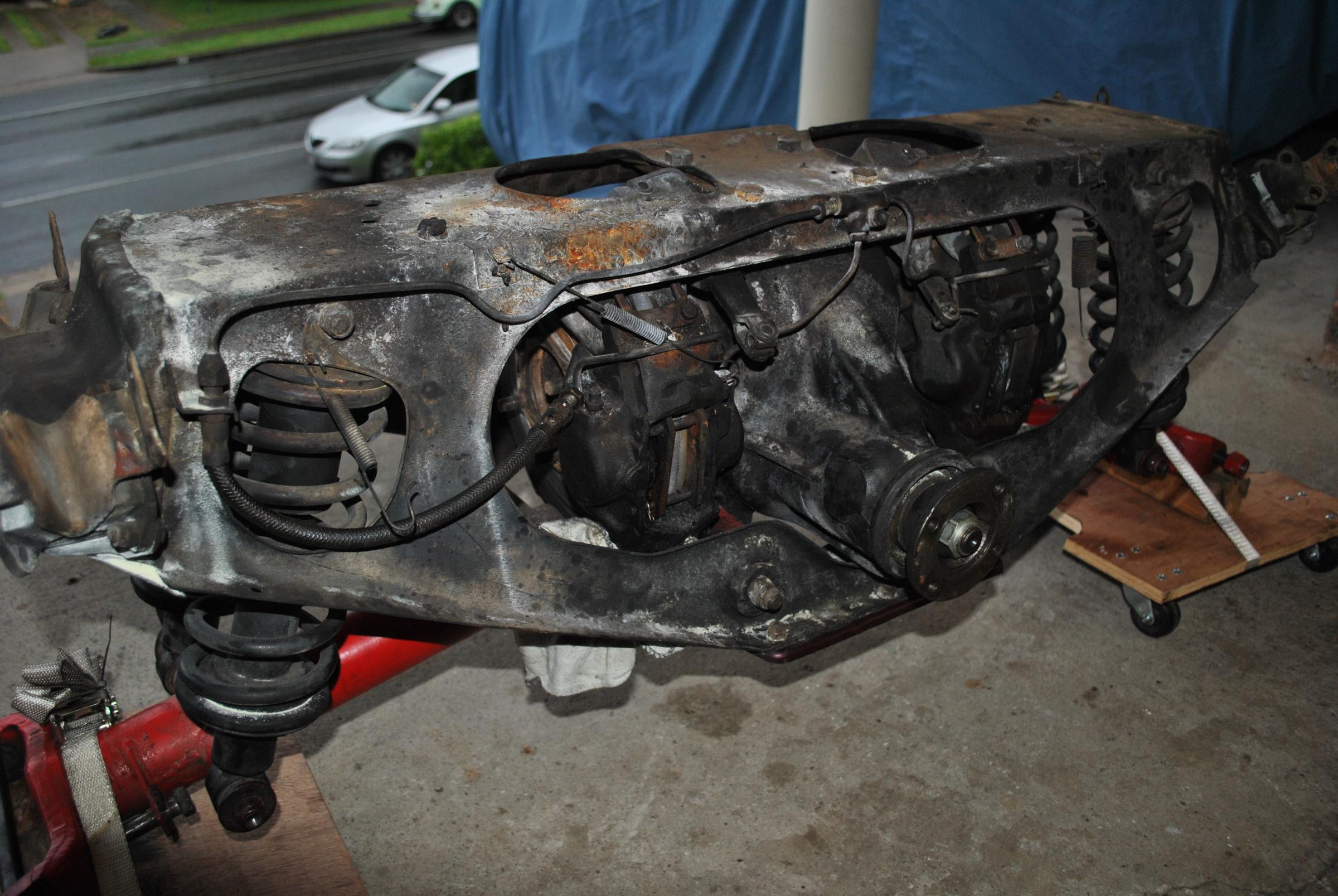

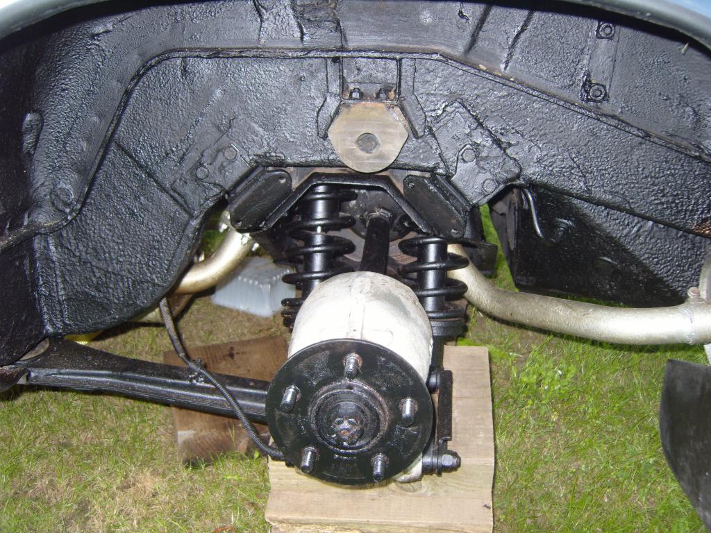

OB, <searching for the words> it's difficult for me to believe, that you had the front hub off, and neglected to repack the wheel bearings!!
I can understand overfilling the brake fluid, inertia/habit of action and such, but unless you have had the front hubs off within the past couple months, *ALWAYS* repack the bearings before reassembly. It's just good insurance.
XJS may be built different from any other car I've ever known, including my Xj6, but I have Never seen a grease zirk in a front wheel bearing cap.
You know what that means, don't you. In order to get to the bearings you have to remove the whole entire hub and all that entails. Fortunately, you don't have to fool with your calipers.
There are 5 bolts holding the hub to the disc. Remove them. When you take off the bearing cup the castellated bearing retainer nut is behind it. Remove the cotter pin (split pin) and unscrew the nut and washer. The hub will pull off easily if you haven't welded the whole thing together by running it dry. At this point you Must inspect the spindle closely. If you had screaming bearings like you describe, chances are Very good you have a scarred spindle (stub axle) and need a new one. There must be no pits or galls on the spindle and it must not be discolored.
The bearings should nearly fall out in your hand. Clean them well and inspect for all the usual suspects and deficiencies. If you have any doubts replace them. If there is any discoloration, replace them. Same with the spindle. If it's discolored, (yellow or blue) replace it. Discoloration means it got Really hot and the hard surface/temper is probably compromised.
Pack the bearings with High Temp Wheel Bearing Grease and don't be stingy about it. You might put grease in the hub too. Ya just about can't have too much wheel bearing grease! (Of course you don't want so much it squishes out and gets your rotors greasy.) To do that you put a blob of grease in the palm of one hand and work it thoroughly into all the rollers/***** and cages until the bearings are Full of grease. It's a messy job but the best way to get grease in everything. There should be no voids (bubbles) in the bearings.
I don't know the tightening specs for XJS, but for Xj6 it's .002-.006 inch end play. That is, the hub moves that much in and out on the spindle. You can use a feeler gauge to check between the nut and washer.
When you have bearing play properly adjusted, turn (tighten) the castellated nut to the next slot, put the cotter pin back, bending it exactly the way you found it. (You may need to get a new one) Be sure to put the cup back in place (I don't want to say why I mention that), put back the bolts that hold the hub to the rotor.
Now you can put your tire back on, and hopefully you're All done. -- Until next time.

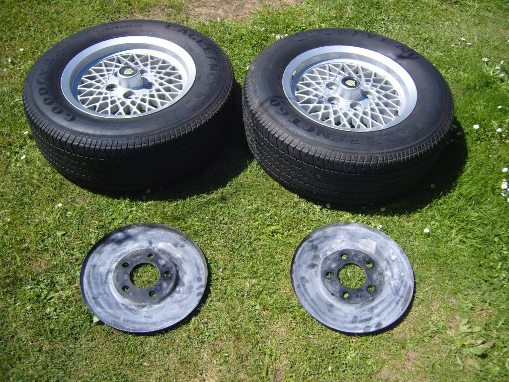

Everything LnR said! The only exception I would make is that the disc nuts can be hard to get to and hard to undo, particularly as you have refitted the dust shields (that I personally dump).
In your case I think it would be MUCH easier to undo the caliper bolts (easy for you as they are new) and carefully keep the shims in order each side, lift off the caliper still attached to the flexible and tie it up with some string to the shocker top so it does not need rebleeding.
Then you can pull off the entire hub and disc as a unit, easily. Then as LnR said, check the stub axle, which may anyway be a bit worn on the weight bearing surface, so only if it is seriously knackered does it need to be changed right now. Consult and post a pic if you are worried.
Then, install the new bearings you have just purchased (laughs like drain). And pack with Castrol BNS grease (works on rally cars, great stuff). Pack the bearing races themselves first and then the hub. Reinstall and tighten the hub nut to tightish then back a flat or so. Install special thingy over the castellated nut and then the split pin.
Whack on the calipers and drive the sod! I have got to say your posts are quite the most entertaining I have ever read; love it, and I think you are a great addition to the forum, and to boot, a proper chap who can take a joke, even if self inflicted.

Greg

Although I never took the hub off, as I gave it a spin and it seemed to be Ok and wasn't making any funny noises.
With the benefit of hind site though, I should have taken it off when I had the chance, before I fitted new Calipers and Brake Pads.
Fitting the new Brake Pipes was horrendous! as was trying to bleed the air out afterwards, where you end up chasing bubbles round and round the car, even though I did so in the right order. (something I got right for a change)
Even so the Sponginess never really went away although I managed to get the Pedal to 95% which in someways seemed normal.
So I progressively started to open her up on the straight and then when their was no traffic around, put the brakes through their paces!
When suddenly and without warning! The Pedal went 'Rock Hard!' with no signs of play whatsoever!
At this point I was thinking, that something might be wrong, so I pulled into a lay-by and got out to check the Temperature of the Wheels.
They were only just warm as per normal, with no signs of binding on the Rotors, as when you put her in drive, She just crept away with out the need to even touch the loud pedal.

So when this happened last night, I put the pedal down, at which point I heard screaming from the front passenger wheel, which was the one that got red hot, when I had the Caliper problem.
My first though was 'Wheel Bearing' although there is a 'possible chance' that I was involuntarily 'spinning the wheels' where instead I may have been hearing the Sound of Burning Rubber, which I try and avoid.
The one thing I don't want to do is take that brake pipe off, as bleeding those brakes all over again is the kind of 'Nightmare' that I want to avoid!

What on earth would I do without Guys like yourself and others, who keep digging me out of the holes that I keep getting into.
I know I should buy a Workshop Manual!
But I do get so easily bored, except that's pretty difficult when you own an XJS or maybe XJS's in our case! which if truth be known are more addictive than eating the bars of Chocolate I buy to try and keep the GF Sweet!
Thank God, That I don't have to remove that Brake Pipe, as I think that would have pushed me right over the edge!
