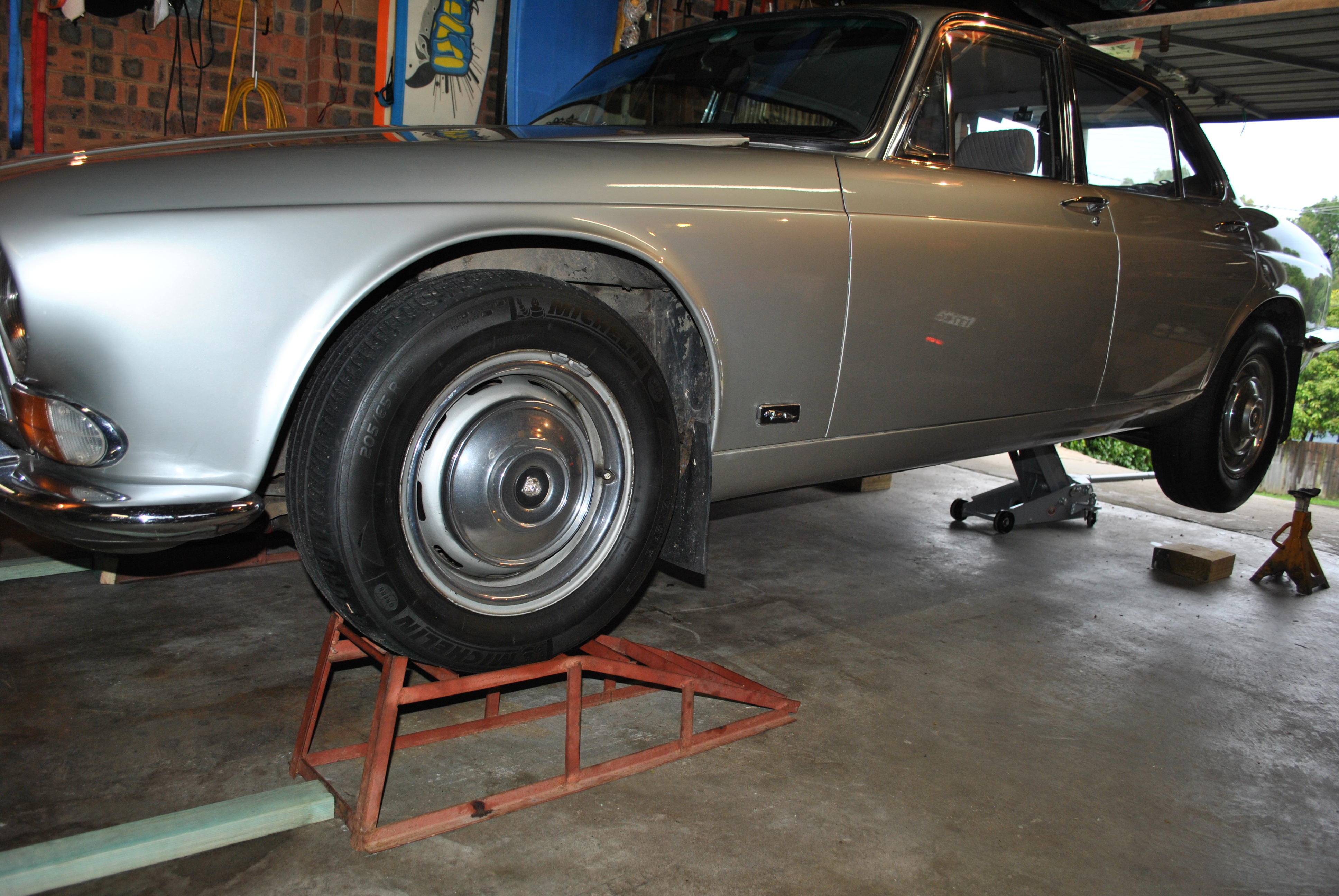

On the subject of ramps I have used them at both my mates house and apart from me not being able to drive on them properly they actually seemed pretty handy.
What are your guys thoughts? When would you use ramps over a jack and vice versa?

Ramps are worth having, as are axle stands. Both are used a lot at my place, some situations where on or the other are not right.Originally Posted by paulyling
Guys as always many thanks for the feedback.I got some shopping to do when I get home from work

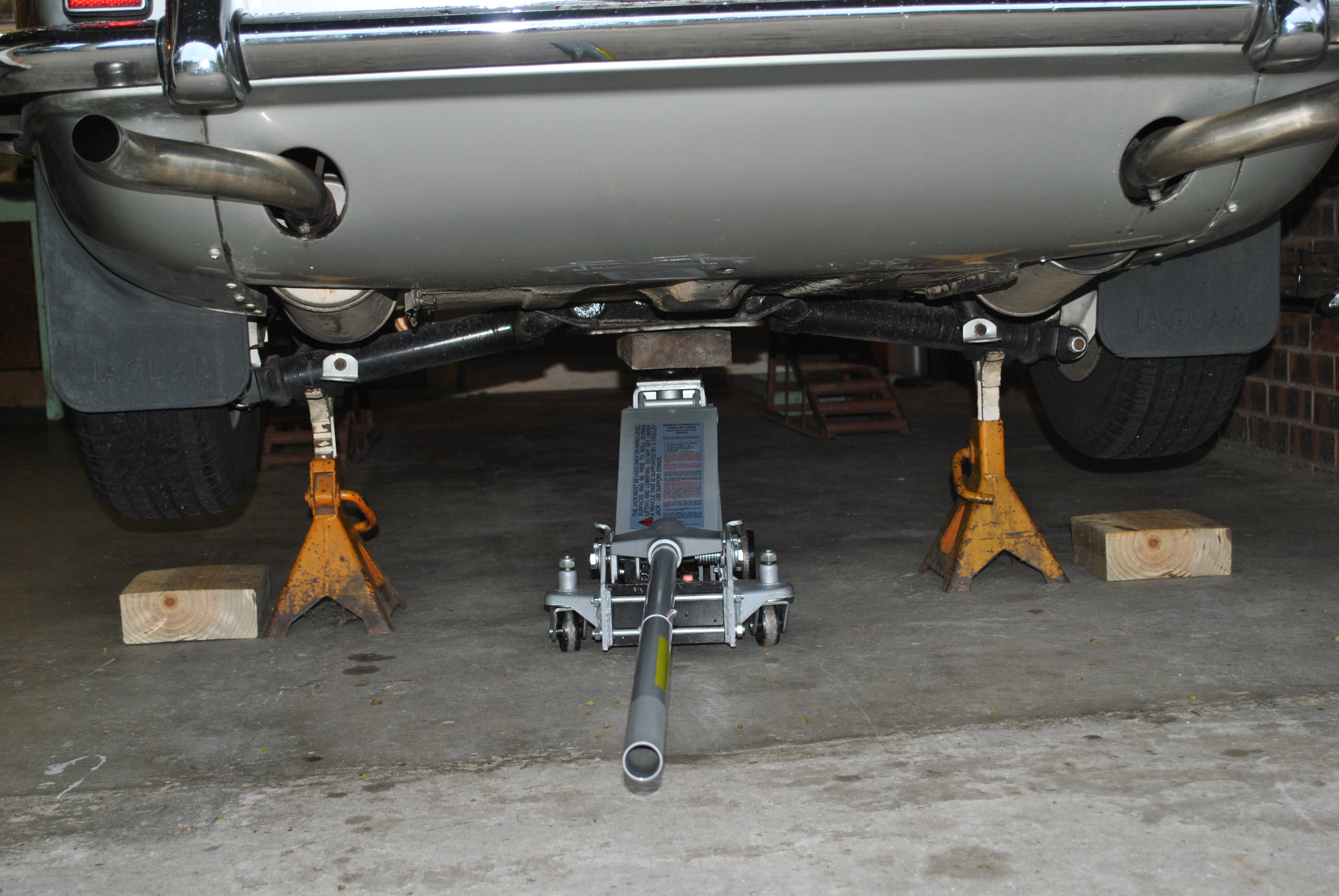

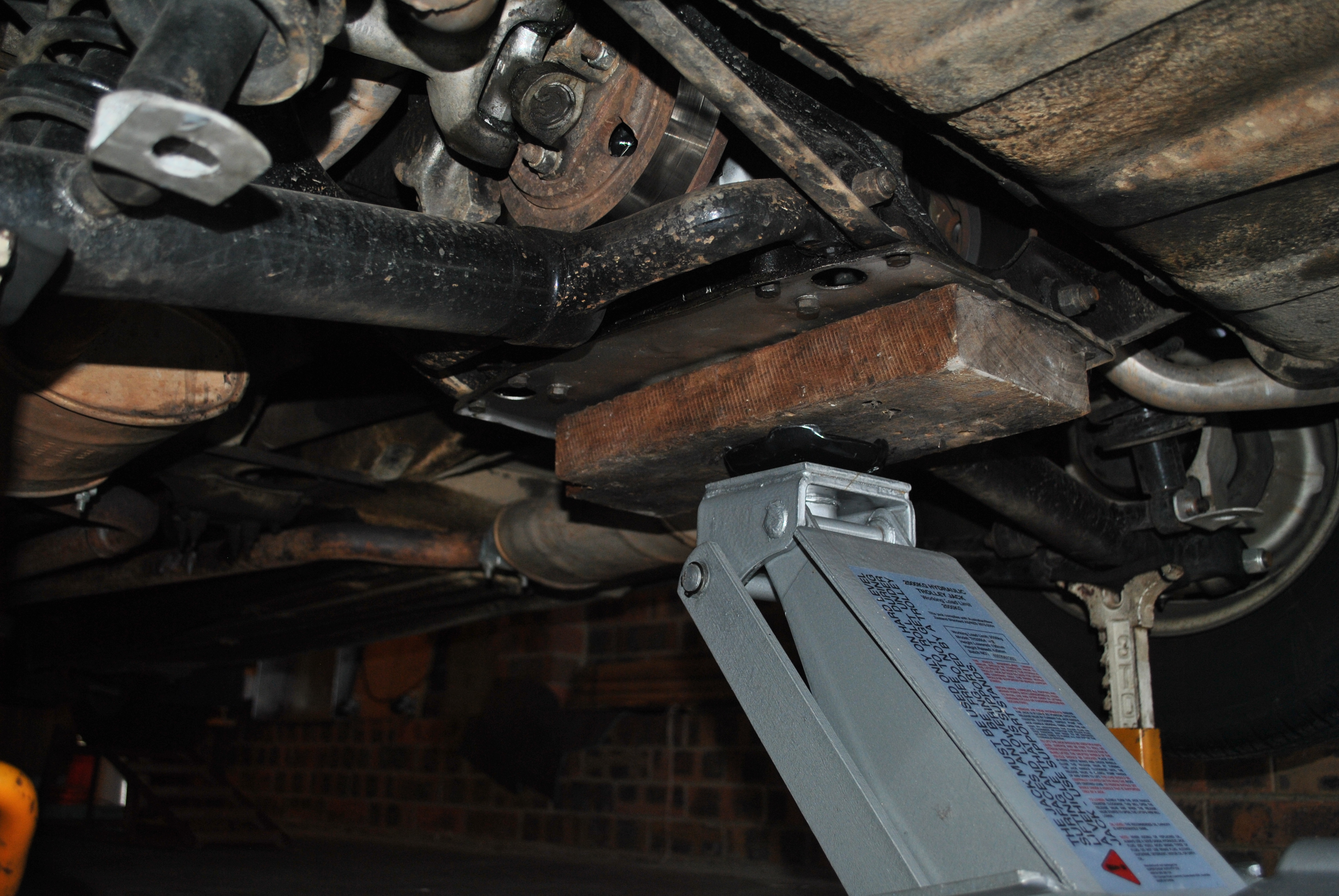

When you Jack up the Rear End, do you put the Jack right under the Crown Wheel and Pinion, with a small Block of Wood to prevent crushing the Cage?
As I have been Jacking Her up, underneath the Drive Shafts.

Its hard to tell from those Photos but that first one doesn't look very low profile to me.
Even with the one I bought which is 2.5 Tons, there is only a very few 'mil' to spare to slide the Jack under the Front.
So ask if you can offer it up to your Car before you go and buy one.

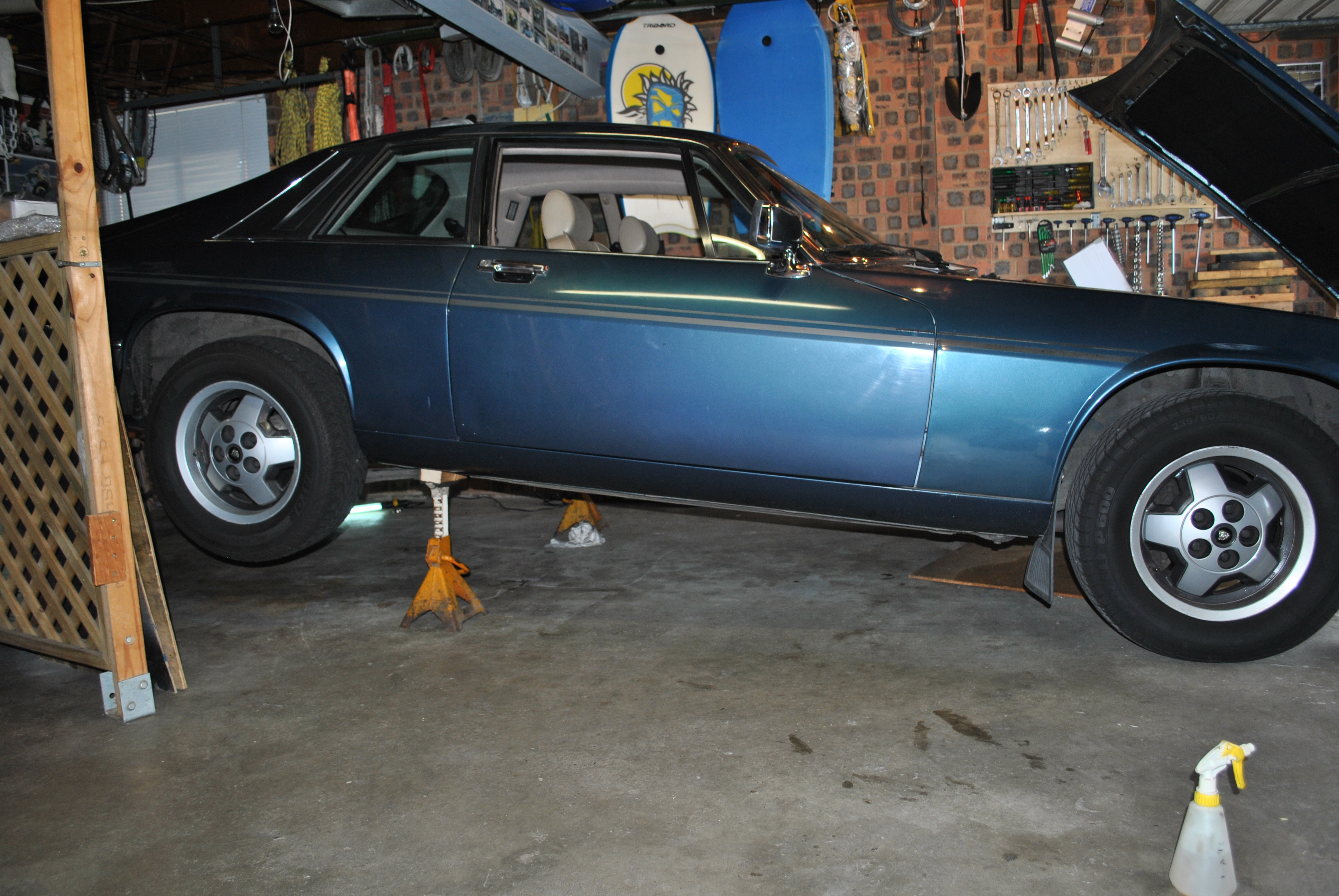

Since I hate crawling under the car, I figure dying there wouldn't amuse me much either, so I *always* over do it.
I have two floor jacks, a nice aluminum 1.5 ton that is easy to grab when I need it and a big steel 3 1/2 ton when I want to lift the entire front or rear end. I have two jack stands that are taller and high rated, and two that have a much shorter starting height. I have two pairs of the 8 ton (4 each) rated plastic ramps from Harbor Freight (I never use them as ramps, and don't even attach the ramp portion). The ramps are lightweight and easy to store, and there's no excuse not to pull them out when they are needed.
Before I get under the car, it is secure on the jack stands *and* the ramps are positioned under the tires. That way if anything fails, there is something besides me to catch the sled. The ramp/jack stand combo also works well in getting the car higher up in the air - raise front end, lower tires onto ramps, raise back end, lower tires onto ramps, go back up front raise to final height use jack stands, same on the rear.
Incredibly cheap insurance, and my wife doesn't freak out when she sees me under the car (well not as much).

To lift the rear, you need to make a "U" fitting out of plywood. Here is an image from the Factory Service Manual:
Greg in France

At the rear I put the jack under the centre of the rear cage on the plate under the diff, with a piece of softwood between the jack cup and the diff plate.
At the front I do the same under the middle of the subframe. As others have said, if necessary to get enough clearance, I drive the car up onto 1 foot square blocks about 1 1/2 to 2 inches deep.

Hi Paul
Just by accident of history and moving houses and countries I ended up with two trolley jacks. A small one rated at 2 tonnes and a large one as per the pictures above rated at 1.8 tonnes. I thought I would be tossing or gifting one but they have been really handy on multiple cars. I also have 4 stands and 2 ramps (Scepter plastic ones) all of which end up getting used regularly. Its interesting how often the cars end up in the air when you can easily. I tend to use the ramps when I can and the stands when I have to , just due to ease of use and positioning.
