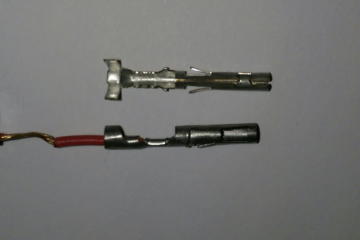

I am trying to replace the terminals in the engine harness and thought that I was replacing female weather-packs however they are about 2.4 mm too long. Does anyone know what the correct terminals are?
See the photo. The one with the wire is what I need the shinny new one is 2.4 mm too long!
Any help is appreciated.

Cut 2.4mm off the end with a dremel

@sidescrollin, I thought of that. Unfortunately the tangs to hold it in the connector are in the wrong place too so it won't stay in. ;-)

When its a Lucas Rists E Series available from 3 way components in the UK
