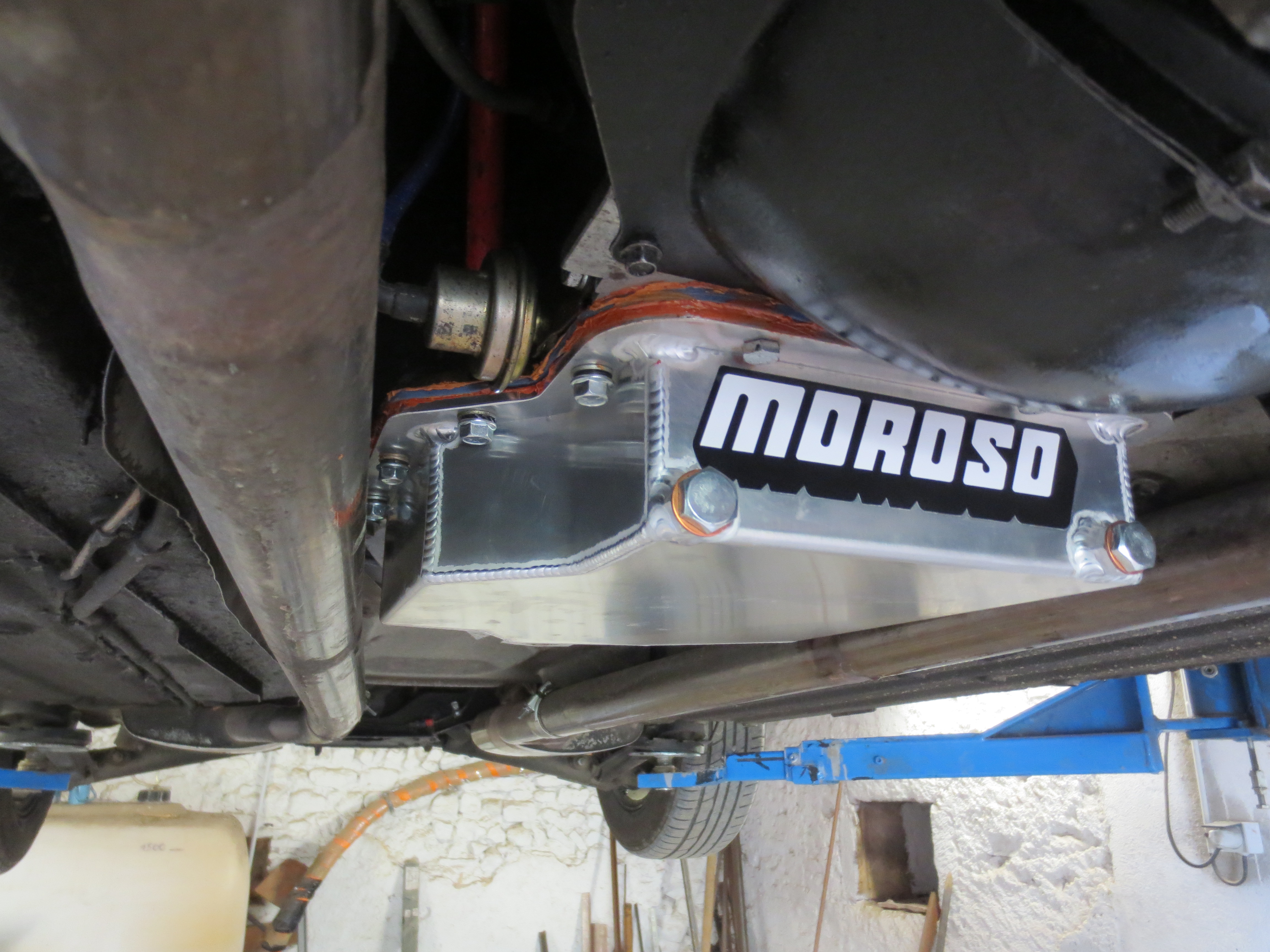

For the OP, here is a photo of the modulator. It is held in by one small bolt on the forward side of the unit, that fixes a small fork-shaped bracket round the unit's base.
Greg

That is waaaaaaay too clean for a V12, you sure thats your car, hahahaha, just kidding mate, well done.
An appreciator of true automobile art, thanks Grant. Taken a few years back, just after fitting my lovely Moroso TIG welded ally deep pan. Nothing like as clean today. I hope you all feel pangs of jealousy and need having seen the twin magnetic drain plugs, AND they are at the down-sloping correct end of the pan!
Greg
loving the look of that Moroso transmission sump.
