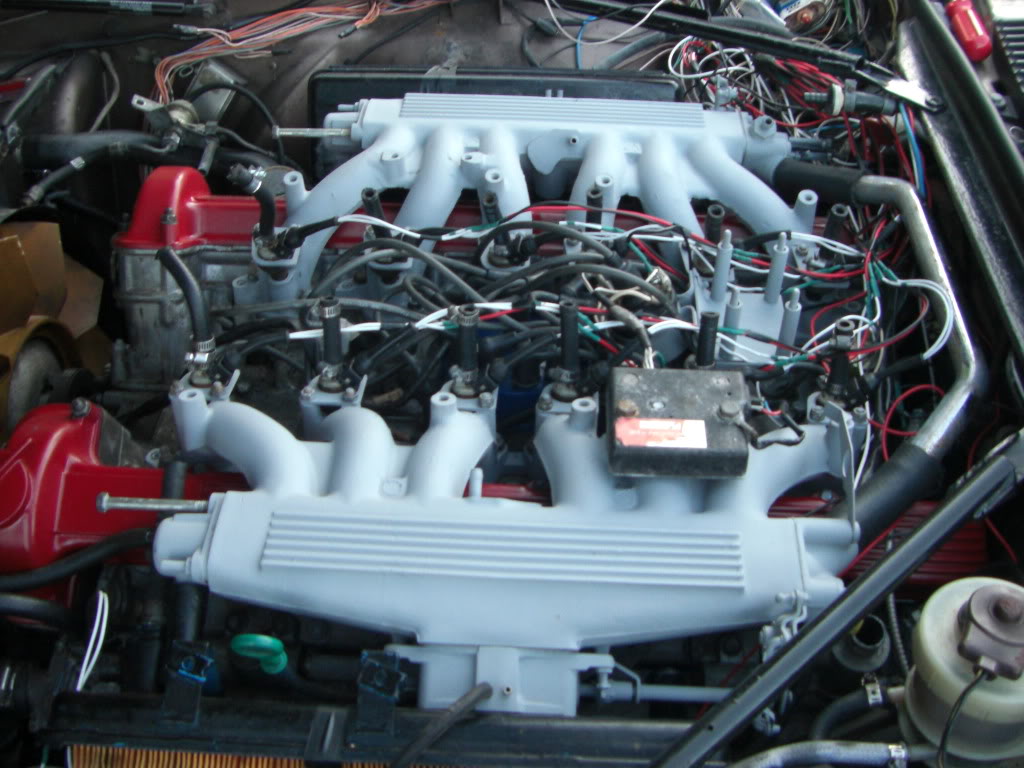

literally every wire under the bonnet looked like this once i got the insulation off.
this is what the rebuilt harness looks like.
Old May 11, 2012 | 08:38 PM
sidescrollin's Avatar
Joined: Jul 2010
Posts: 2,459
Likes: 695
From: Key West, FL
so you got more wire and tacked it onto the old ones and then re-wrapped it and hung it on the fuel rails?
Old May 11, 2012 | 08:48 PM
M90power's Avatar
Joined: Oct 2011
Posts: 1,738
Likes: 70
From: WV
right. i spliced it in, as close to the fender as possible, where the least damage was.
