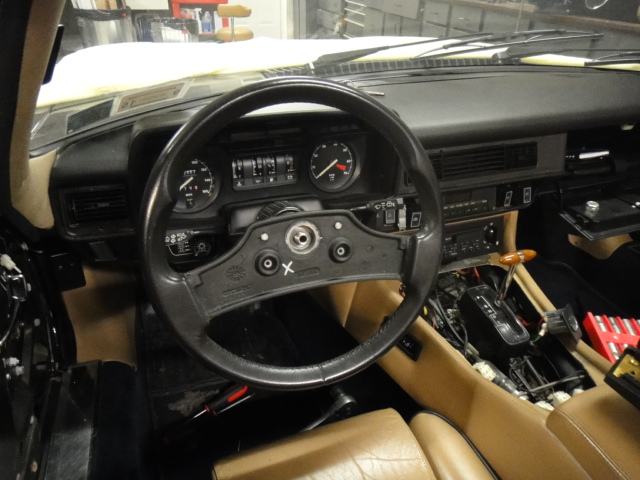

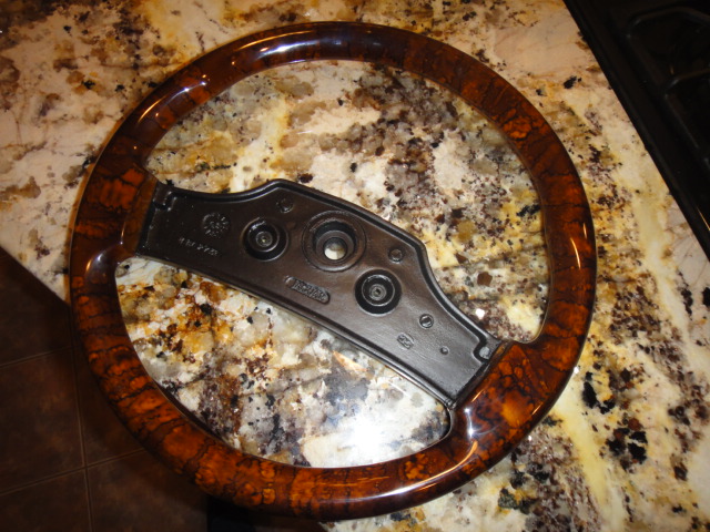

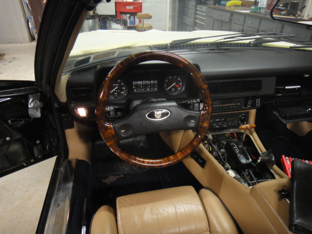

Well, that went well. I must say that it has been fun removing interior trim pieces, door panels, etc. Everything has gone smoothly and I haven't broken anything yet. I wish working on the mechanics of the car were this easy.
The steering wheel came off simply by removing the two screws on the back of the wheel and the horn pad came off. Then there was a plastic nut on the wheel with a plunger that unscrewed by hand and pulled out (maybe something for the horn, I'm not sure). Then a nut holding the steering wheel on. It just pulled of an the new one went on easy.
Here are some photos:

That new steering wheel makes all the difference! What an upgrade over the stock wheel.
Money well spent.

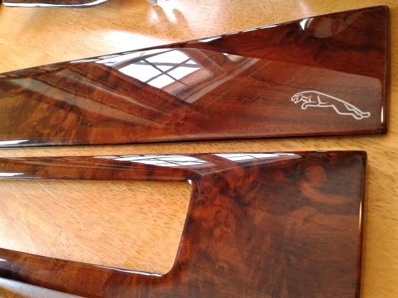

Hi Roger, The O.E finish is not Epoxy, it is a 3 part polyester finish which in a production factory setting is UV cured. If you plan on doing the wood yourself, buy an inexpensive spray gun, 3M mask etc and use a two part polyurethane. Awlgrip makes a very good one for the marine industry, as does ICA America. I've also heard good things about WR-LPU Topcoat - System Three Resins, Inc.. Stay away from anything that is not 2 part, and certainly anything from Minwax

Also check out the hybrid Polyester PF5051. Very user friendly in this hot/humid climate. Hope this helps. ICA North America - Products - Polyesters
