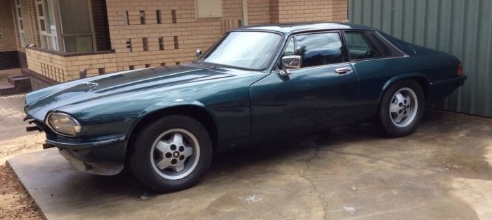

My XJ-Spider project has stalled so I am open to any and all advice . . . plan to graft on a custom made XKR type snout has hit a snag.
Briefly, the plan is to body mod my '78 XJ-S (pic#1) using cues from PininFarina's '78 XJ-Spider (pic#2) but retaining the stock headlights. Work on the snout mould has started . . . shaped from bonnet lip down to wide oval shaped rad intake, deeper than in pic#2 and with splitter underneath that integrates fogs, turn lights and air ducts to front brakes.
Here's the snag . . . the stock forward tilting bonnet/hood will foul the snout unless I either switch the bonnet to hinge at the firewall (my preference, but how?) . . . or make it 4-pin fully removable, perhaps impractical on a road car, but implied by pic of a modsports XJ-S #86 (pic#3). All suggestions and inspirations gratefully received . . . especially from anyone with ideas or success in firewall hinging an XJ-S bonnet.
