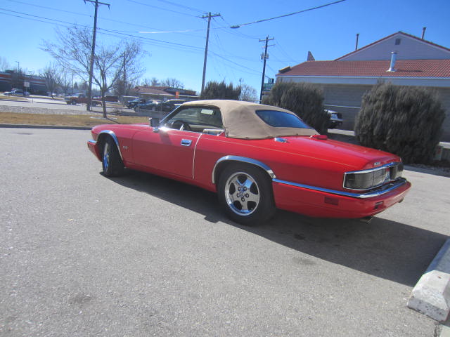

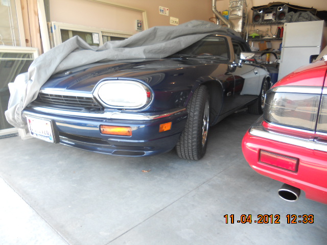

To many there are a few visual things that make the XJS stand out -
The facelift hood bulge, facelift taillamps, facelift bumbers.
Get compliments on all these all the time from everyone that checks out our XJS'
Will 'The Bonnet/Hood' from a 'Face Lift' 4.0L XJS fit a 1989 V12 XJS?-dscn1747.jpg
Will 'The Bonnet/Hood' from a 'Face Lift' 4.0L XJS fit a 1989 V12 XJS?-img_5388.jpg
Will 'The Bonnet/Hood' from a 'Face Lift' 4.0L XJS fit a 1989 V12 XJS?-img_5389.jpg
Attachment 127317
Attachment 127318
Attachment 127319
Your Bonnet/Hood + My 'Gothic' Lights and Front Grill.
That would be the perfect Combo for me.
