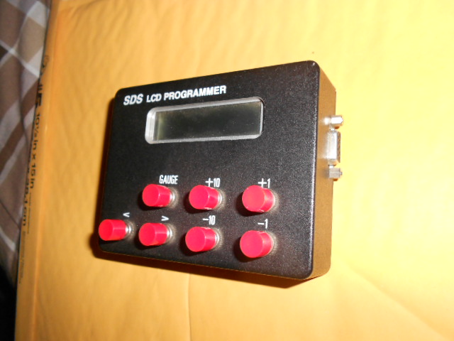

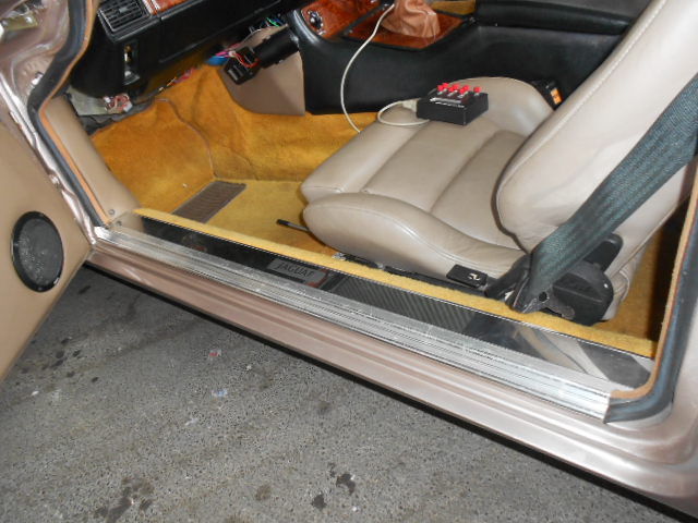

my standalone computer all adjustable , i can set my rev limit anywhere from 1500rpm out to 9000rpm, of course depends on if your engine can take it!
as of now set to 7000 rpm, but after 6500 its over the peak, time to shift
