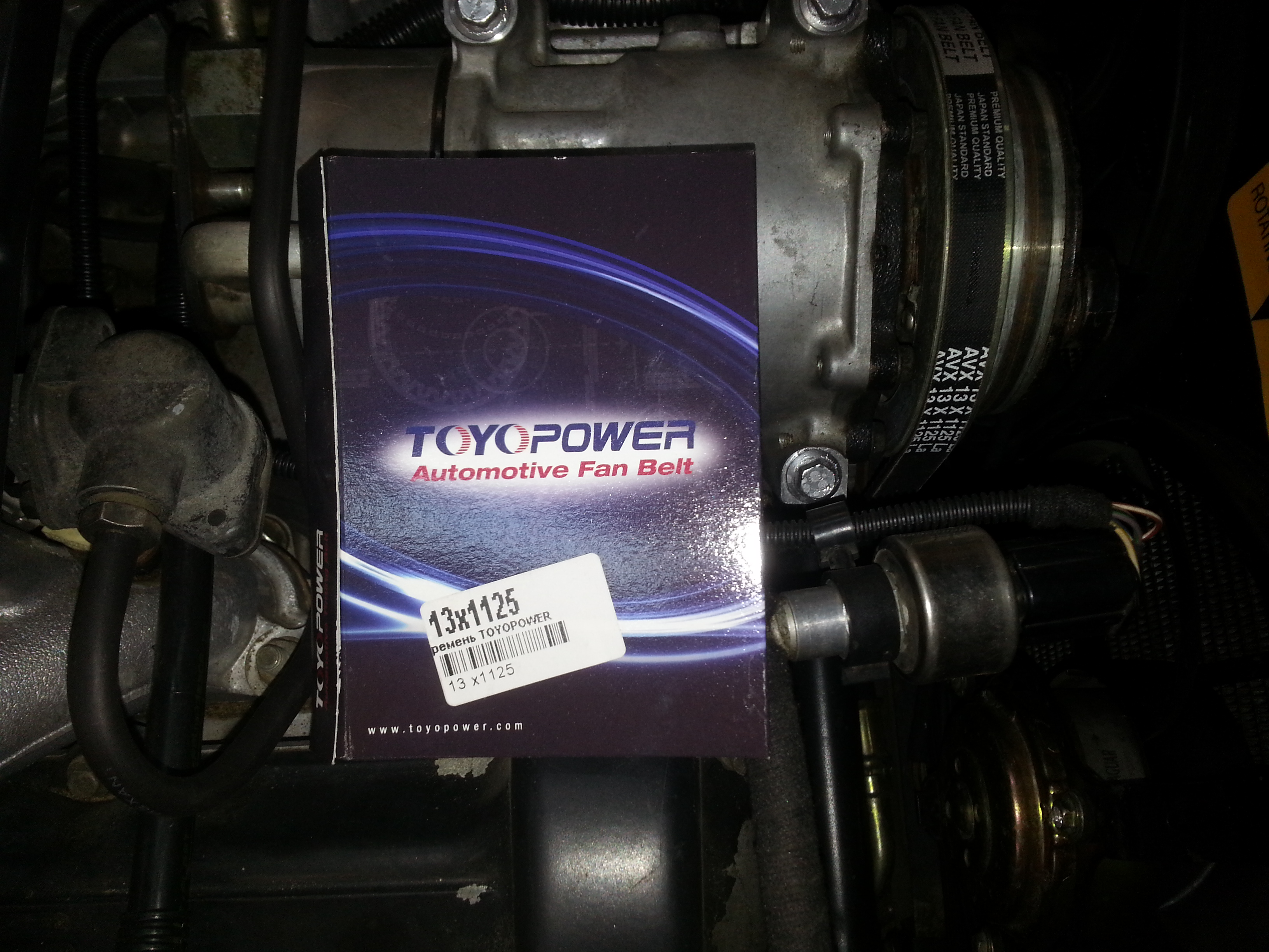

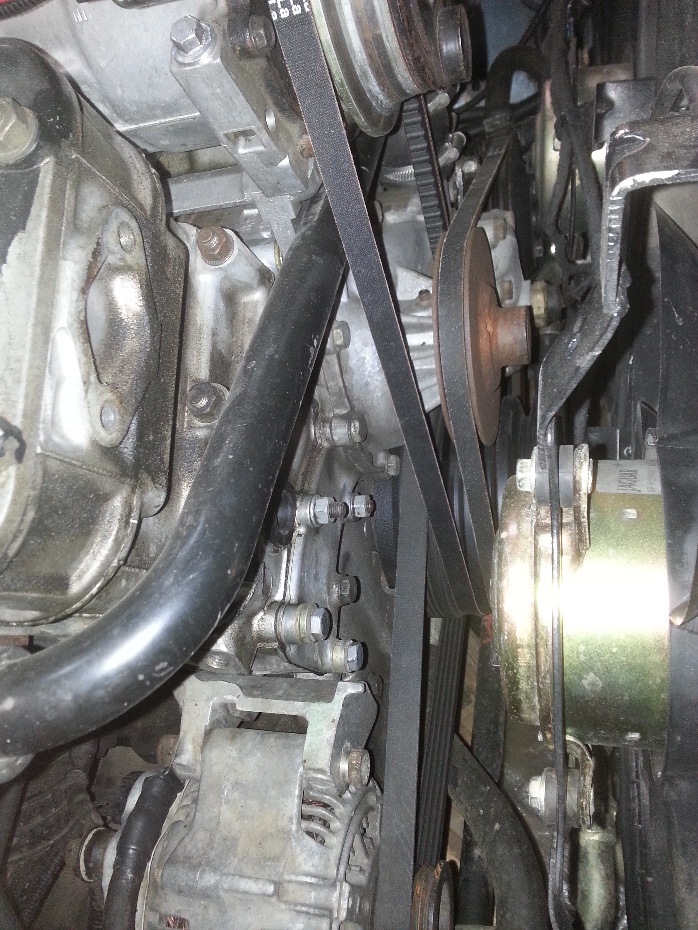

Alternator pulley is from XJ V8. It is smaller for better charge on idle.
Рад слышать русскую речь из далека

This pulley from compressor like on the pics and cutted by machinist. I do not like unused row.

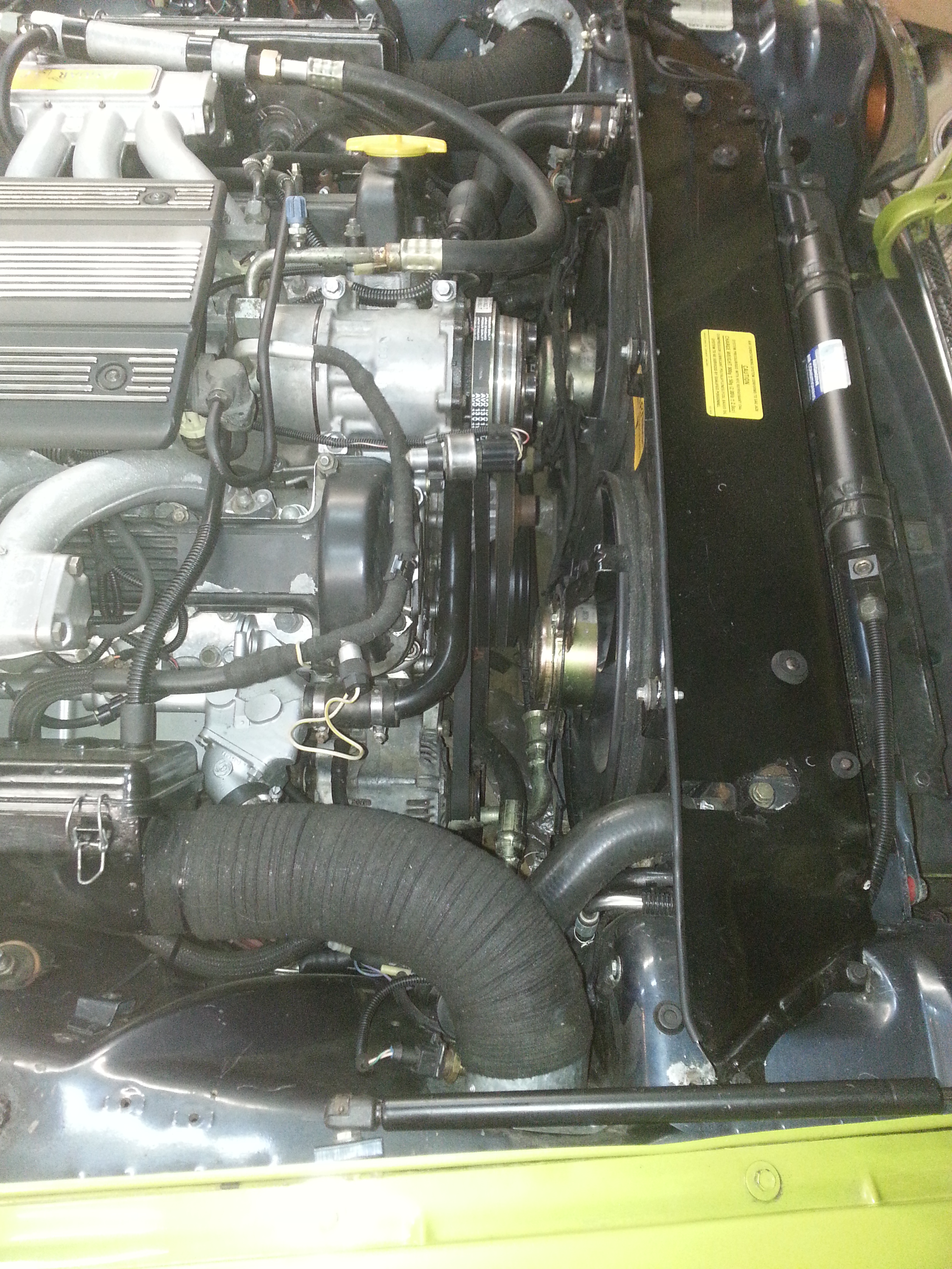

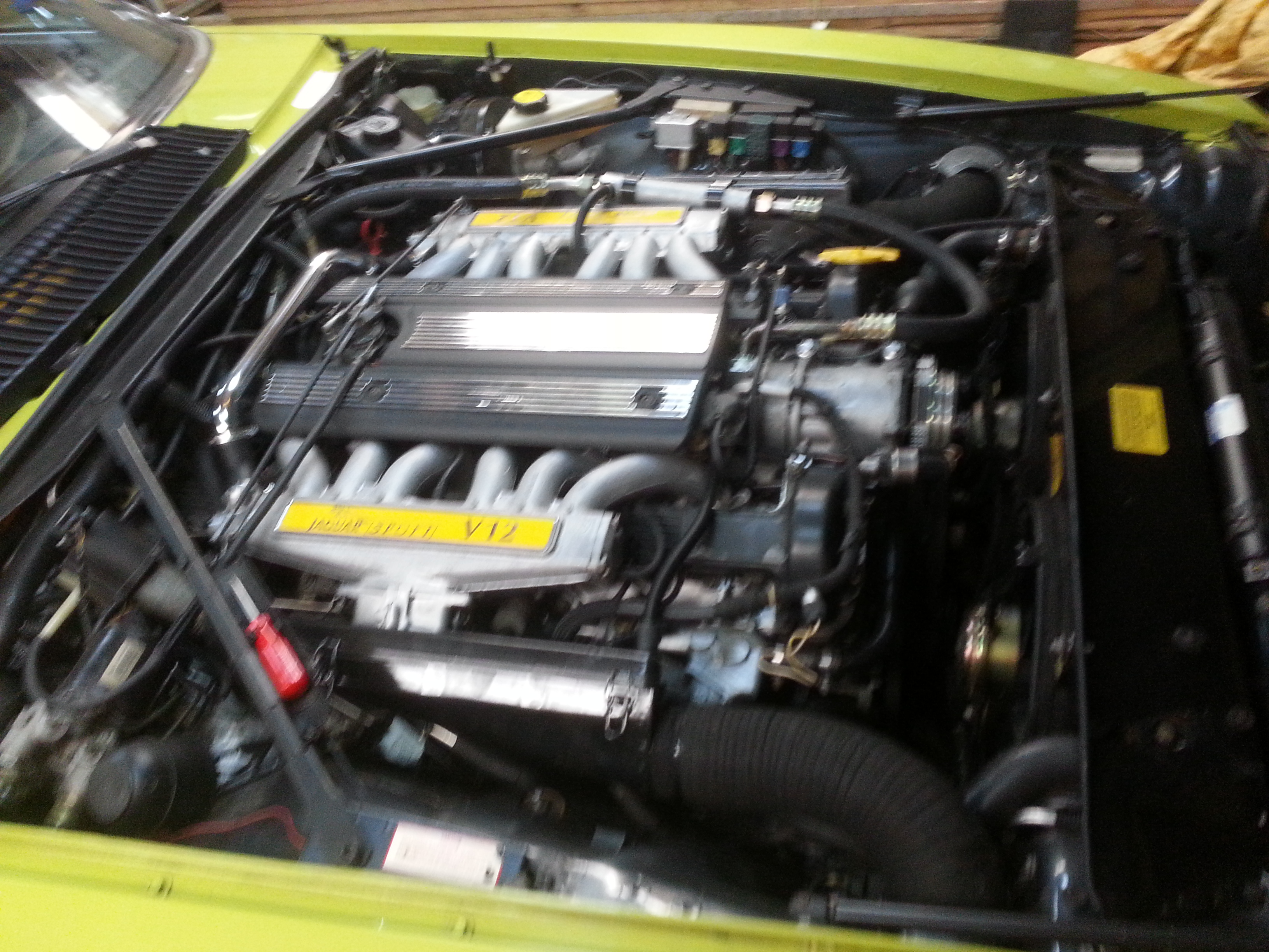

Well New Ht Leads have arrived today so manifolds and fuel rail with recon injectors went on so know to sort out the air con and pulleys

Hi Yes it is out of the X305 But Running Holbay cams the Engine will be Run By Emerald
( Home of the Emerald K6 aftermarket standalone ECU ) this will be linked up to the Gearbox ECU
been sorting out the Air Con and Alternator

well time to finish the Rad and fans Just need to replace the Flaps and wiring
New Bush's and Rad rubbers
Fuel pipes looking at the ones that run from the Tank Under the car there a bit tatty so was wondering if any body had replaced them and if so what with
