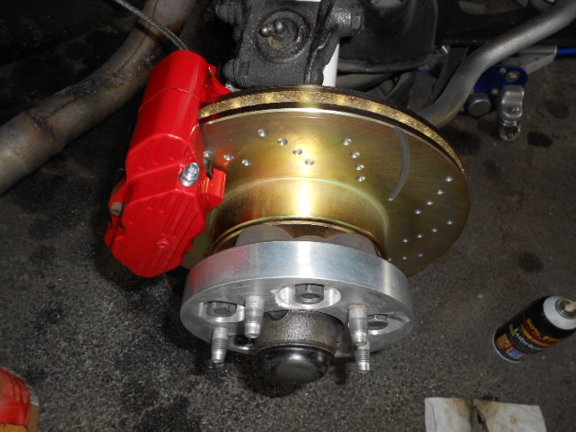

just finished my front brake overhaul.
new EBC Gold rotors slotted & dimpled, new light weight 4 piston calipers,aluminum.
new stainless steel brake lines
