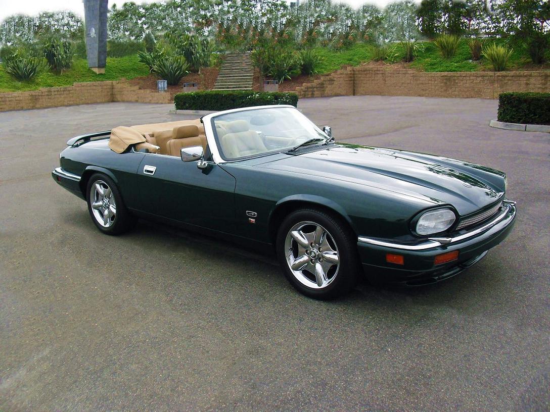

I have the very same wheels on my 1991 XJS.
I mounted 235/50 tires on 8x17 wheel.
I think the 0ff set was 25mm.

No issues with clearance on the hub. Some minor tire rub on rear inner wheel well until I replace the struts and springs.

A. The ideal size wheels for the XJS: 17"
B. Guaranteed fit, other than 1/4" spacers to the front wheels
C. Best of all, hard to find any other wheels that make the XJS look better
D. You stay Jaguar without sweating it for the right looks + correct fitment
E. XK8 Revolvers with Pirelli Pzeros can't go wrong
Attached Thumbnails XJS Coventry wheels-cimg2302-jcna.jpg   XJS Coventry wheels-5-xk8-rims-xjs-less-than-200k.jpg
