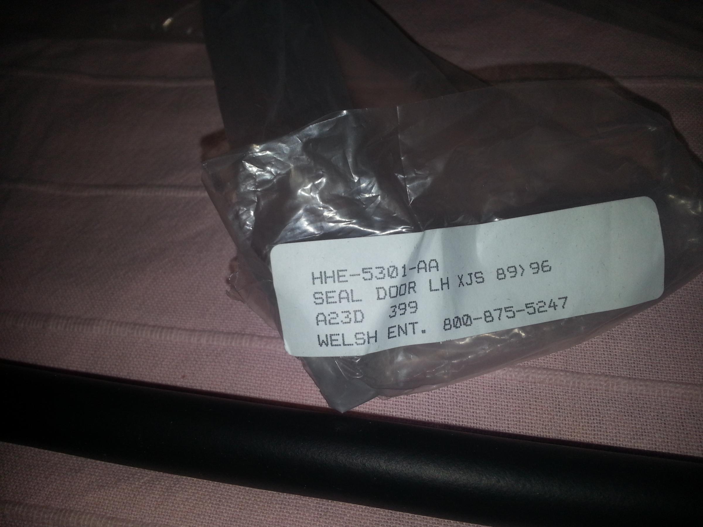

A couple of days ago I recieved an email flyer from Welsh Enterprises,
they are offering XJS door seals.
I have been looking for the last couple of years to replace the LH side which has been in vain. It seems that everything that is LH is impossible to find!
Here is the the link to the site page
Welsh Enterprises, Inc - Jaguar XJS Body Fittings Front Doors Parts.
I checked Jaguar Classic Parts and they are still unavailable.
They are $49.95 so I orderd a LH, we will see how well they fit. The last Jaguar (new old stock) one I saw on ebay went for $185.00.

I received the seals today.
The product seal was peeled off, but from the little remained piece it is obviously produced by APA/URO parts.
The materials are different between the ones for coupe and for convertible, the latter is softer and similar to the genuine one.

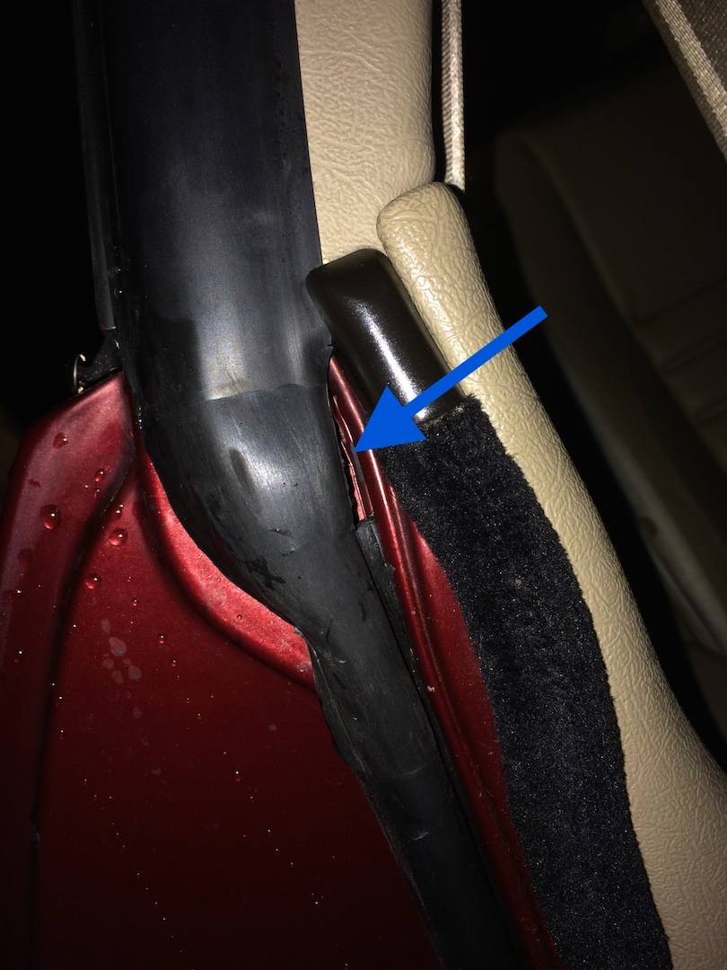

I installed the new seal (maybe made by URO parts)
It is firmer and isn't flexible as the genuine one, so if the position of the window isn't appropreate it will cause water leak. I actually needed to reposition the window position, which was a real PIA.
In addition, due to the firmness of the seal, it makes a small space behind the seal around the gap between the glass and the body.
Please see the pictures attached. It makes wind noise when running at high speed.
I will need to fill the space with something.
So, unless you have any physical problem with the seal, it would be better not to replace it with the aftermarket one.

No, the problem isn't when installing, it's after having installed.
I checked the seal again with a closer look and found that the B post part is a bit too long and that pushes the seal bulge downward, which makes the seal nor fit properly.
It IS a good news for us to have aftermarket seals finally, but I wish they could make even a little better ones.
It is not a problem at all to pay $100 if they are exactly the same shape/length as the genuine one. The cheaper isn't always the better...
Almost all the Jaguar parts which URO parts makes are also made by other vendors, so I hope some other vendors will make better ones some day.

I also received. Looks good soft, lint-flok is well.

I have exactly the same problem with the ones I had from David Manners in the UK recently. The door was catching on the bulge and has now split the rubber. I am going to call them next week to get them replaced
