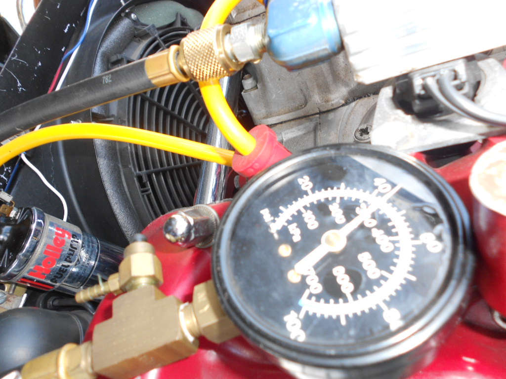

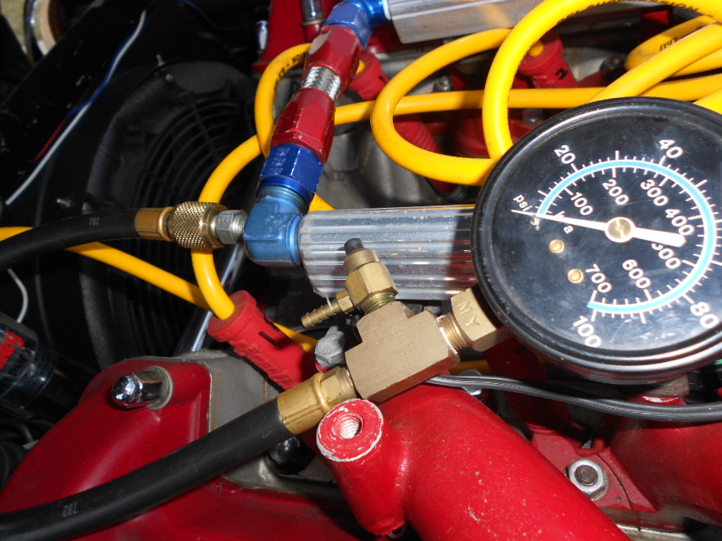

quick pix.
NO rust in my system, NASCAR fuel cell, polypropylene plastic 20 USA gallons.
custom Chinese pump(USA made only lasted 18years) SX aero pump and filter, also SX adjustable FPR, aero lines and ali tubing 1/2" ID.
pic of pressure 45 psi no vac.
i have an adjustable lean or rich mixture control knob on consoul, with AFR gage, aircraft style!
