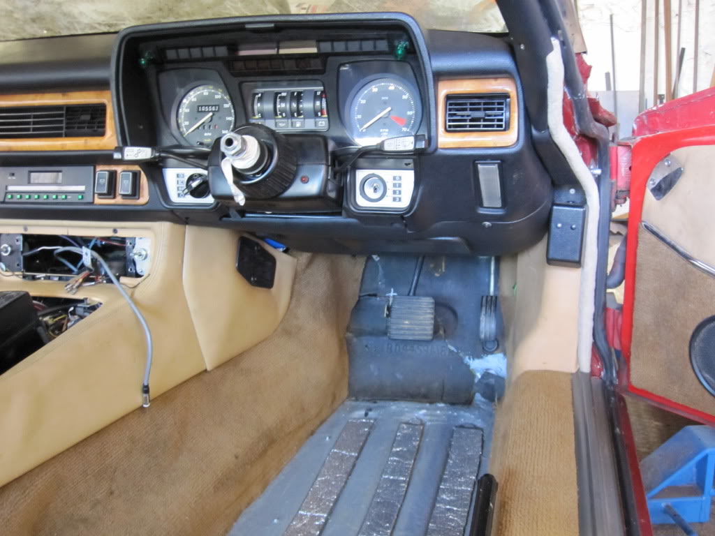

Originally Posted by buddyluv
The warning lights are the upper sockets that use smaller bulbs there are 17 of these, but if they are replaced by LEDs they should be white as the indicator sybols are already printed on colored plastic.
Great pics Bud. All you wrote 100%. I have never changed the row of warning light bulbs, they are tiny, capless 1.2 watt each. And quite invisible in daylight! See here for example and bulb reference number:
EB286 286 Car Capless bulb 12volt 1.2 Watt Pack of 10 | eBay
I would love to have brighter ones, if available, but LEDs would have to be the thing as I am sure higher wattage would melt their tiny plastic compartments. Anyone got any ideas?
What I did do was wire two brighter external green repeaters for the turn signals, in parallel with the standard bulbs, into the end covers of the warning llight strip, as these are both not bright enough, are hidden behind the wheel and easy to forget. See each side in this photo:
Greg

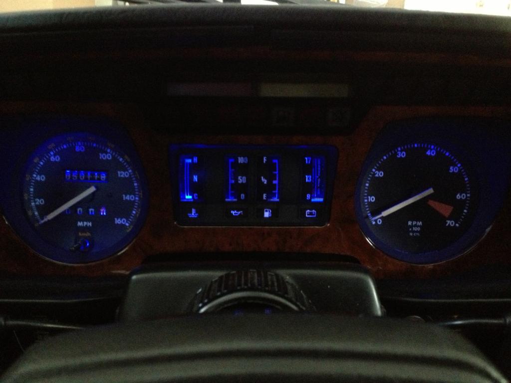

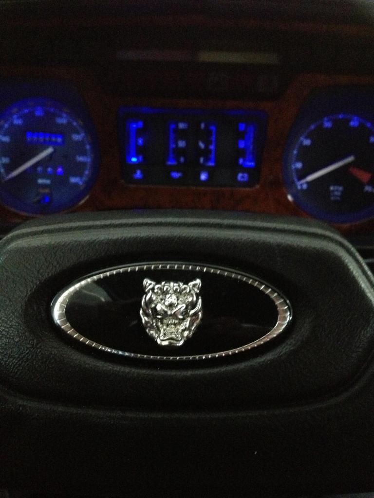

OK!! Just finished the blue led swap out. I removed the black front of the housing and unscrewed the green covers. A couple are a bit dodgy to get out!
Swapped the bulbs for four light blue LED's AND added a 4" strip of blue led to the inside center of each large gage. Wanted to be sure to get enough light.
ONE THING! Don't put back together until you test it. I had 3 bulbs wrong, neg to pos, pos to neg. THe LED's do have to be plugged in one way. So if you test first before you put black front panel back on, you can see which ones are plugged in wrong!!
This photo is in my garage and not totally dark but I can tell it'e going to be AMAZING!!
Now if my computer geek of a brother CAN change the trip computer bulbs for me, It'll be really HOT!

At night, you loose the red sections on the gages but who cares!! It is amazing!!

Instruments look terrific Phil. Could you please explain about where exactly you placed the LED strips?
Also, do they dim,
Congratulations
Greg

I'll post photo of the strip. Basically on the rpm it's between 6 and 9 (on a clock) mph it's between 3 and 6.
No, they don't dim but really not necessary as they aren't too bright.

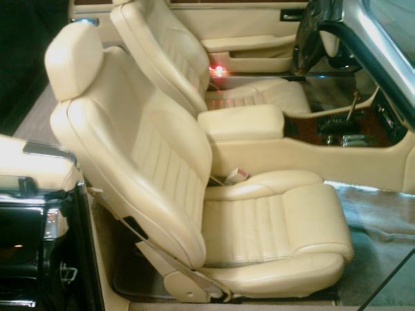

I put white LED strips (probably about 12 leds on the strip) underneath the center console pointing down into the footwells......
It's kind of indirect lighting if you will. It looks quite nice a night. These are activated by the doors opening, not on all the time
Attached Thumbnails Xjs full led instrument swap-sarc-4188-albums-sarcs-92-xjs-v12-conv-309-picture-imag0418-17332.jpg
