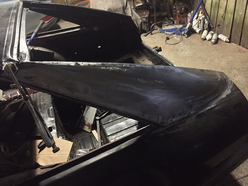

Default C-pillars completed

From: Atlanta
Default Driver side c-pillar

I like the hommage to the XJ-S butresses in C-pillar shake...
Yeahhhh, that's what I was trying to do...
Lol, thats not what I was thinking but you're right! God was working through me.

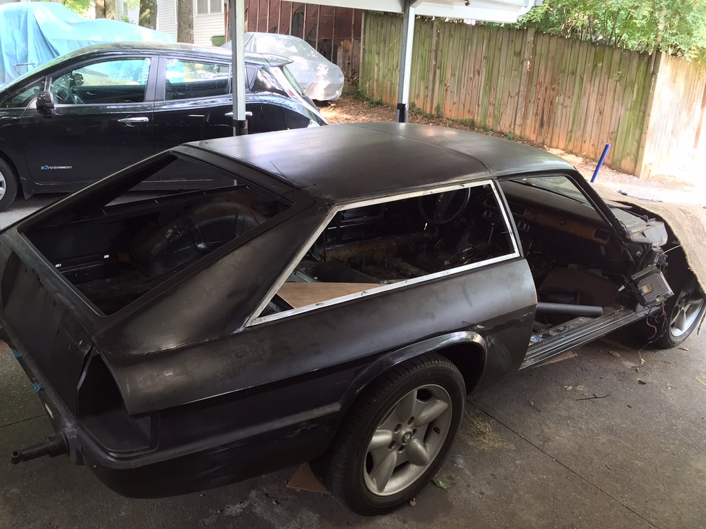

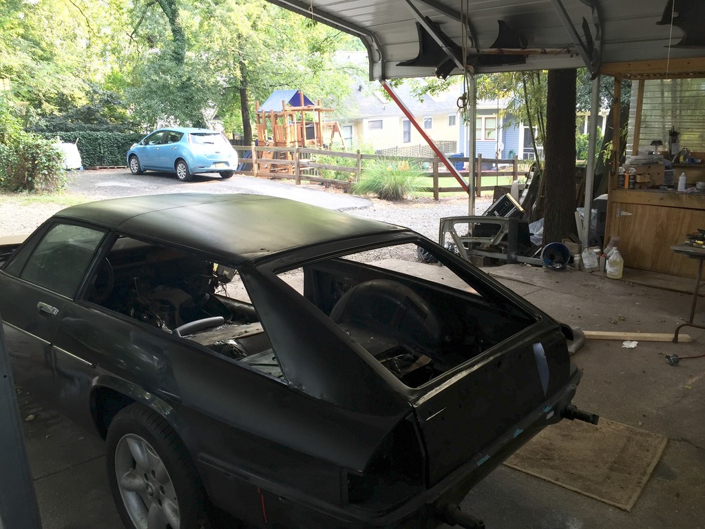

Default Body complete in epoxy primer

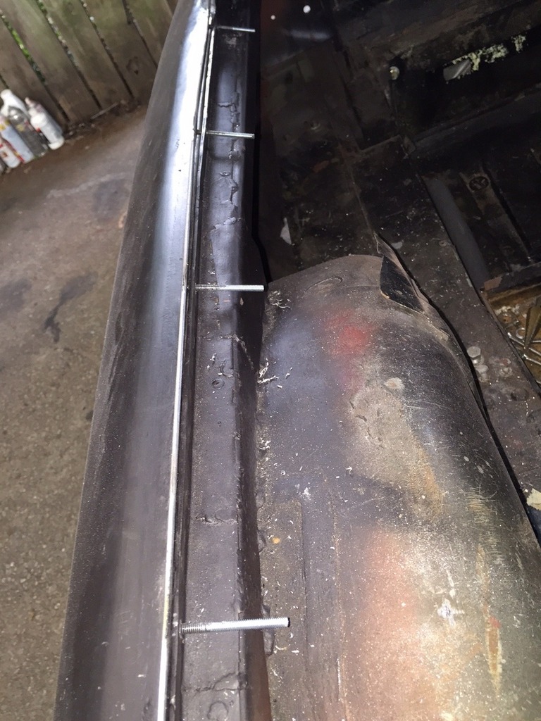

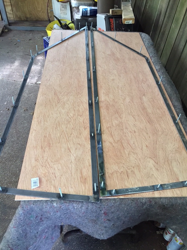

I spent today making the side window trim. The Optic Armor windows will be mounted to the body with either a sealant or 2 sided tape. Then, on top of the windows will be these frames, which serve to hold the window flush and serve as decorative trim
I used 3/4" steel flat bar for the frame. After determining the sizing, I tacked the frame together. Then, I drilled holes through the window frame through the window flange on the car body and inserted small machine screws into the holes and then welded over the screw heads, grinding it off flush.
Old Jul 19, 2015 | 05:31 PM
  #75
bullittandy's Avatar
Posts: 937
Likes: 590
From: Atlanta
Old Jul 19, 2015 | 05:32 PM
  #76
Posts: 937
Likes: 590
From: Atlanta
