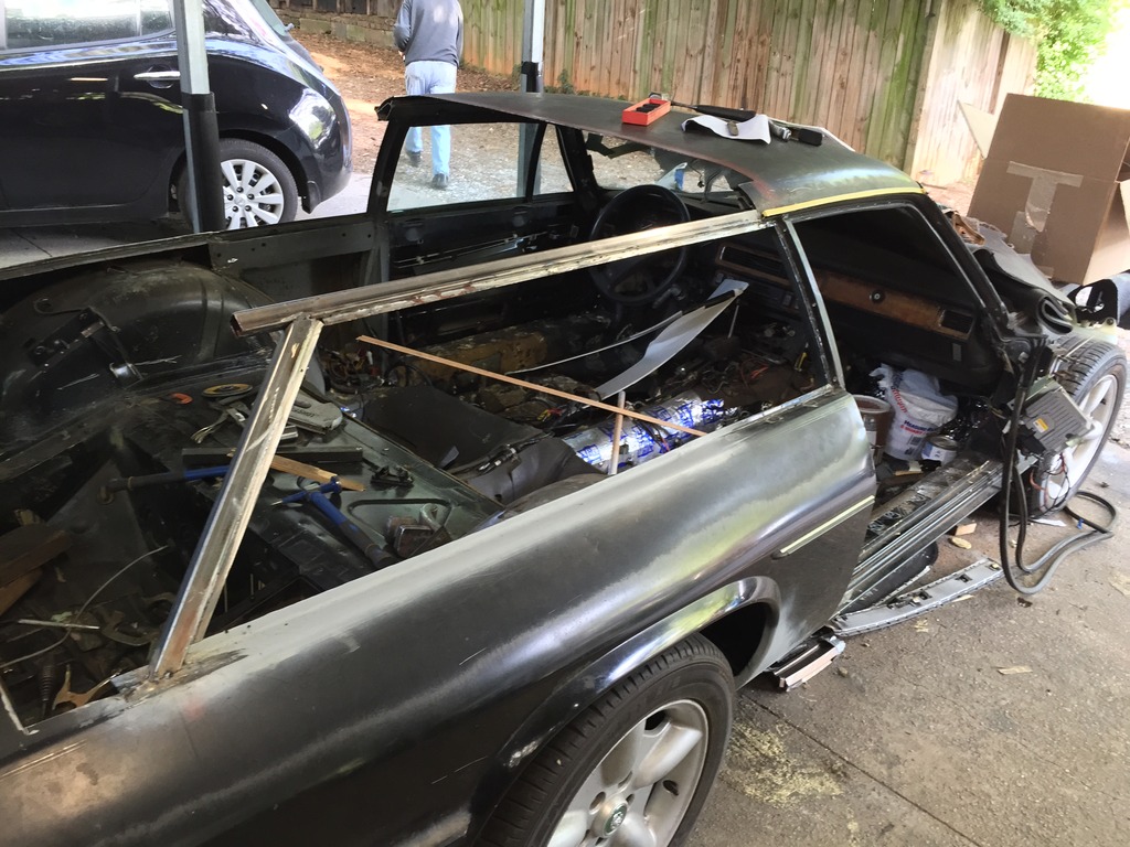

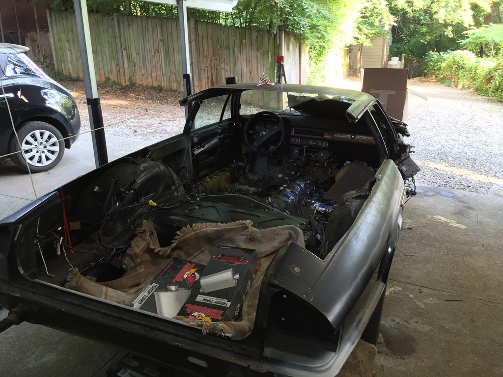

XJS Shooting Brake project. Bought a 88 and 89 XJS and creating a Shooting Brake in the spirit of the Lynx Eventer.

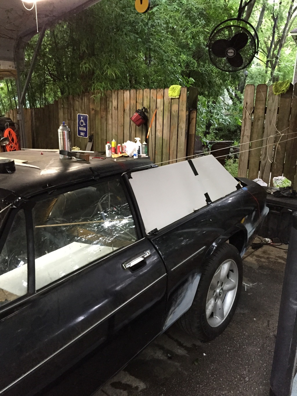

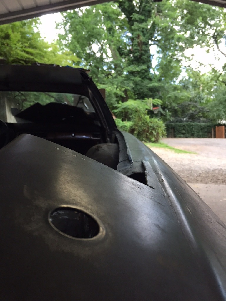

Default Progress! (lower pass window seam welded in)

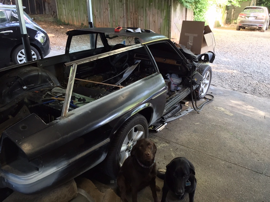

Default Passenger window framed

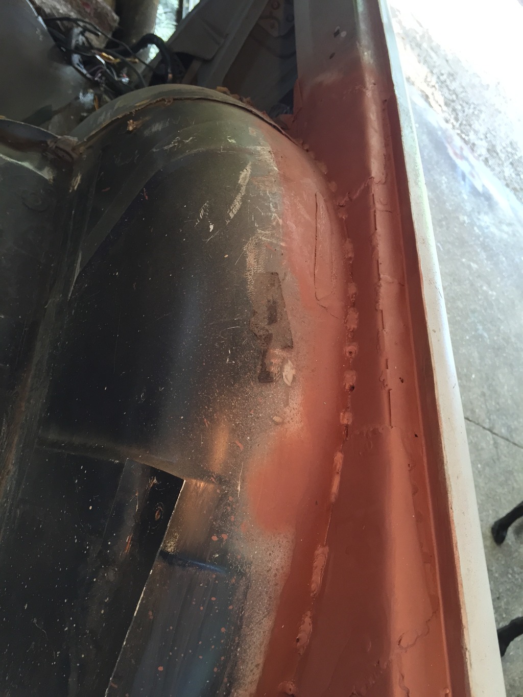

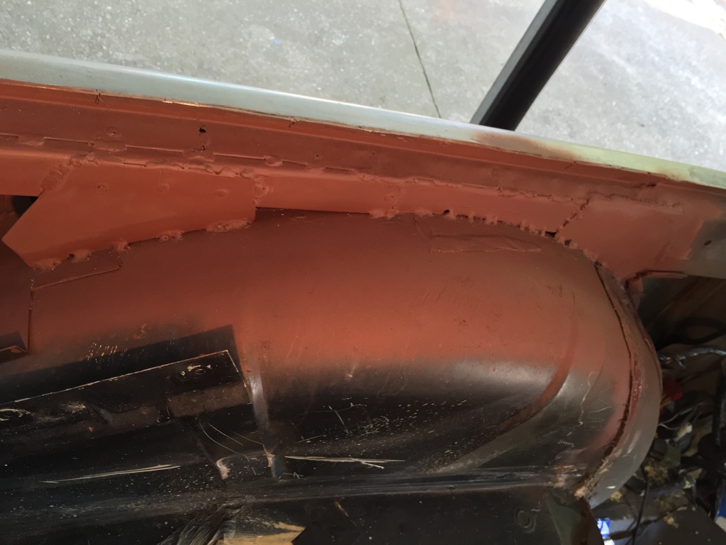

More progress, quarter panel reinforcements welded in:

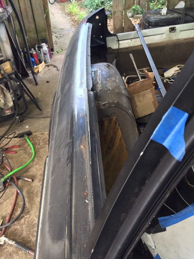

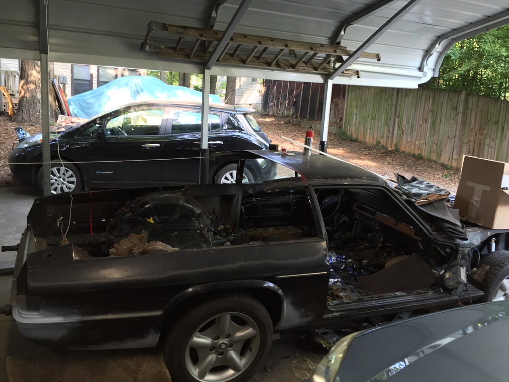

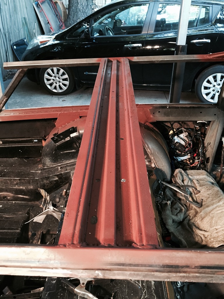

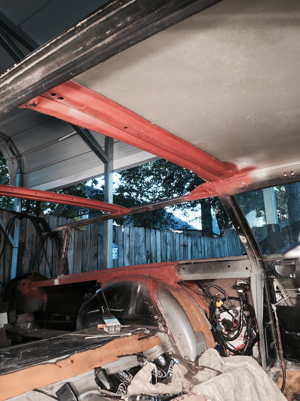

Default More Shooting brake progress!

And here is my favorite view of the car so far...

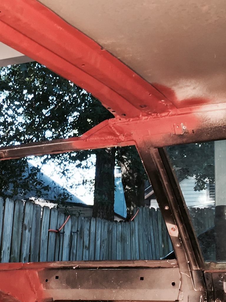

The other day I cut the roof off of a Chevy 4 door pickup to use the roof skin. I cut up a Chevy van for another roof support
The A pillar roof support is from the Chevy truck and the roof support midway through the quarter window is from the Chevy van.
The quarter window frames are made from 1" square tubing with a slit cut through the middle and a piece of mild steel pounded into the groove and then welded. This acts as the lip for the window molding.
The rigidity of the car has increased dramatically as new pieces of steel have been welded in (obviously) but the effect is surprising.
