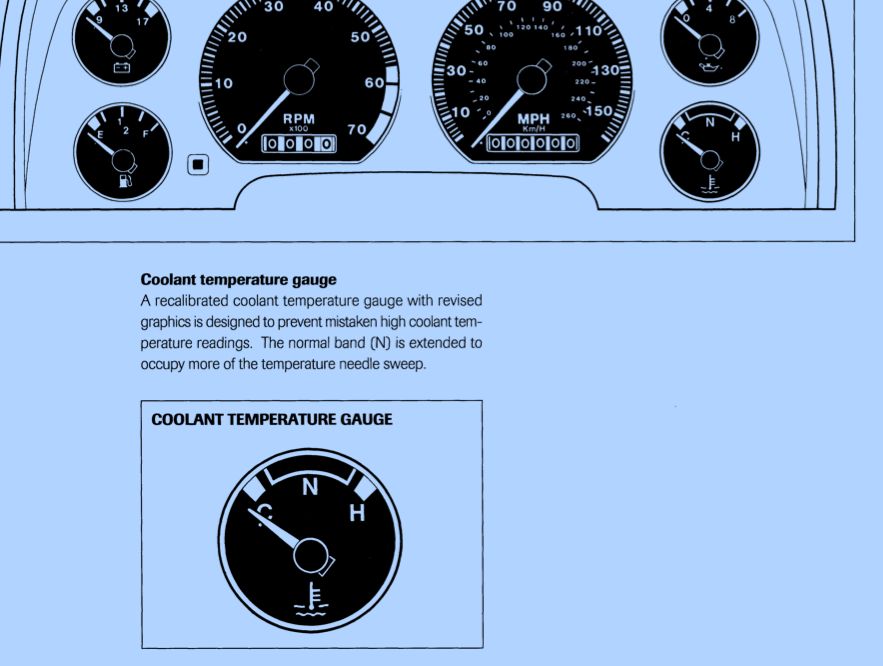

Doug,
Especially for the 6 cylinder facelift cars, it seems this is the reason that Jaguar changed the temperature gauge to show a very wide range for normal operating temps as opposed to a single mark on the gauge. I have attached a excerpt from the 93 update doc and also a pic of my car's gauge. Although my car almost always runs right at N, if I am moving slowly in hot weather say up a steep hill it can climb a bit passed the N. I hope this is normal?

Originally Posted by AllanG
Doug,
Indeed.
Many manufacturers have done similar. Ford did (does?) is that way for many years.
I remember an E-Type review from the late 60s where magazine road-testers commented that Jaguar replaced numerical readings on the temp gauge with the "normal" band to assuage worries about coolant temp. They also remarked, in a beautiful bit of understatement, that ".....Jaguar missed the boat somewhat" by placing the 'normal' band at the higher end of the gauge scale.
Later, on Ser III sedans, a green band was added to the gauge face starting at 90ºC and continuing all the way to the highest reading....thus giving the driver an impression that *any* temperature over 90ºC was acceptable, even 130ºC !
Later still, on X300s, Jaguar went to a temp gauge that simply gives a fixed needle reading ....pointing exactly to "N"......over a wide range of temperatures. On my own car this range extends from 174ºF to at least 210ºF. Lord knows how hot the coolant has to get before the needle move off the "N" !
Yes, normal.
In a perfect world every car would have such an abundant cooling system that the coolant temp could be held at thermostat rating level no matter what the conditions. In the real world, though, most cars don't have that capacity and temps will creep up a bit under some conditions.
DD

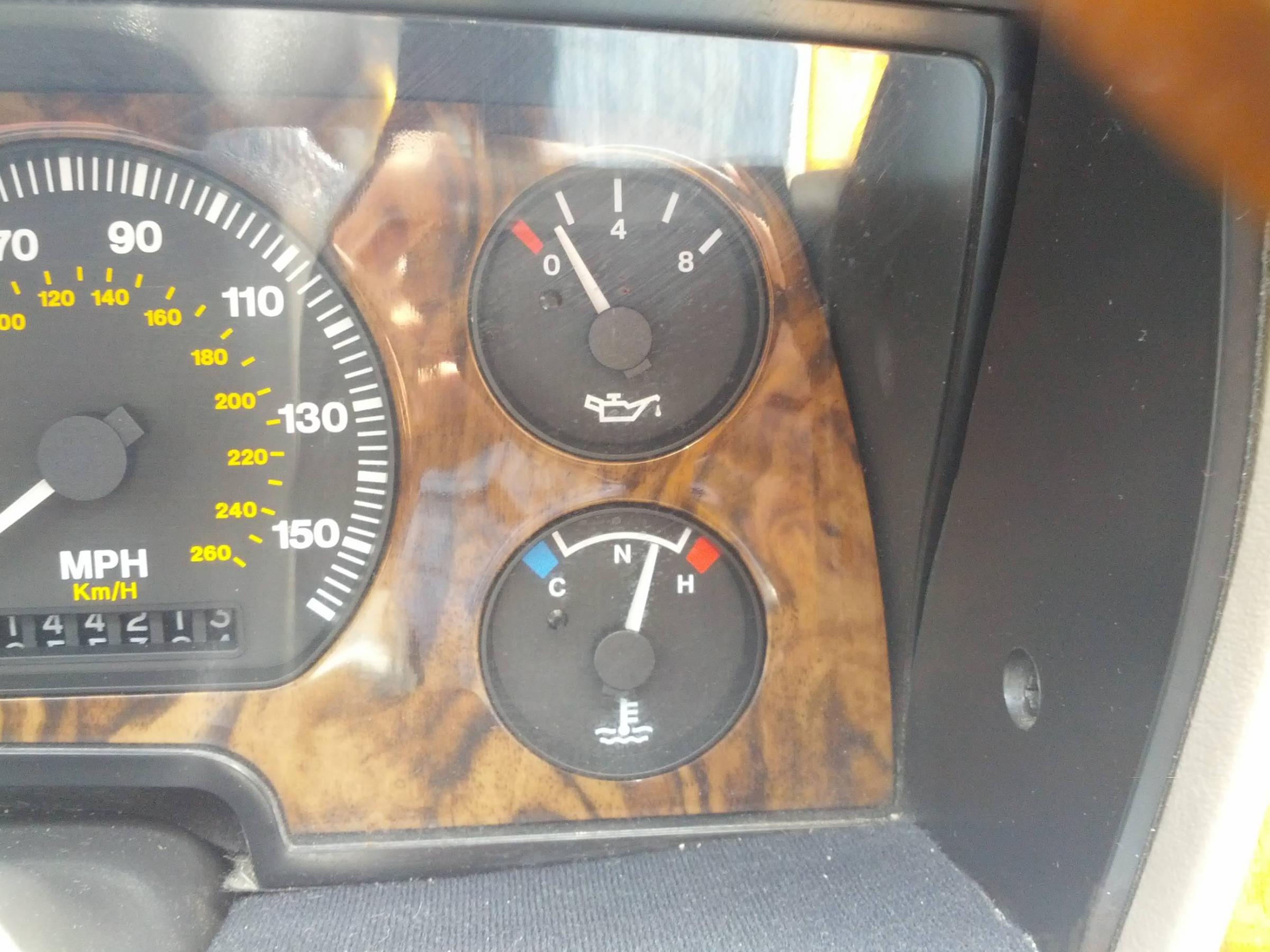

After reading through this thread I now realise I am or was having the same running above the "N" when driving in harsh conditions. The highest coolant temperature I have seen via the OBD was 228 degrees F. At this temperature the gauge was very close to the red, never in the red. The only way I am able to get the gauge back to the "N" is to turn the heater on and hit the freeway. As soon as I am back on the surface streets and I turn on the AC the temperatures will start to rise
With the gauge always way above the "N" I let my mechanic see if there was an issue and he reassured me that the car running this warm is normal in this summer heat(110+ degrees). But still, I get nervous when the gauge is up that high. I wonder if adding an electric fans in front of the radiator will help the temperatures especially when driving in lots of stop N go traffic?
At night when it cool off the gauge will stay at normal.
This is around 212 degrees F. It's usually stays around here, but on some days its been very close to entering the red. 195 degrees F is when the gauge is at the "N".
It seems like everything is working fine electrically, perhaps it is just the fact that your daytime temps are so extreme. Still it wouldn't hurt to have the radiator cleaned and flushed. Or possibly looking into getting more airflow via higher throughput or additional fan?
I think you are a poster boy for why Jag changed the normal mark to a wide range
