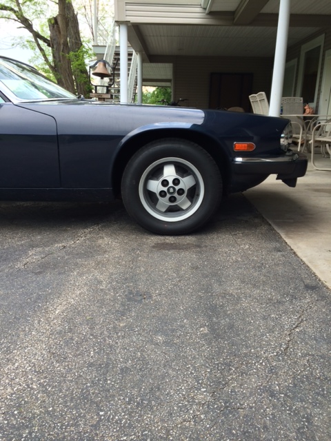

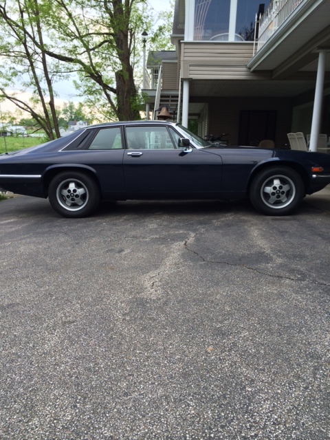

I decided to go with 225/60 15's. I got a set of Fuzion tires out the door for less than $400.00. They are 96 load and H speed rated. There was no noticeable difference in the ride but I was replacing BFG radial T/A s that were old and cracking. (Tires that were on it when I bought it). I do not like the smaller tire look in the wheel well. My son is 15 and this will be his car when he turns 16. He likes the look of the smaller tire.
Car was/is a father son project. We spent a year getting it on the road. I didn't want to invest too much in tires because we still have small issues to sort out and I'm not sure yet that a big issue won't occur. 500 miles so far on the tires and no complaints.
I will attempt to add a picture tonight.

I've the same problem to replace tires.
Here in Europe the P600 235/60 R15 is available again, but at more than 300 USD each one, very expensive. But the worst is that it is a bad tire, bad grip, so we are paying a lot for a bad tire.
Going to 225/60 have many advantages: there is much more variety, much better performance tires, and half exact price. Moreover, with a width of 225 is more than enough for the car (especially in 3.6 like mine, but even the V12 had 215 originally), it decreases slightly consumption, and modification of gearing is almost negligible (and not it hurts because originally gears are long).
But there is a problem, and to me it's important: aesthetics. Going to 225/60 the wheel arches maybe look empty due to the loss of height. And seeing picture from Peel86XJS have many doubts, because in fact the wheel is quite small, and clearly detracts from the appearance of the car.
However, if we compare with pictures of Doug’s car, in his car does not look so small. Yes, you notice that are smaller than the 235, but not as pictured Peel86XJS. This is what I don't understand if both they are the same.
More pictures of 225/60 in XJS are welcome in order to better appreciate the visual effect, especially given the car's side profile.

yes, I think you're right about the 215/70...too much balloon, but the 225 may have the opposite defect, too small. I've found another picture of an XJ-S with 225/60, and see again Peel86's picture:
in the XJ-SC, front wheel arch seems to me too empty, right? or maybe are just my obsession...
In my opinion, the 235/60 looks great for the car's size and wheel arches. But sadly it's only available on the poor & expensive Pirelli P600's.
Another size with good look was the 225/65-R15, but it's currently unavailable, discontinued.
Going to 16" wheel is another option, but still more expensive than put news 235/60-15. The 16" Lattice alloys are hard to find and expensive too. More usual is the 16" 5-spoke, but I don't like in pre-facelift models like mine, and the TWR are not among my favourites.
So, to keep my 15" Lattice I've just only these three options: 215/70 (too big), 235/60 (too expensive) or 225/60 (too small?).

Default More pictures
Posting more pics of my XJS for tire comparison. Not the best pics to see how the tires look. I need to get it into full sunlight and take some more.
Attached Thumbnails XJS tire size-photo-1.jpg   XJS tire size-photo-2-.jpg   XJS tire size-photo-2.jpg

Thank you very much, Peel86
Seeing again your pictures I think I'll go ahead with the 225's. Half price, better tires, and yes, they're a little smaller, but looks enough well
P.D.: sorry for my poor English to everyone
