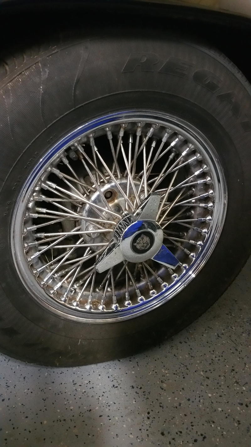

I have aftermarket wheels, 70 spoke I believe. I haven't counted in a while. Here's a picture:

Went to the garage and got a picture:
Checked the spare too, they're Dayton 70 spokes. I measured and rim to rim it's 8.5" wide.
Thanks for the thoughts, if the BFG isn't anything special I would probably go with the Goodyears based on my experience with them and the lack of white lettering on the side. That doesn't thrill me about the BFG.
Anyone have experience with the Pirellis? Or any performance tire at all on a 15" rim for that matter? I like these wheels and would like to keep them, so I'm stuck with a 15" tire.

Im sure you noticed that a bolt is missing.....LOL
I do indeed. The short story is that there was another owner between when my parents (the original owners) sold the car and when I bought it back from him 6 years later. The only thing he did with the car was park it out in the field to let the paint fade, let it rust a little more, replace the front tires with some crap ones to let it sit (presumably because the others went flat) and (apparently) break off a few wheel studs! My failed patch job on the ignition harness was still under the hood from where I had tried to fix it previously before the car was sold.
bhamilton, That's good to know that there's an option in the 215/70r15 size, I thought that I had to go with the wider Pirellis to get where I wanted to go with the speed rating. I looked at the generals on Tire Rack as well and was a little surprised with the ratings. I've put nothing but Goodyear tires on my cars to date and the comfortreds that I have on my sedan have lasted me for at least 60K now and are still going strong, so I'd be hard pressed to steer away from them unless it was for more performance. That's probably what I'll end up going with unless someone here has had experience with those Pirelli tires; I don't want to take a shot in the dark for $1,100 in tires if I don't have to!
