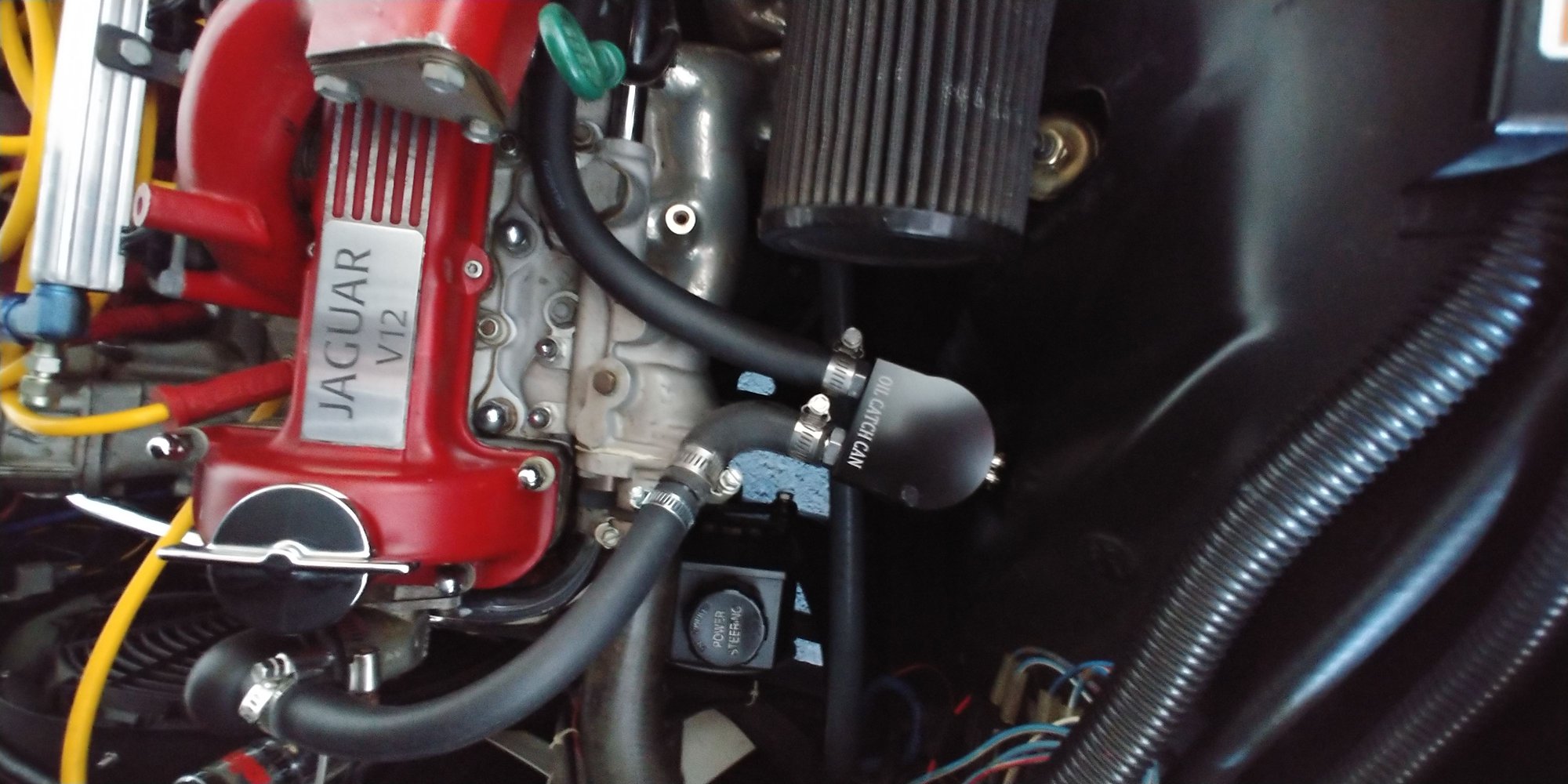

pic of my oil catch can off the rubber knob at front of cam cover, goes under the manifolds vacuum fitting , and joins the big rear tube together!
no valve in system , just a 1/4" hole restrictor in the knob/pig snoot!
keeps a vacuum in the crankcase , to help reduce oil leaks , especially rope seal engines!
BUT engine response is better (i have no idea why) ?

Very interesting..
I am going to look into this more. Especially since you say it helps the engine be more responsive.
That is a great looking engine you have. Expertly detailed.
