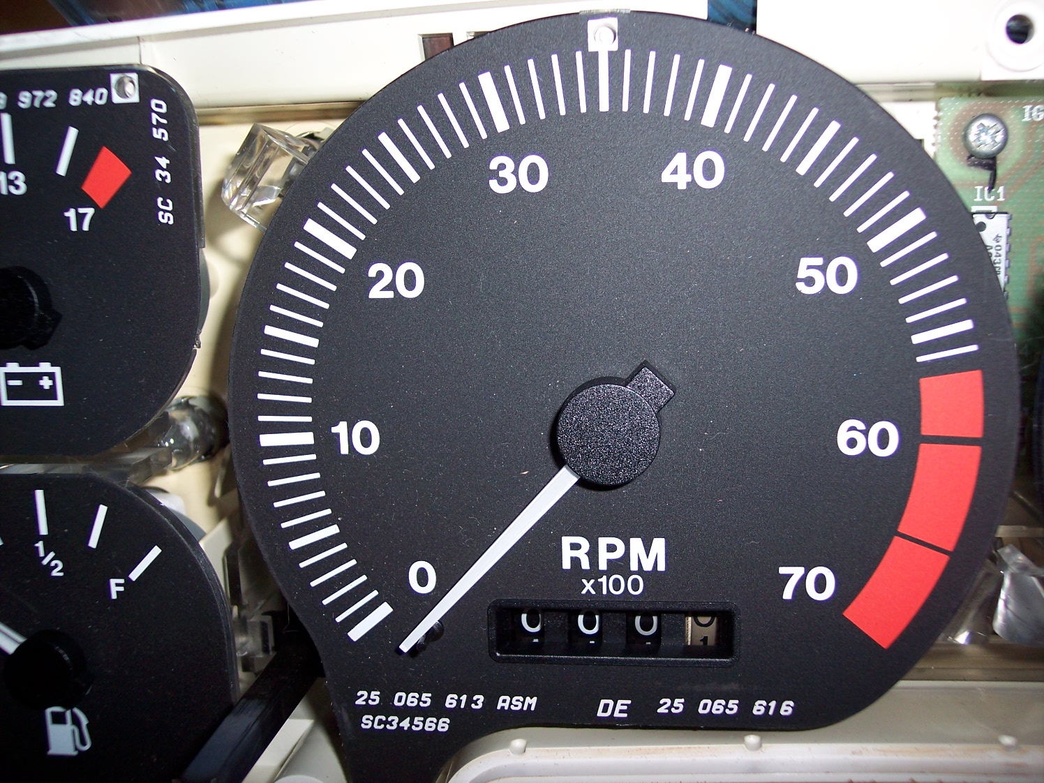

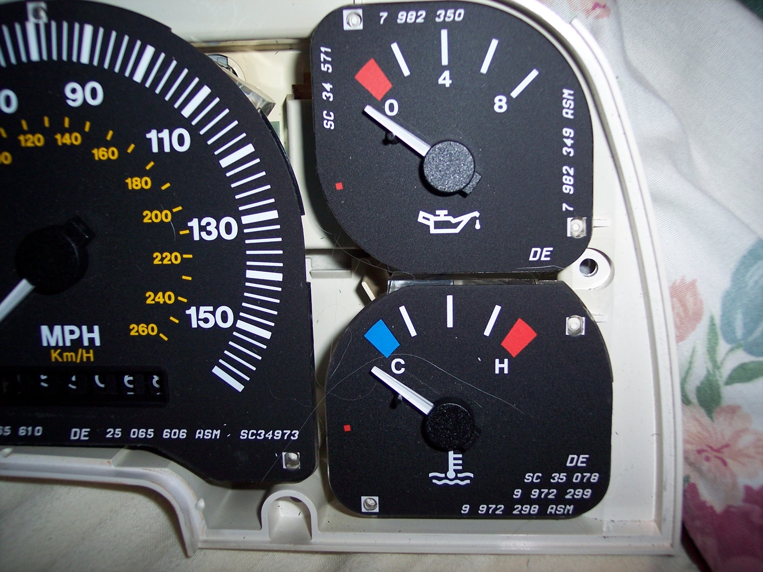

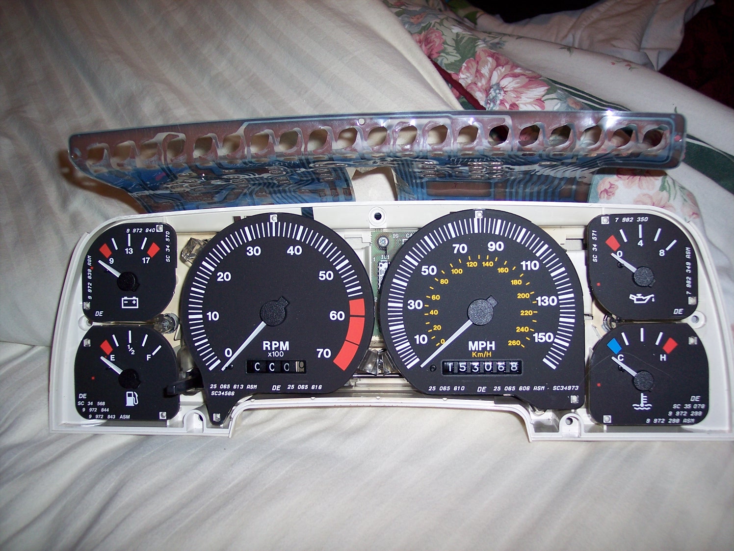

I have a complete instrument panel for a XJS with all the gauges. See the photos - attached. Fits (v) 179737 to (v) 226645. This panel came from the UK for my XJS. Mert
Attached Thumbnails Yet another Speedometer question-100_2975.jpg   Yet another Speedometer question-100_2976.jpg   Yet another Speedometer question-100_2977.jpg   Yet another Speedometer question-100_2978.jpg   Yet another Speedometer question-100_2979.jpg
