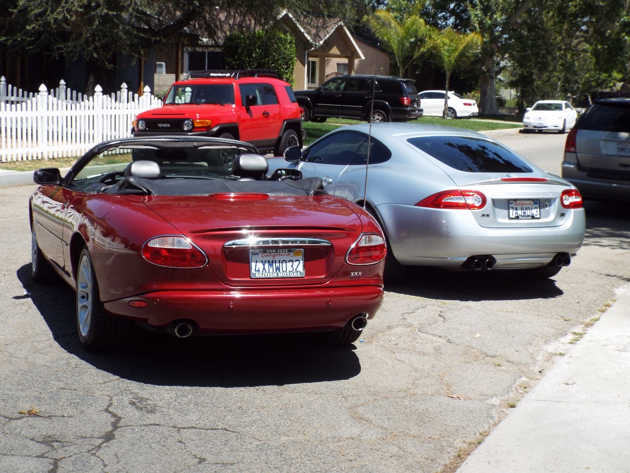

Hey Brittania
I essentially have the reverse of yours and your wife's cars, I have the Carnival Red 2002 convertible (which is essentially the same color as Radiance), and the Silver 2010 coupe. I like both of their "*****."
