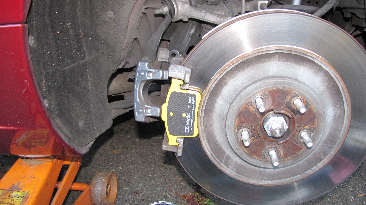

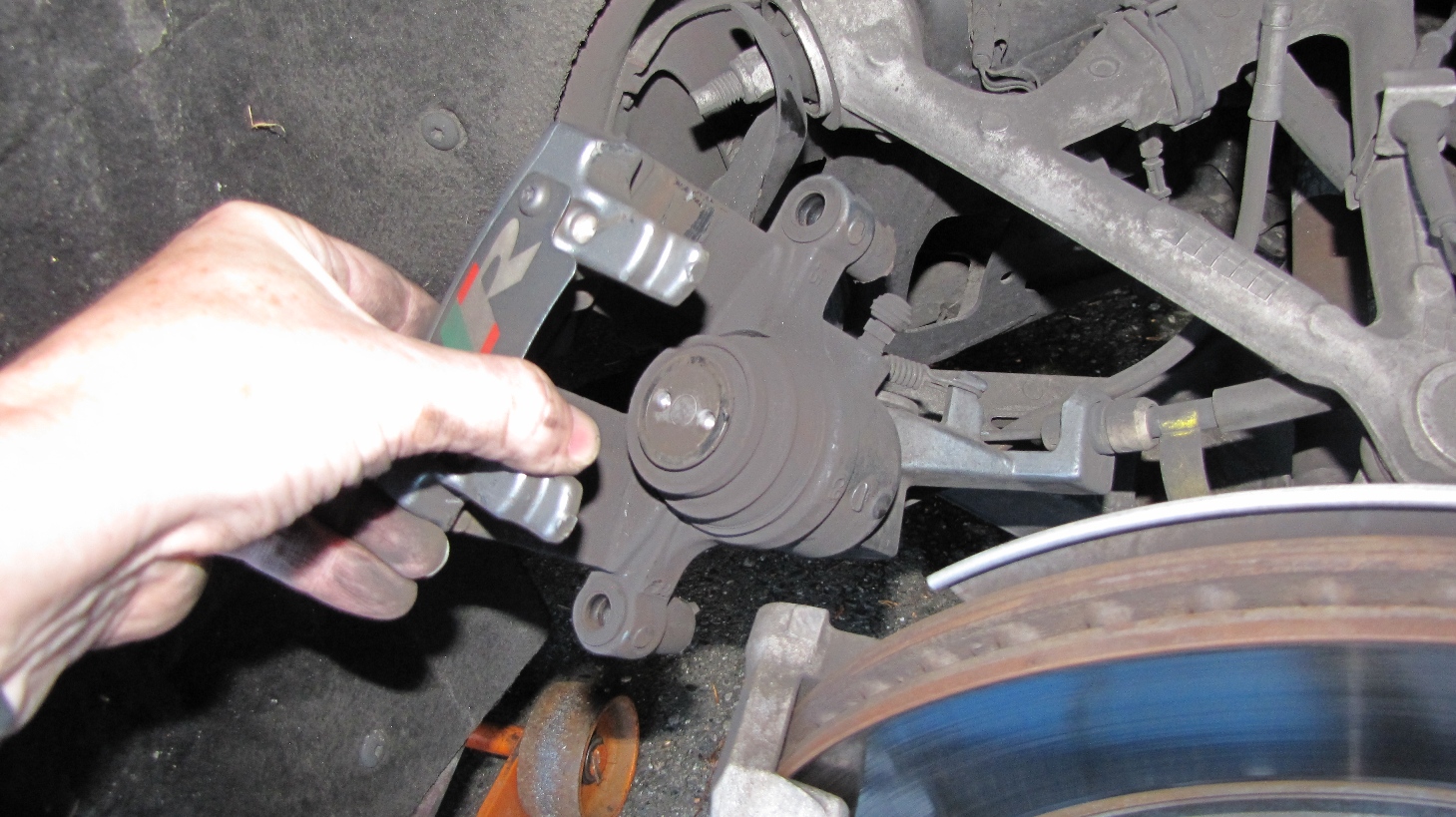

I have replaced pads on both my 07 XK and my 2010XKR.
I had no problem pulling the caliper off the pads with the EPB disengaged. I did not replace my front wear sensor, as it was untouched, but my rear was shot($60).

Attached Thumbnails 13MY Brake Pads and rotors replacement-img_9290.jpg   13MY Brake Pads and rotors replacement-img_9304.jpg
