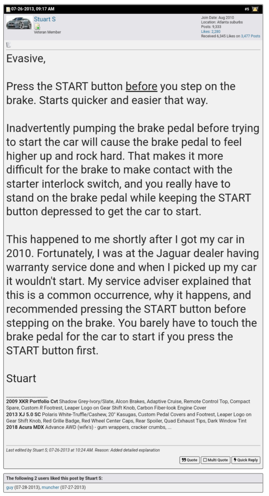

Here's my post from 2013. It's how I've always started my XKR, notwithstanding the Owner's Handbook to the contrary.
https://www.jaguarforums.com/forum/x...t-start-99436/
And we are thankful for it, it was great advice! Use it every time (except in my Lexus, it poo-poos that method).
