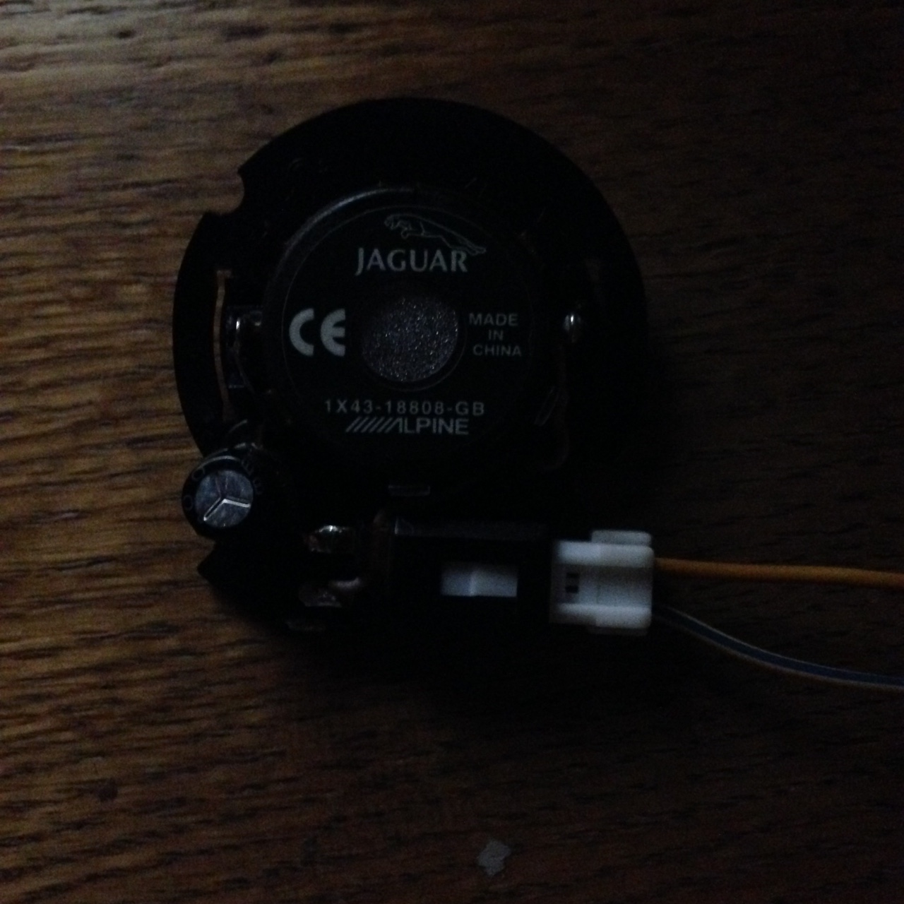

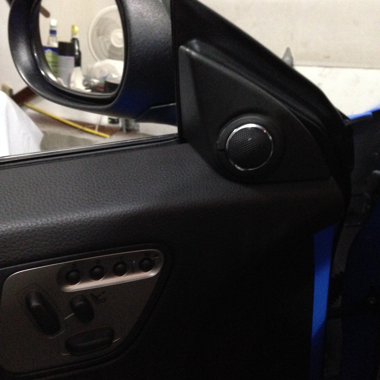

Default speaker upgrade tweeter only
I replaced my Jaguar tweeters with these Infinity ones today. Worlds of difference in clarity and depth which allows more volume without distortion. I used the crossovers that came with them. The crossover fit right down in the opening of the door card. The speakers fit nicely into the existing trim ring. But if you look at the large pic you will see the slit in the ring is expanded a bit on the LH side since the speaker is pushed through. I am worried it will stress and crack like that so I am going to just set the ring on the speaker and bond the speaker edge (which is encased) to the inner ring in some semi-permanent way. Then the ring will be closed. If the speaker ever blows I may need a new ring I suppose but I suspect that will be a long time from now.
https://www.amazon.com/gp/product/B0...?ie=UTF8&psc=1
Infinity Kappa 10.11t 3/4" soft dome tweeters at Crutchfield.com
Infinity Kappa 3/4" Soft Dome Tweeters-Pair (Black)
3/4 inch Flush or Surface mount Car Audio Tweeters (Pair)
RMS Power Handling: 5-50 watts | Peak Power Handling: 150 watts
Impedance: 2 Ohms
Top-mount depth: 3/4"
Cutout Diameter: 1" 15/16"
frequency response: 3,500-35,000 Hz
sensitivity: 93 dB
Electrical diagram here: section 16. Thanks Jimbov8
https://www.jaguarforums.com/forum/x...xk-how-121629/
If I read it correctly there is a white/blue wire (positive) and a yellow wire on one tweeter. The other has a white/green (positive) lead and a red/white lead.
