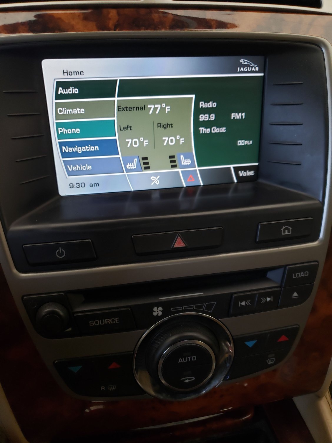

I have tested all the fuses I can find. This is a new purchase for me so I have no history on the problem. The touch screen works just fine. All controls below do not. So no home button no power button no radio or eject. Even though they work from touch screen. Hazzards do work and there is power to the cigarette lighter below.
So all buttons below screen

Sounds like a loose connector in the stack. You could remove the center bezel and take a look, maybe unmount a couple things to take a look behind. Not really that difficult to do, I've done it myself a few years ago so I don't really remember the procedure, but there IS a Workshop Manual in the Sticky section on the X150 forum.
Course, it may also be a fuse. Those are also listed in the manual.

So i pulled the unit out and plugged everything back in still nothing. Perhaps I need a new unit. Strange this is it all works from the steering wheel controls.

OK please just respond yes or no to whether each of these are working. They are different systems so bear with me. There is a long thin plug under the CD changer that can come loose and it's easy to miss if you don't know what you're looking for, especially if you're looking from the top. Please reply to the operational questions below and you may have to take the center stack out again and snap pics
Screen on/off button -
Flashers - working
Home button -
Radio on off button -
Radio on off volume -
Source button -
Next track -
Previous track
Eject -
Load -
Temp control Drivers side up/down -
Fan - manual -
Fan - Auto -
Temp Control Passenger side up/down -
Edit: the connector I'm referring to is under to CD stack is IP061. It's a 10 pin connector that feeds many of those functions, although it also feeds the hazards which you say is working. IP061/10 is the power feed pin on the connector. It comes from fuse 21 in the AUX junction box which also feeds the integrated audio module and information and entertainment control module .
