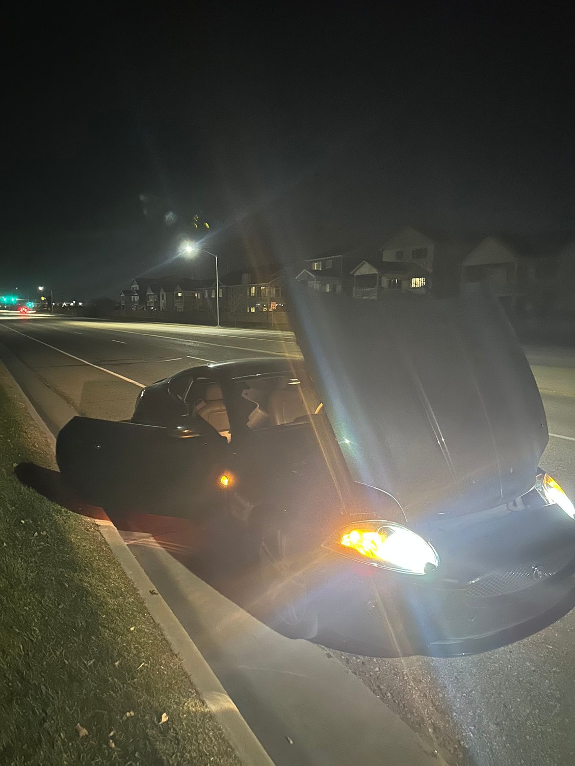

Well it's 2025 and I think I may have a similar problem. I have a 2008 XK N/A 4.2. I turned at an intersection and a few hundred yards down the road the car cut power completely. Car was low-ish on fuel ~1/8th tank. When I went to restart the car immediately after it died I had the same symptom as OP. It started then would chug for a few seconds and eventually die. After trying many times, giving it throttle as well, eventually the battery got too low and wouldn't crank at all. To me this still points to fuel starvation. Luckily, I was close to home so we just towed it back.
After I got it home I disconnected the battery terminals because the hazards were permanently on (limp mode?) and I needed them off. Unfortunately after doing this the check engine light that came on when the car stalled was now gone. I borrowed my friends OBD 2 scanner and no codes were stored.
The only battery/electrical issue I noticed was a loose cable on the positive supplementary terminal (where the trickle charger quick adapter connected to). This explains the trickle charger throwing an error and the battery being a bit lower than usual from not charging correctly. This is the only loose connection that I noticed and I have since checked most if not all main grounding points for the car. I don't know if this is enough to deem as the culprit just yet.
Here's the curveball: After the debacle, I got it back on the charger overnight, we added maybe another 1/8 of a tank from a can, and the next morning it started right up no problem. I have not been able to replicate the stall since. It may seem silly to want to replicate it but I do not feel comfortable driving the car where I could be stranded at any moment at any time again. I want to try my best to conclude what happened.
+ One suspicious newer gremlin: When in AUX mode the main door speaker on the passenger side intermittently cuts in and out. (I have the Jag Wrangler Bluetooth adapter installed) It works fine on CD mode. This could be completely unrelated but could also be sign of a voltage issue.
I have replaced the fuel filter and cut the old one open. No sign of major blockage there. The battery is 2 years old and that is probably my next swap. I will look into alternator. If I can conclude anything that it is indeed the venturi line described in this thread I will most likely buy a second hand fuel tank and swap that out.
If you read through this and somehow managed to stay awake, congrats and thank you for reading. Please let me know if anyone has any ideas or if there's something super obvious I'm missing. Just trying to get back in this beast and rack up some more miles!!
