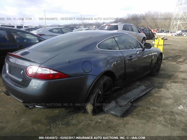

Greetings!
Of course common sense suggests that one should never buy a salvage title vehicle but, I seem to lack common sense at the moment because I am looking at purchasing this 2007 XKR (72k miles). http://https://www.iaai.com/Vehicle?...oadRecent=True

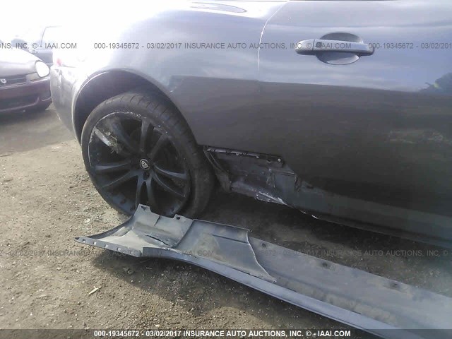

My primary concern stems from the impact to the rocker (sill) and the extent it affects the unibody construction as a whole. Of course with the unibody constructino be comprised primarily of aluminium, I understand that if the entire frame is bent, the car is better left untouched. That said, does anyone have any insight as to whether this damage is fatal to the idea of repairing the car for a reasonable sum?
I have reviewed the X150 repair manual as well as the information avaiable through on online sources and I have priced the known repairs out as follows:
Projected Repair Estimates:
- Used Suspension Bits $1200 - $3200
- Used K Frame Support (Rear Subrrame Assembly) $600
- Used Replacement Wheels $400
- Rocker Panel Cover $700
- Labor $1400
- Others?
Also, I did noticed that the passenger door did not appear to close all the way. While I think this could be chalked up to the door's rubber trim having been displaced by the impact, does anyone think the impact would have been so sever to cause a structural alignment issue with the door?
I intend to inspect this car in person but, the kicker is that to inspect a car at this particular insurance auction, you must either register as a bidder $200 or pay $50 (without registering) to inspect the car. Is it worth an in person inspection?
Thank you for your help!

To me, if you aren't willing to invest $50 to see if the car's needs are within your ability then no, it's not repairable. Auction house should be willing to deduct the $50 from the $200 if you chose to bid. The big question is 'What do you expect to pay for this?'. Decent examples are $20k around my location. I found a rougher one for $10k and am bringing it back to life within my abilities. Firm up your parts 'estimates' (they are too low) and rethink the resurrect scheme vs. buying a good unwrecked example.

It is difficult to make an arm chair opinion based on the photo's. The area of concern is the rear suspension and the suspension mounting points. Also the diff might be a concern. I would have to see the damage to understand what needs to be done but my guess is the insurance guy didn't think the car could be fixed for a reasonable price. Go to youtube and find the video of how the XK is made and it will give you an idea of how the unibody is put together in that area.

And what condition was it in before the accident? What's the service history? Besides the accident damage there may be additional costs just to bring the whole car to spec. I'd stay away from it unless it is almost free and you have good people to work with to get it right.

Let's take all the emotion out of it and purely look at the numbers, and BTW the purchase price link isn't coming up but that really is irrelevant. Even IF all that's needed are those items you've listed that's $5100. With the loss of value for a properly repaired salvaged XKR with that many miles is MAYBE $20'ish so at best there's <$15K value not including your efforts/time/risk. This does not include what's not known - needed paint work, assuming everything was fine prior to the accident, you left out tires which run $1000 so there's very little there even if it was a great car prior and you were able to buy it below $10K... or even $5K. To paint a panel alone runs >$1K, whole car over $5K. Now add in that some insurance companies won't cover them, many banks won't loan on them, and how difficult it is if/when you try to sell it, these cars are tough enough to sell in great shape with no terrible history. The seller would LOVE to unload this ASAP. I'm very mechanically incline and I honestly wouldn't get involved if that car was free, there are better deals with far less risk. You're estimating at a "best case scenario" and even then it doesn't make sense let alone real world costs. No clue where you came up with a labor charge of $1400 unless it's a friend that owes you something, most charge >$100/hr and there's a WHOLE lot more that 14 hours involved in repairs there, several times more than 14 hours... with no other parts needed you're probably looking @40 hours at least without hidden stuff
The only way that car makes sense would be as a parts car or a dedicated track car but its a clear loser if your desire to make it right and ever think about selling it
