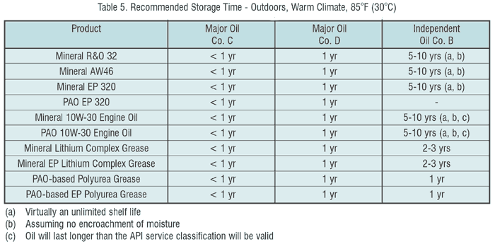

Interesting question. IMHO, figuring 1Kmi per year, fluids only:
Oil: environmental temp changes cause condensation with steadily increasing water content. Boiled off in normal use, accumulates in low use until driven. Yearly changes.
Brake fluid: Hygroscopic. Probably low accumulation in low use, but change every 3-4 years. My guess is highest moisture ingress occurs around the piston seals on the calipers. I'd change regularly in humid environments.
ATF In steering and tranny: Fairly well sealed systems, mostly degraded by hard use and high temps. Low use probably means changing every five-seven years.
Coolant: varies a lot by application. Not aware of interaction between Jag's coolant and engine components. But I'd change it, just 'cause I'm that guy, every 4-5 years of low use.
Differential: Every time I've changed differential oil on my cars, it's been pristine. So, IMHO, 7+ years.
Synthetic fluids seem to be more stable over the long term, since they're likely to have less dino leftovers in them (paraffins, etc).
Of course, on any new-to-me car, I change all the fluids unless fully documented changes are available to me.
"Fluids are cheap, metal is expensive"
IMHO, YMMV
Note the huge difference between what the major oil sellers say and the independent/consultants say. This is oil in storage, of course.
Article: https://www.machinerylubrication.com...t-storage-life
Note big difference between majors and others
Note the big difference between what major oil companies say and what the independent companies say.
